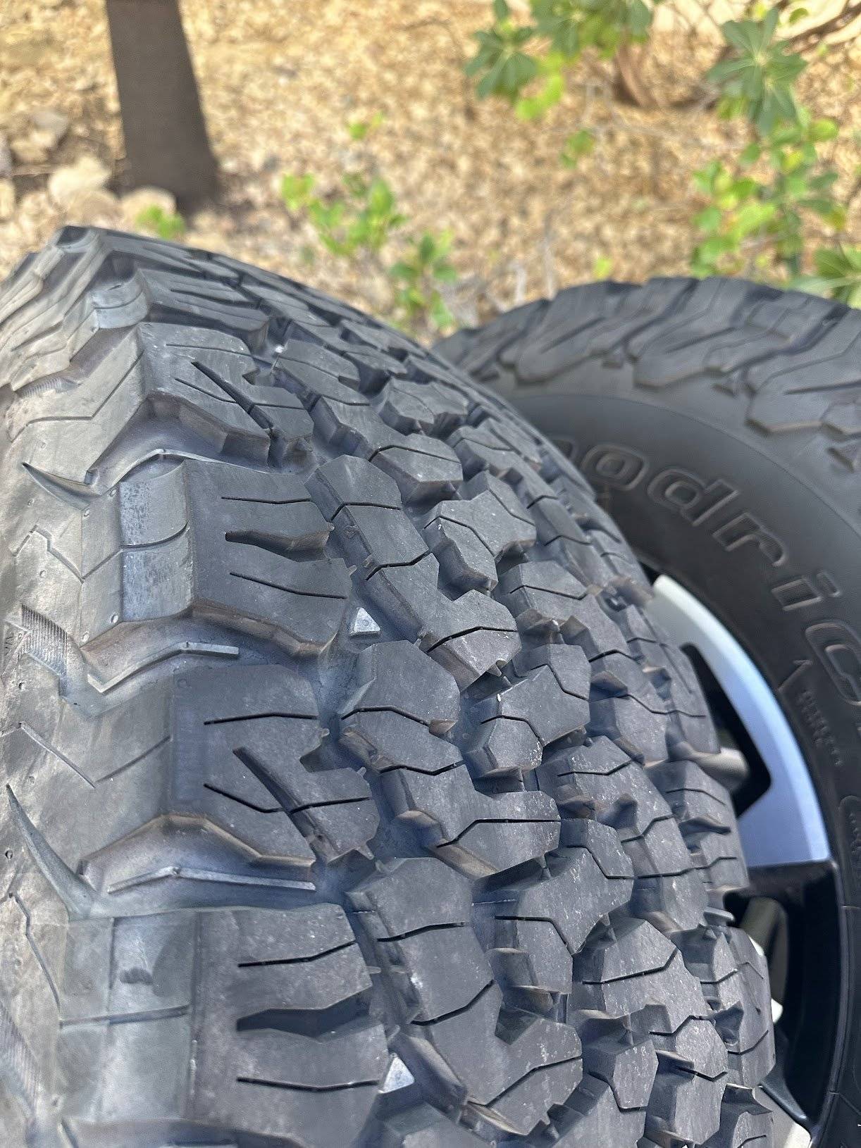

Im looking to possibly drive 5ish hours tomorrow to look at these. its said they were less than 100 miles. Looks decent to me but im new to this so figured i ask for extra eyes.
codes on the tires are 2023/2123

They look like they have at least a few hundred miles. They must be listed for a really good price to drive 5 hours for. That’s like 300 miles.
Most takes offs have the TPMS removed and put in their new setup. So make sure you are aware of that as an added expense. If they have sensors that’s a plus.

They look fairly new to me. I see they're BF Goodrich... What's the model and tire size?
The original tread depth should tell you a lot about how worn they are. ;)

Date codes are good. 20th and 21st week of 2023.
Price and your fuel to go get will be a bit over $550 for $1300 worth of tires. And yeah they look almost new. You will still have to pay to mount and the new TPMS sensors.

They’re off a ā€˜24, so you’ve got that going for you. Unless someone has really gone out of their way to deceive, you’re probably okay. As @The Last Cowboy said, be sure TPMS is part of your equation. Not really a deal breaker if they’ve been removed, but you’ll need to figure it into the total cost. Good luck, and safe travels! ?

Those tires still show the nubs on the outside of the tread. They're new enough not to squabble over 100 vs x00.
TPMS sensors won't work in your 2018 if those tires/wheels are off of 2024.

When you go to pickup, do look over each tire very very closely. Look for plugs.
Recently, a local guy had 5, 2023 takeoffs for sale on FB Market Place.... he advertised they had 10,000 mi. and unused spare .....and that all 5 tires and Rubi rims were mint. I asked twice, if any tires were plugged and he said no both times.
Long story short, I went to pick up and one was plugged. It was pretty obvious the guy tried to hide the plug by coloring/covering the plug with dark tire shine. Frigging lying 45+-yo scumbag thought he could take advantage of some/ this old 75 yo.. Wrong!
Anyway, do look over the tires closely. Always best to do the look over in daylight..

?… they look a little tired!
as others have said, as long as theyre not plugged and are more or less about the same depth (if youre matching them up for front or back replacements), they should be good to spin. ??
Oh, also look for sidewall damage, thats the real back breaker (cuts, slices, bubbles, major stuff like that)

I think I spy the 4xE blue badging in the center of the rim. Idk if it being a 4xE rim is a compatibility concern though.
