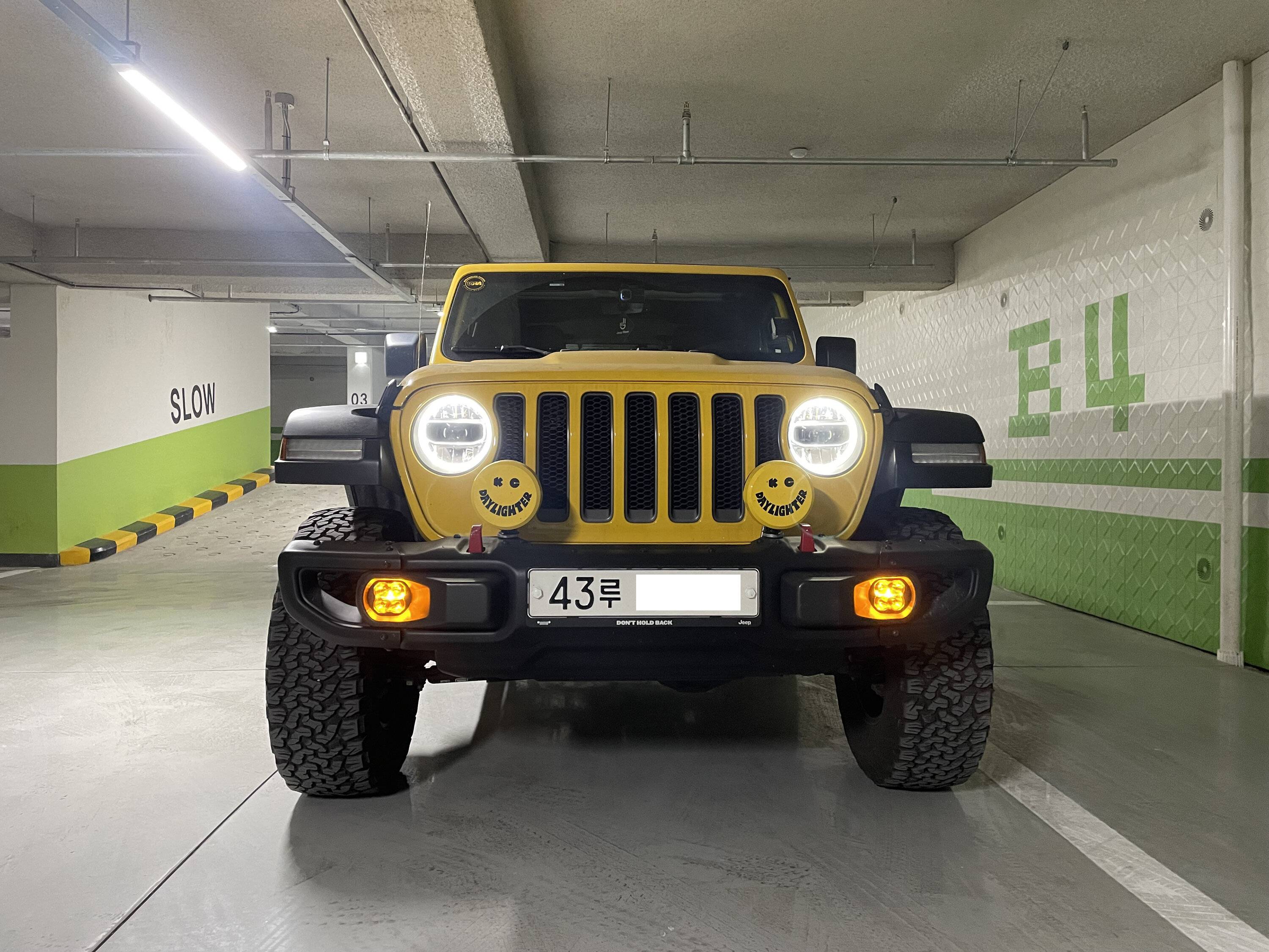

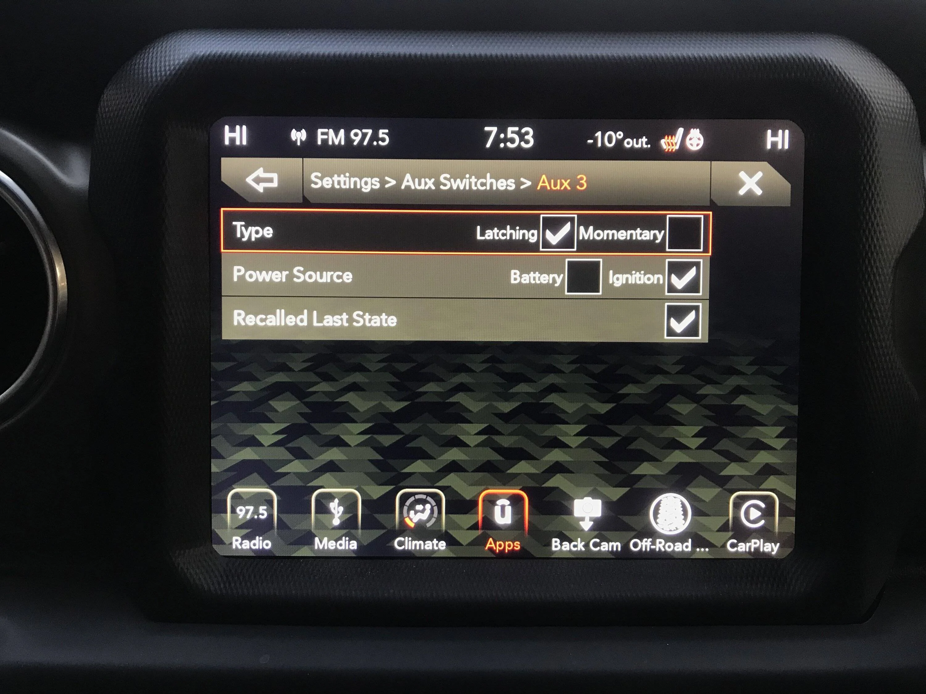

I connected the backlight wiring of the SS3 LED POD to AUX 3
After doing this, I selected the Power Source setting as Ignition
This is the same way as DRL and I love the backlight of Diode Dynamics
Oh nice, so you went with the fogs and used the original OEM harness and vehicle fog switch for them, but just the backlight is wired to the AUX switches. I like that. Hadn't thought about doing it like that. Thanks for the info!
