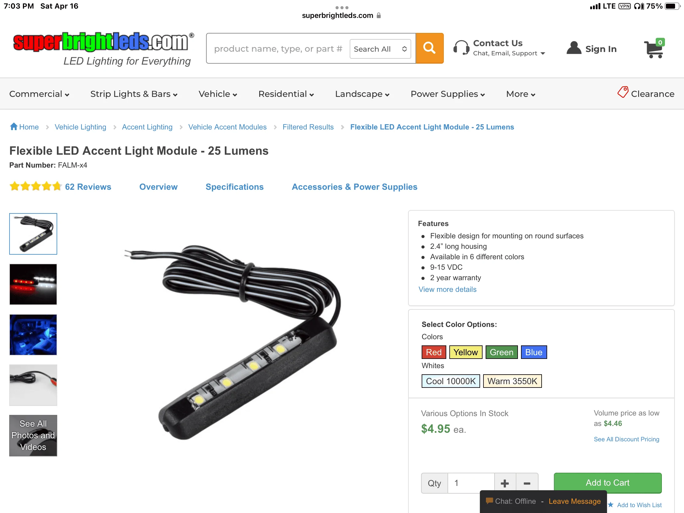

Ordered these, multiple color options FYI.
Jeep Wrangler JL Dimmable footwell light red replacement recs? 249AA006-8EB4-45D7-950D-4F6F651A10F5

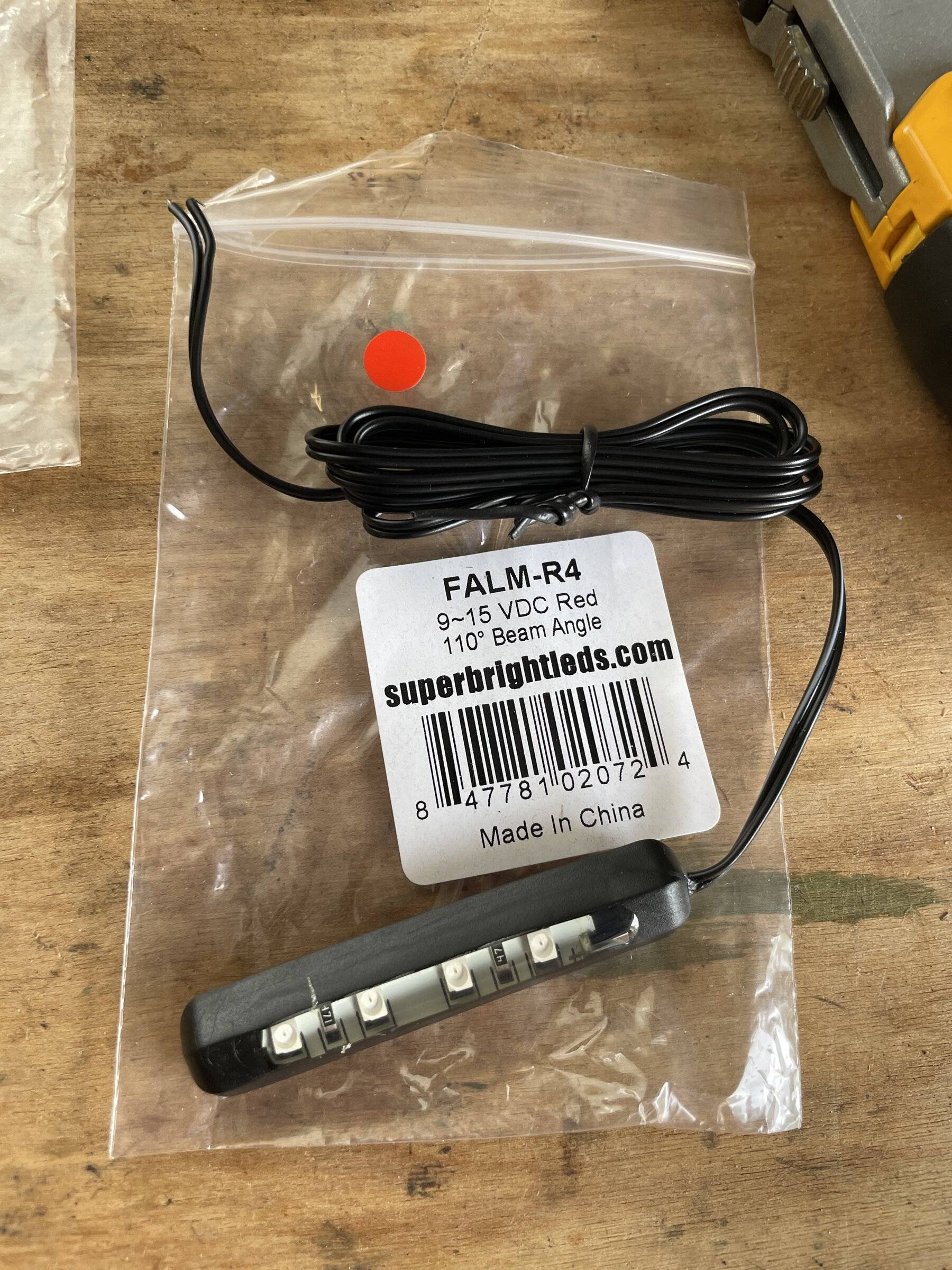

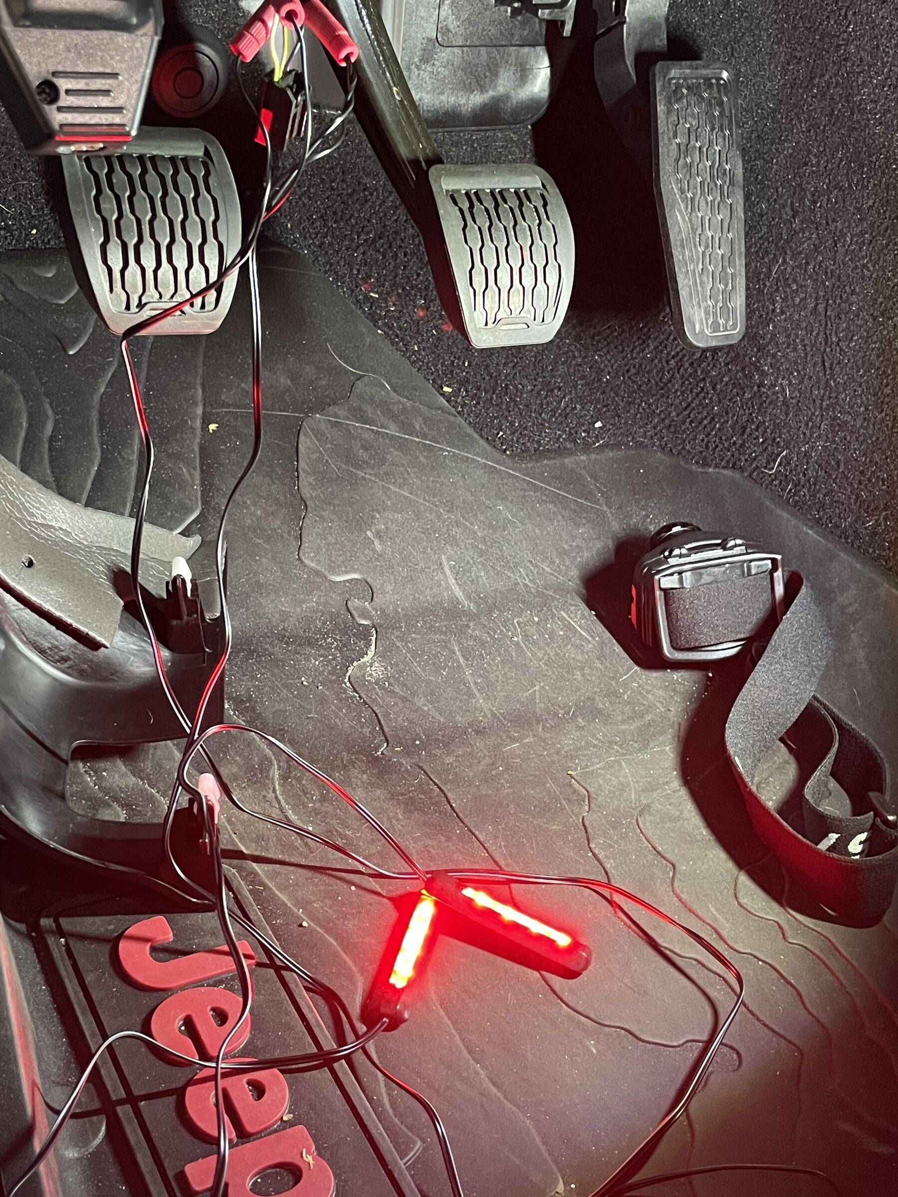

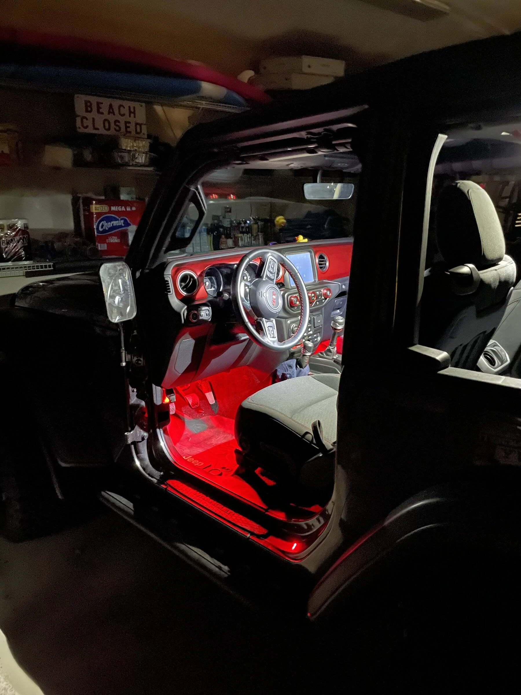

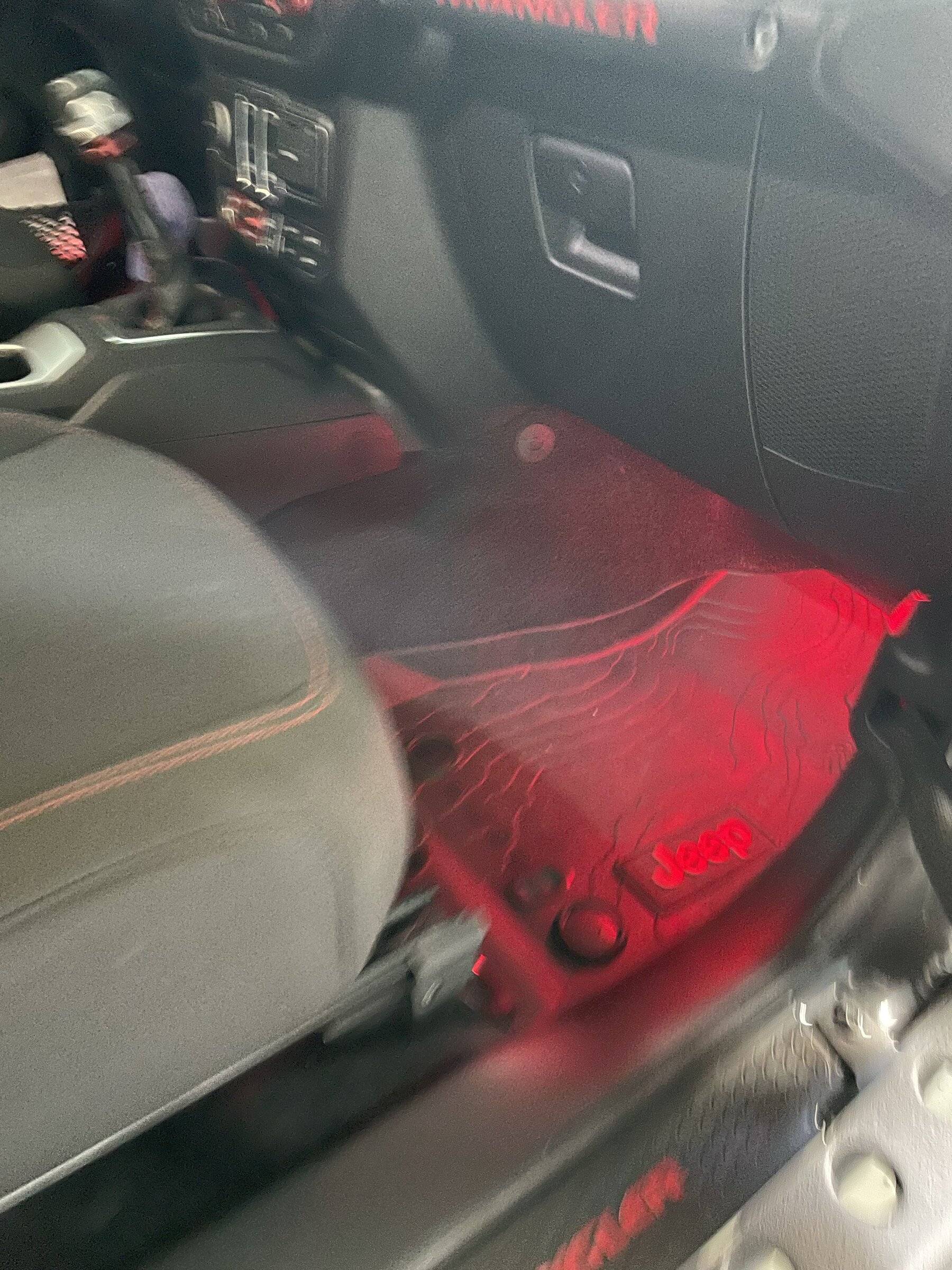

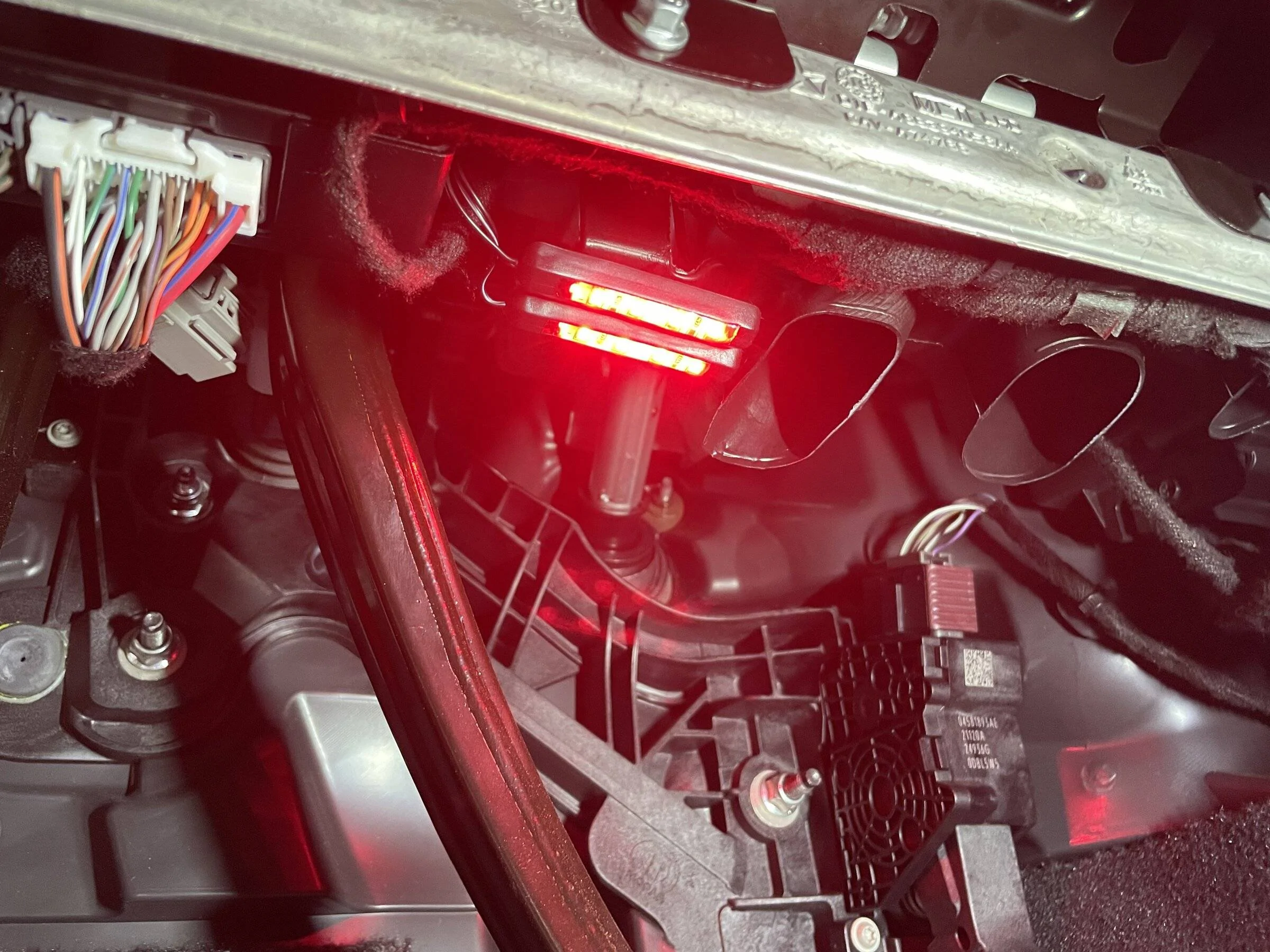

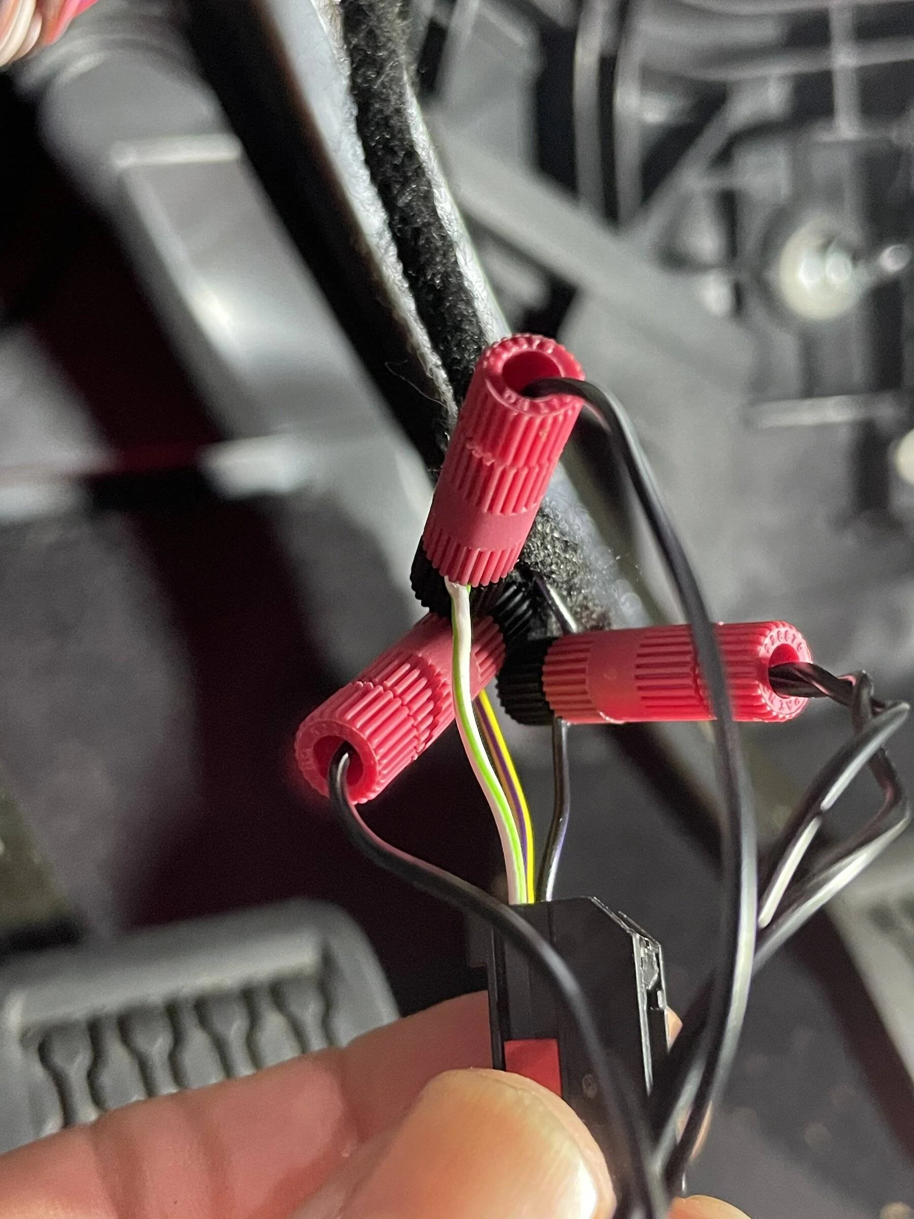

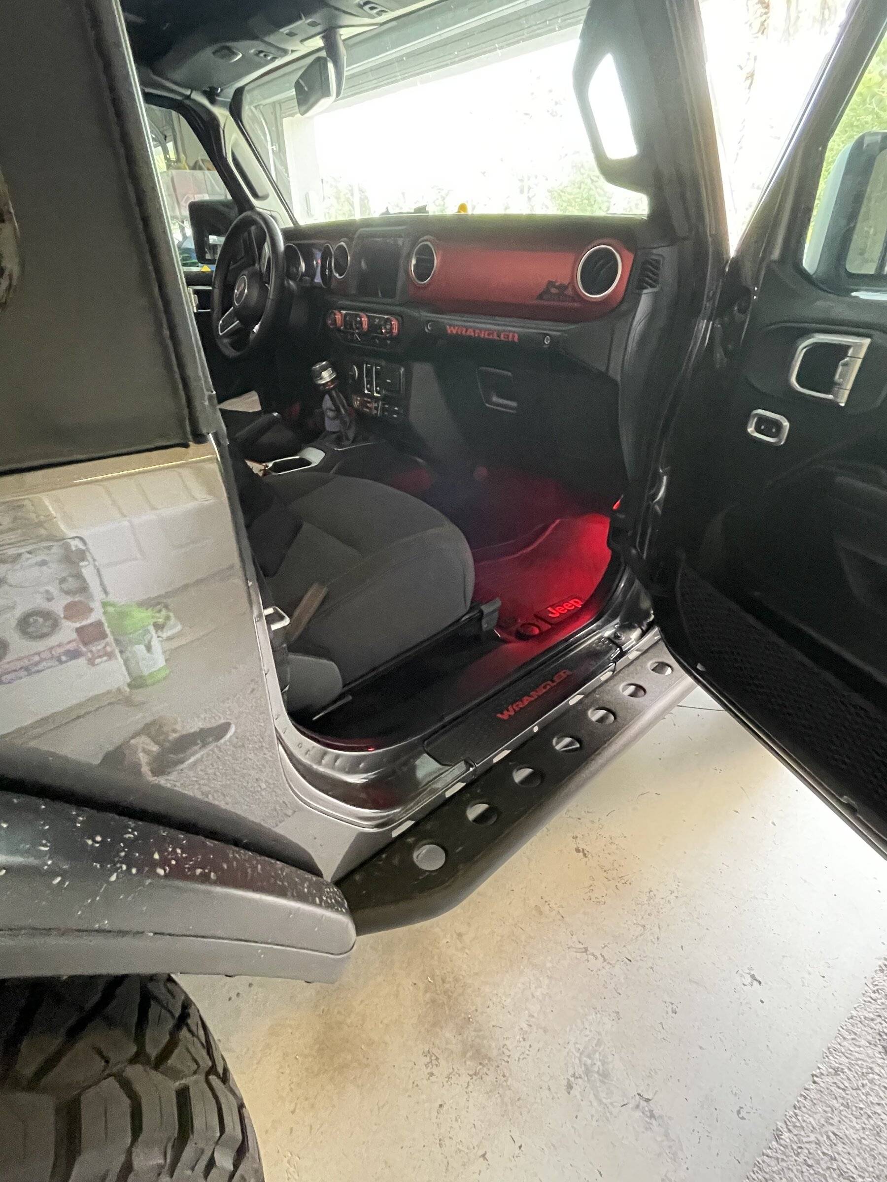

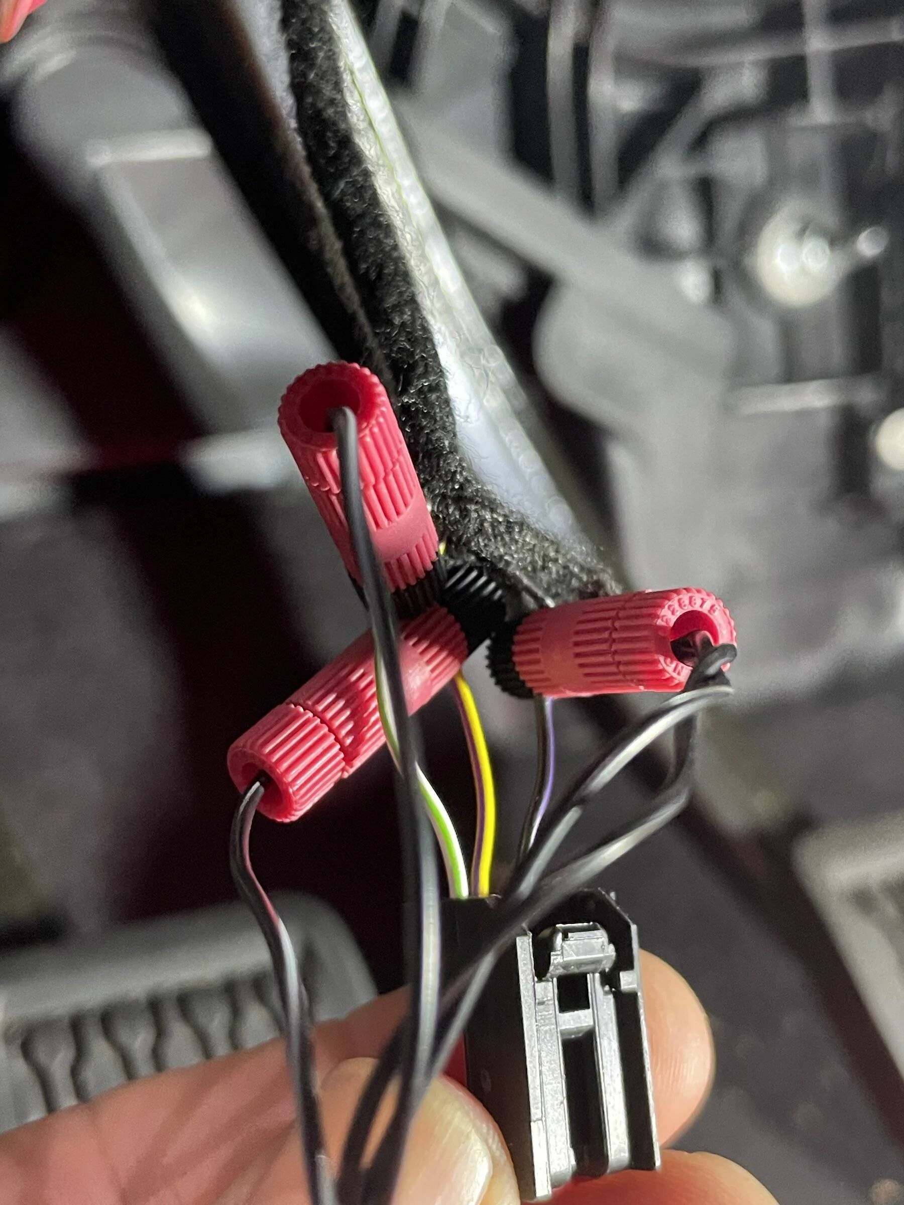

Project complete: Disconnected the stock white led footwell light plug and installed a pair of red leds on each side. One is connected to the door/dome wire and the other is connected to the dimmable flood. Pretty simple install, got the leds from superbrightleds.com (they have other color options). Put the ground wires together in one connection. Only trick is the led wires aren’t labeled +/- so use a 9v battery to see which wire is which. LEDs work one way only so polarity matters.
Jeep Wrangler JL Dimmable footwell light red replacement recs? 6F23DB66-3D60-4F9E-AD85-738D3335AD64
