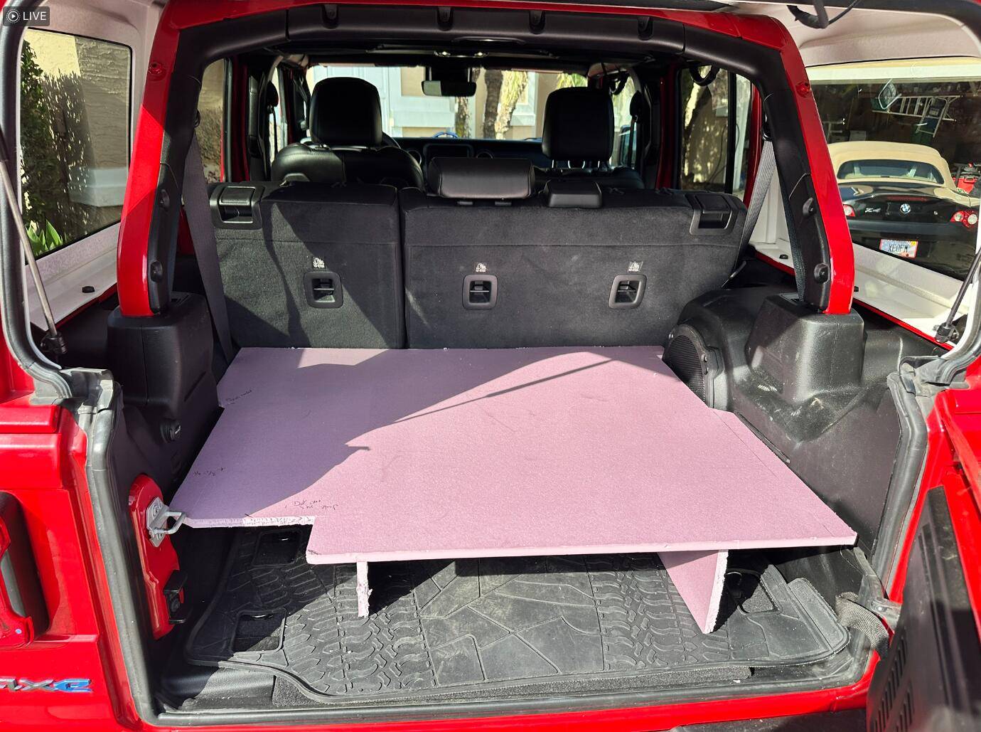

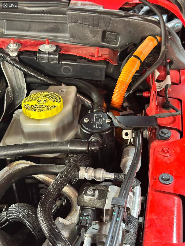

Today I decided to take on some small tasks. I mocked up the sleeping platform and installed the J&L Oil catch can. Catch can was simple and took only 20 minutes. You can hardly even tell its there!

Lastly, I'll begin building out the sleeping platform with 3/4" plywood and hope to have that finished up by next weekend.

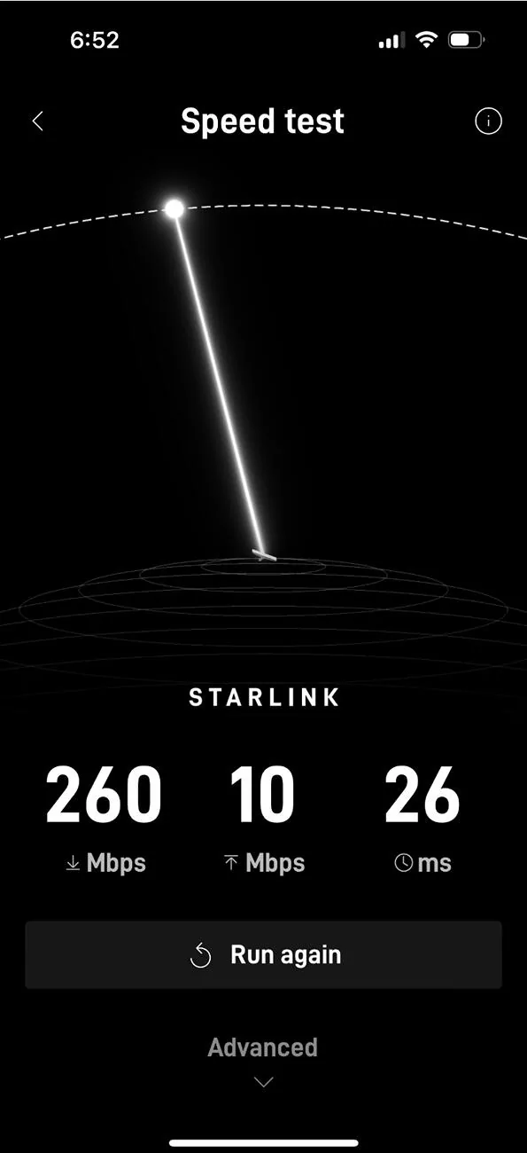

Hey there - Currently planning on doing a Star link Mini but haven't done anything yet to figure this out. I'll keep you posted as I progress.

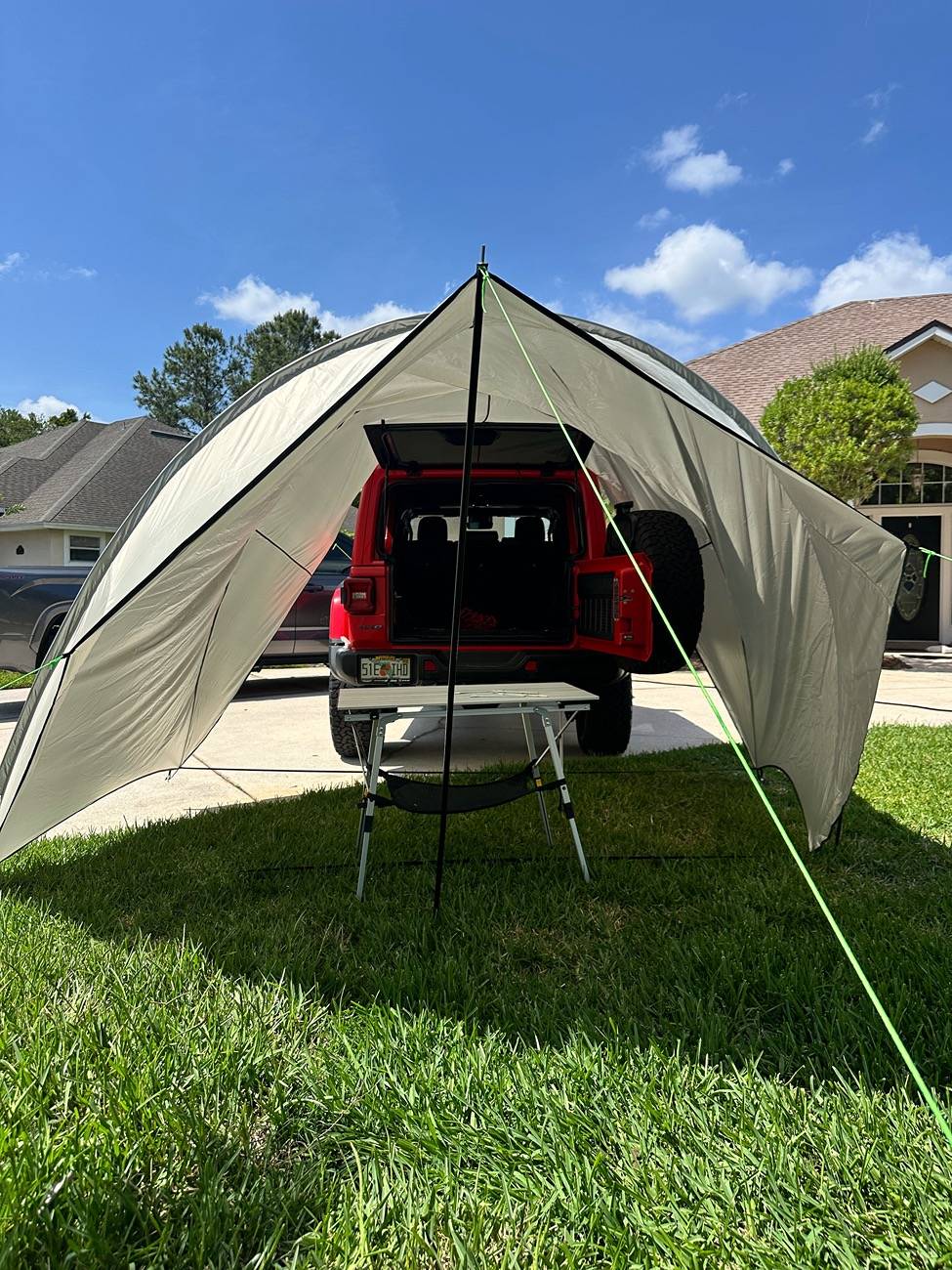

Got a few more things done. Winch, Yeti HD tie rod assembly and track bar installed. Also set up the awning to test it out. Headed up to Carolina to do shakedown.

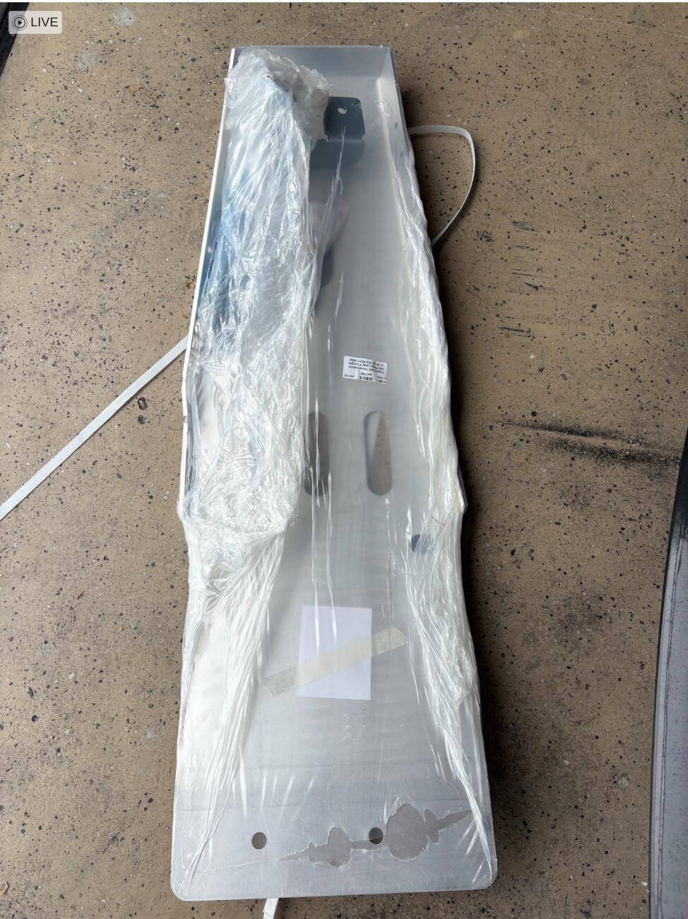

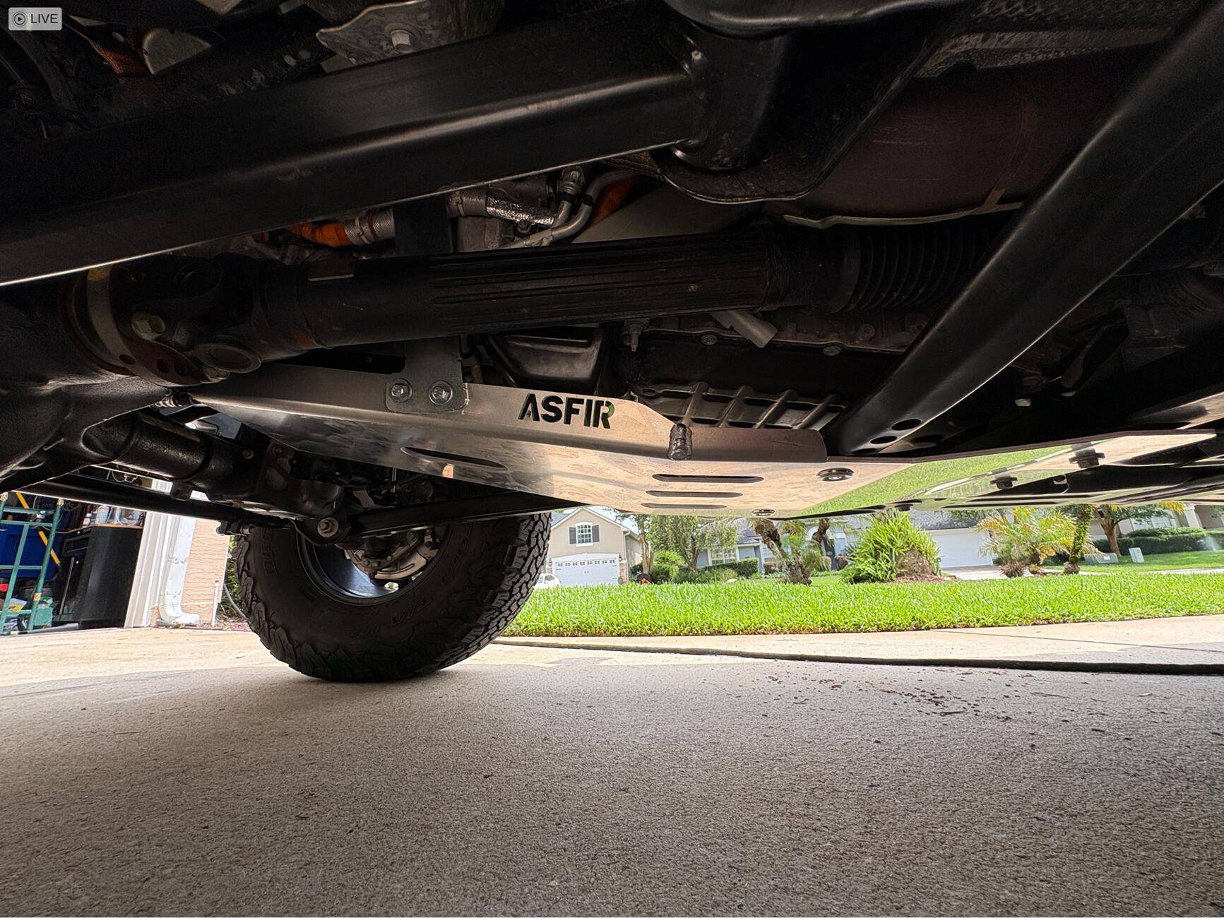

Added the Asfir skidplate. Fantastic quality and easy install. Highly recommend to get this to protect your oil pan if you are going off-roading!

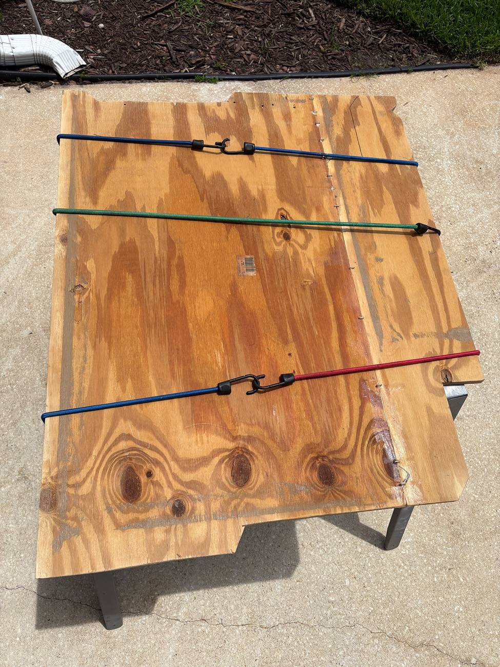

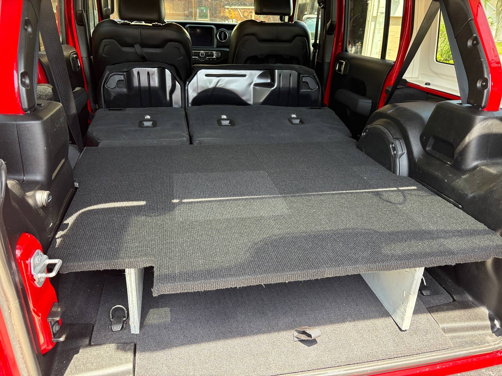

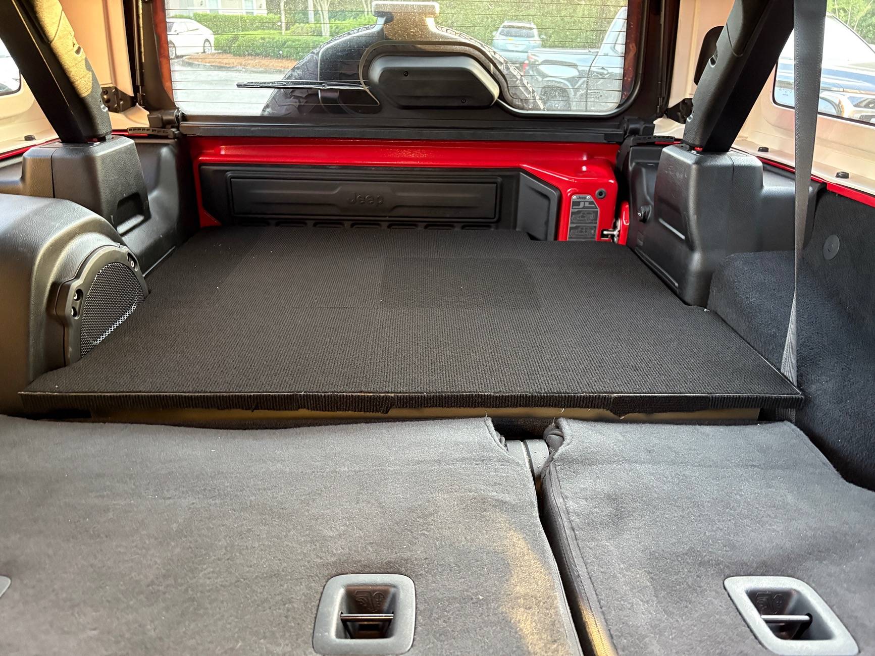

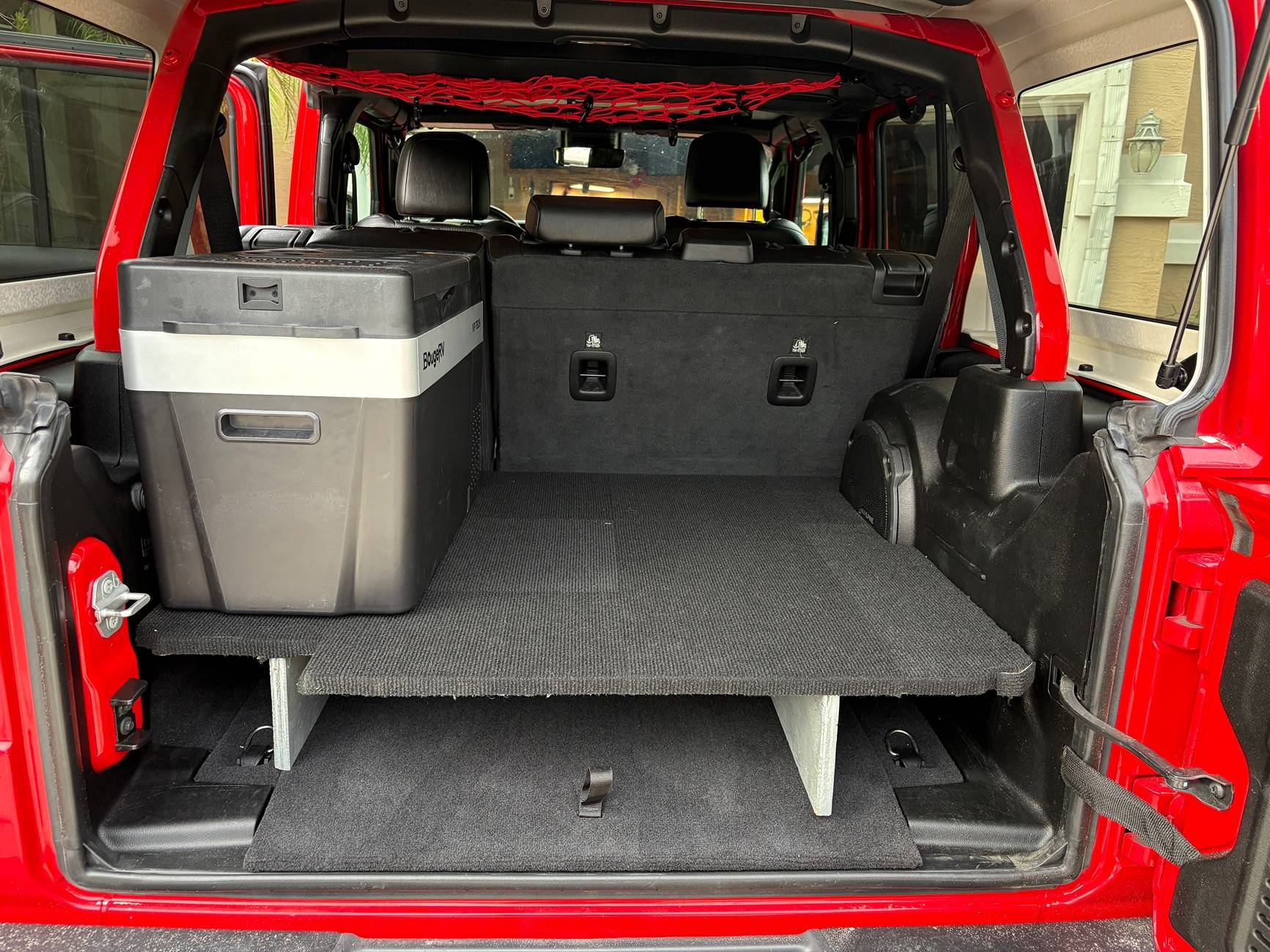

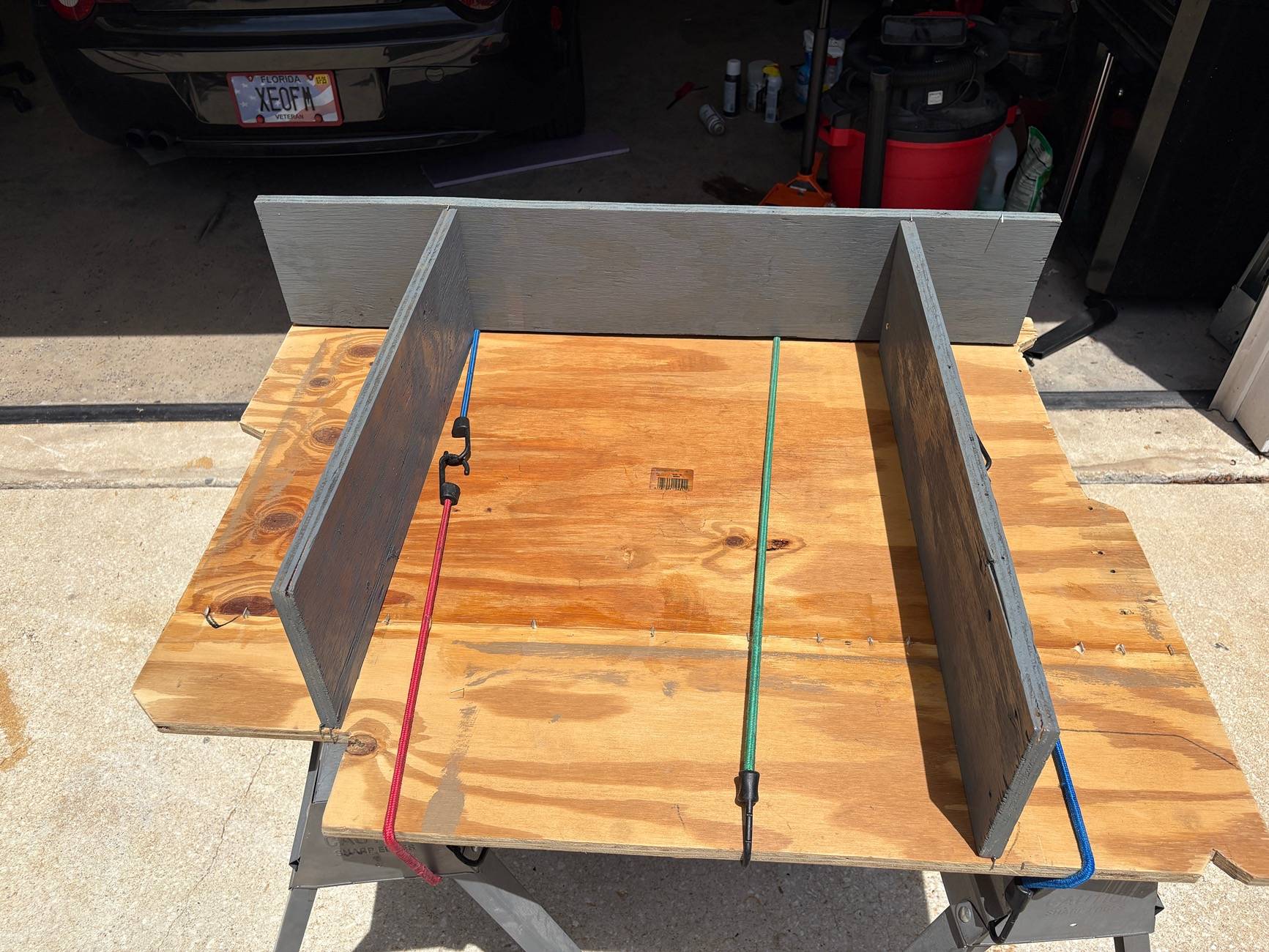

Finished the platform build. Had some old plywood laying around so just pieced it together quickly. It actually turned out pretty good. Originally made it too tall so I had to cut it down 1.5 inches.

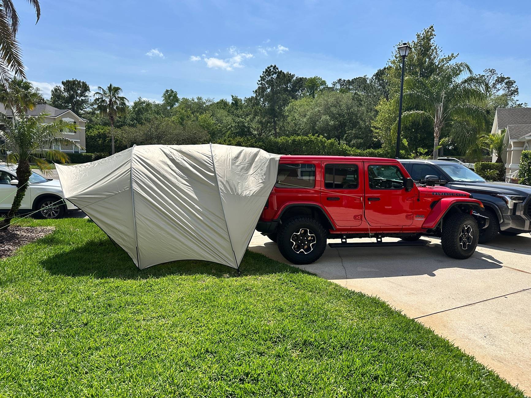

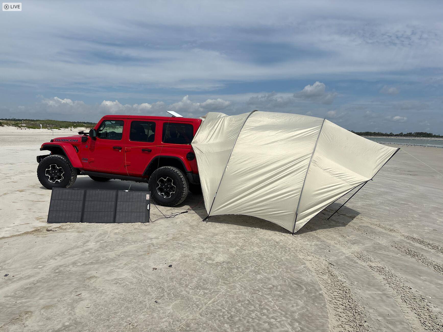

Finally got a chance to do a shakedown at Hugenot Park and Hanna Park. A couple of observations:
  1. Starlink worked great and had a low power draw (relatively speaking).
  2. Solar panels made 115 kwh during sunny day versus my peak draw which was about 85kwh with a laptop, second monitor, refrigerator, starlkink mini, and fan.
  3. Sleeping with my head towards the front seat was uncomfortable - head towards the tailgate allowed me to stretch out better.
  4. The awning held up well in high wind and a thunderstorm with rain.
  5. Very glad I purchased screens for the door windows for airflow while sleeping.
  6. BougeRV refrigerator was spectacular. Very low power draw which had no adverse affect on the Jeep 12v.
  7. Ecoflow River 2 Pro was more than sufficient for my needs.
Got a few minor tweaks to do to dial in the comfort a bit more and optimize the drawer system but other than that I am good to go. Heading out for the Badlands on June 14th and expecting to get back around July 5th.
