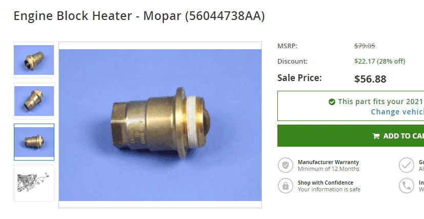

- looked at Allmoparparts.com . Got what I believe is the part number for mine. I believe this is the correct one, if you are going to order one PM and I'll send you my VIN to compare to. But That is just assuming 2022 would work with 2021 engine block heater Mopar PN: 68357705AC . I don't see why they wouldn't be compatible, but you never know.

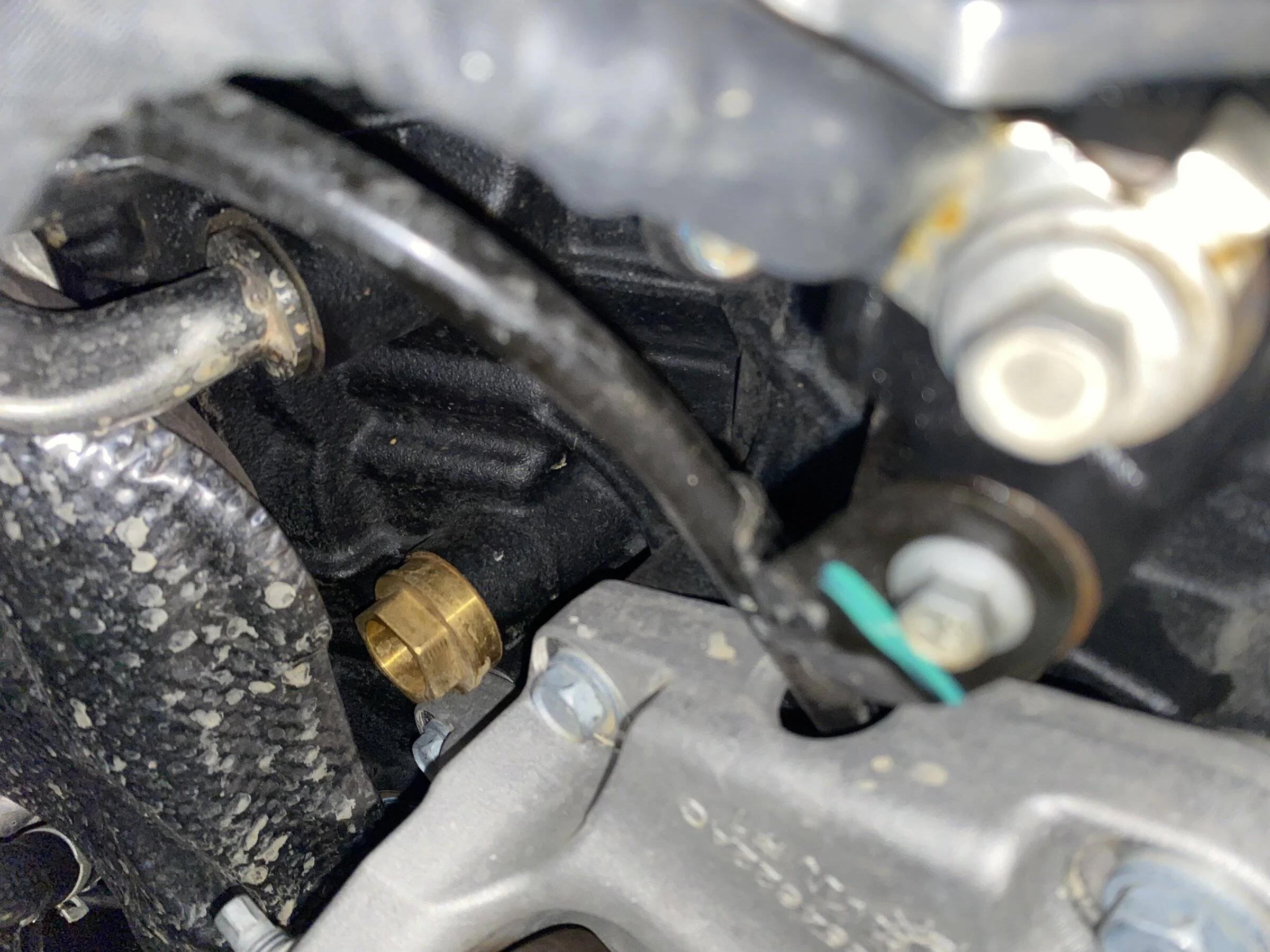

If you're looking to see if you have the block heater I think the best angle to check is from underneath. This is what it looks like, my brass fitting (pic above) had no threads so I suspect it has to be removed to install the heater.
2007-2022 Mopar Engine Block Heater 56044738AA | Mopar Parts (allmoparparts.com)
Does anyone know if I will be needing both of these parts to install an engine block heater on my 2021 3.0 EcoDiesel which doesn't have this option from the factory?

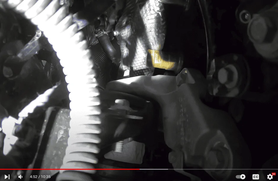

The best part is I found out it is a pocket design, so no messy coolant to deal with on the install. I would just take the one off my 21 that I'm selling to Carvana, theres only one bolt, but it looks like its buried, hard to get to.
