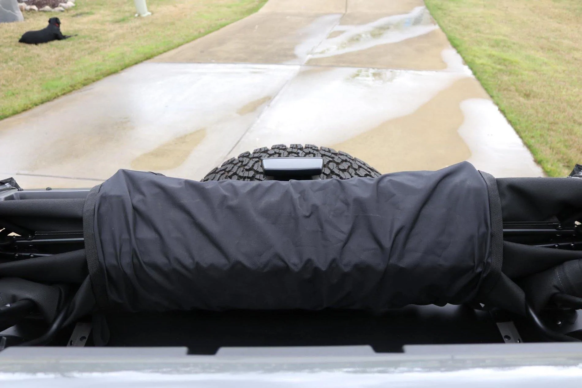

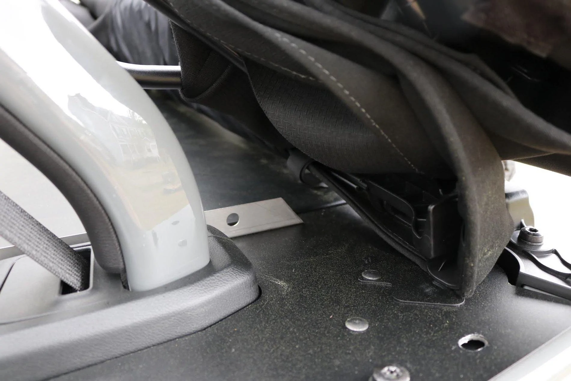

I want to provide an update regarding being able to lock down the soft top while using the Slipstream,
I purchased the Slipstream a few months ago for my 2019 JLUR. After installing the soft top I noticed the top would not lock down. Upon noticing this, I contact Alan at Diabolical to determine if there was a work around. Over the course of several weeks, I've been emailing and talking with Alan on a resolution.
He is getting closer to putting some things into production which will be a 'work around' for not being able to lock down the soft top. First, the tie down rails will be shortened to approximately 23" so when the soft top is folded, there will be no contact between the soft top and the tie down rails. With the current tie down rails, the soft top sits directly on these two thin pieces of metal which in time, will wear through the fabric. Shortening the rails will resolve this issue and allow the top to sit fully on the top of the Slipstream, and not on the tie down rails.
Second, Diabolical will be producing a soft top cover that will wrap around the folded soft top and hold it in a more compacted fashion, allowing better visibility out the back and keeping the fabric from flapping in the wind. The cover will be able to be secured to the tie down rails thereby 'locking' the soft top in position.
From my discussions with Alan, the shortened tie down rails will be available to current customers at no charge. The soft top cover will be an additional purchase.
Pictures attached of the prototype pieces.
-You can see the end of the tie down rail and how it allows sufficient room for the soft top to lay flush on the Slipstream.
-Soft top cover. Work in progress with some adjustments needed but Diabolical is working with their suppliers to finalize.
Jeep Wrangler JL Diabolical Slipstream install - recent experiences? Soft top cover
Jeep Wrangler JL Diabolical Slipstream install - recent experiences? Tie Down Rails
From my discussions with Alan, these two updates will be included at no charge for current Slipstream owners.
This doesn't solve the issue of the soft top corners rubbing on the top of the slipstream as seem in the last picture. Would you mind posting the link to the other thread?
I really don't think there will be an issue with the soft top rubbing on the top of the slipstream. The same issue would occur while not using a Slipstream and having the soft top rest in the recesses. Even though it is locked down in that case, there is still enough play for it to bounce a little. By shortening the tie down rails, the soft top rests flat against the width of the Slipstream and does not contact the sharper/narrower tie down rails. That was my main issue with the current set up. You will also be able to bungee or secure the soft top to the tie down rails to limit any movement.
