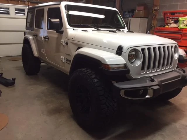

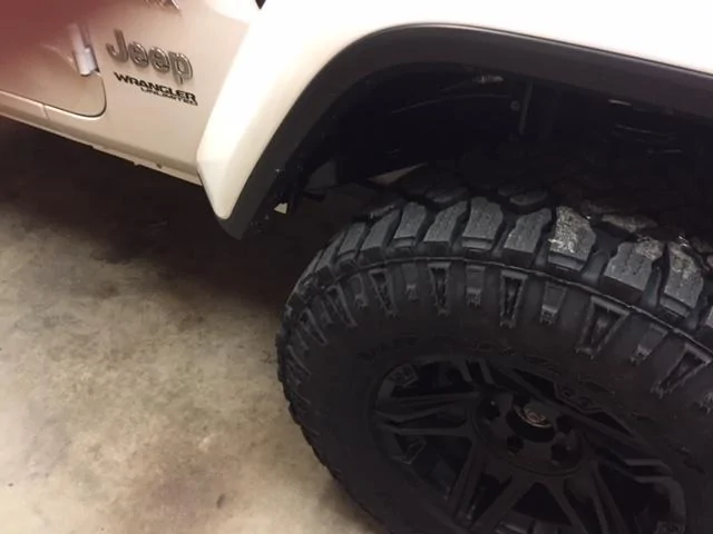

Excellent setup, wheel backspacing pulls the tire in the ideal offset location slightly beyond the fenders.I went with American Outlaw wheels -10 offset so the wheels do not sit too far out. 35x12.5 Duratracs.
If you want more offset go with -15 that will put the wheel/tire combo 5mm more out away from the axle.

99.9% of all wheels can accommodate 14mm lugs, it did take DTD a few tries to get the exact lug nut style I wanted but their customer service is the best in the business.Excellent setup, wheel backspacing pulls the tire in the ideal offset location slightly beyond the fenders.
