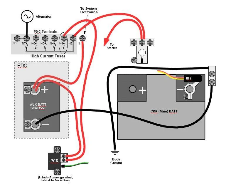

If the negative was disconnected on the main battery is the theory that you've been running the Jeep on the Aux battery this whole time? Is that even possible given how small it is?
If that were the case I'd imagine the aux gets charged back up once the connection is restored, shouldn't be any long-term effects.
Curious; were there any black marks near the negative cable where maybe it had shorted to the body?

I am confused. From the diagram, the Aux battery is connected to the negative post of the main battery. The main cable is connected to the body. If the main negative cable is disconnected, shouldn't the Aux battery be disconnected also? Is there another ground for the Aux?
