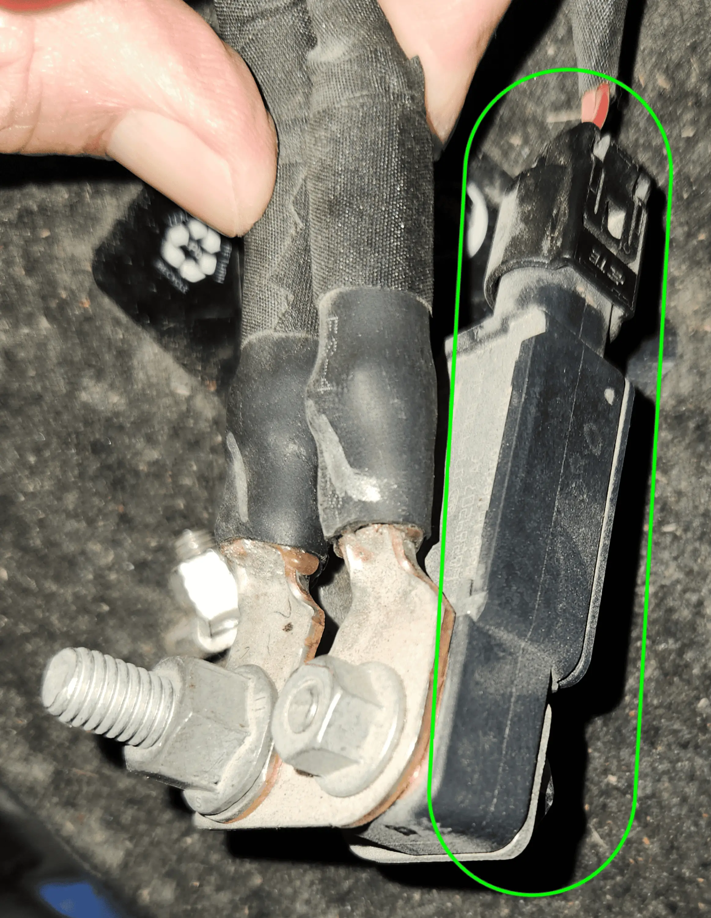

On a side note, anybody know what this thing is? Assume I need to leave it attached when I disconnect the AUX negative cable.

That's your IBS (Intelligent Battery Sensor)

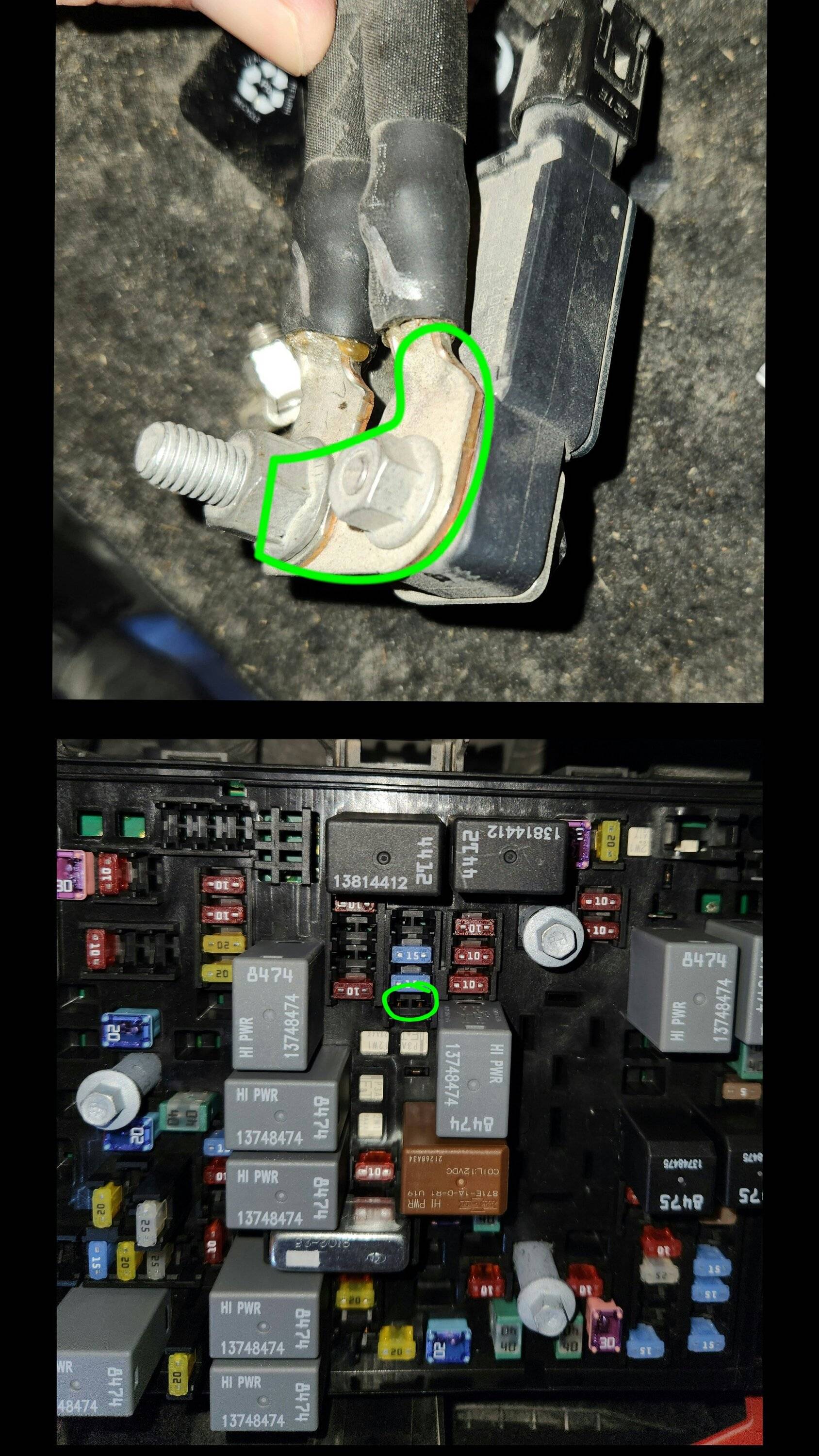

OK, Fuse pulled, AUX negative cable unhooked and tied back.
Green indicates the AUX cable on my '22 JLUSS and the fuse I pulled.
Note of interest which I had read but ignored, pulling the fuse before disconnecting the cable is required. I didn't do it that way the first time and got the dash error message and yellow A warning.

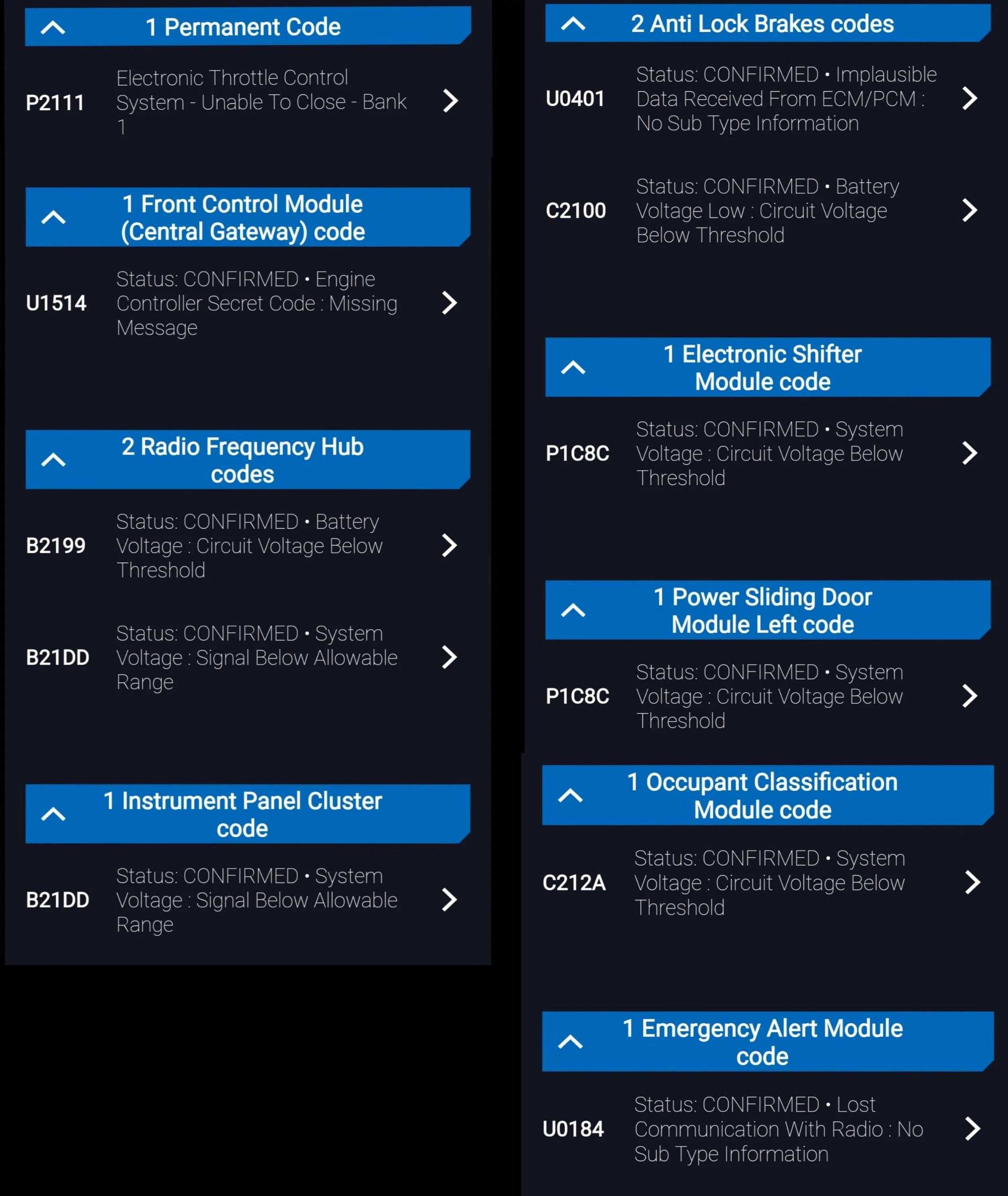

Also, just for reference, the check engine light was flashing after I got her all charged up. I pulled the codes with my BlueDriver. All the codes were thrown due to the dead battery issue as I had literally just checked for codes last week and it came up clean.
Was able to reset them all except the "permanent" one that BlueDriver claims will resolve itself when I drive it, if it was indeed a glitch.
