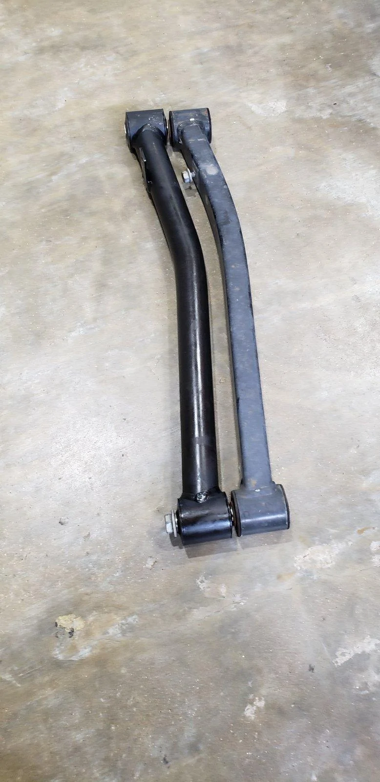

I just finished installing the Daystar 2"lift. It is a spacer lift, but what sets it apart from the others is that it even includes a set of front lower control arms. Other than that it includes the same kit as most of the competition. 2" spacers front and back, extended bump stops, longer sway bar links, and shock extensions. I had a little bit of trouble with the driver front shock extension, but that was because I bashed the factory mount on a rock. I want to eventually change these out for the Metalcloak extensions, but that is a ways away. I installed it myself without a lift in around 5 hours, taking some liberal breaks. Oh, and the best part is that I was able to get it for only 270 on Amazon, which is a killer price.

Congratulations on getting your new lift on. The Daystar lifts offer quite a bit of value for the money. Two things to be aware of:
1. The Daystar control arm bushings wear quickly. Mine lasted about 5,000 miles before the metal sleeves started moving around inside the polyurethane.
2. The swaybar link bolts/nuts loosen. Use locktite on them.
Otherwise, it’s a great value, and you can do quite a lot with JL platform Jeeps with just a 2ā€ budget lift. Enjoy!
