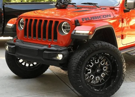

I wish to keep FENDERS, HALOS and FOG LIGHTS always on in DRL (with Daylight/ not only at night when headlights auto turn on) Any idea?
Tried with Tazer (@joe@zauto) but no way, fenders or fog lights, can't turn both.
