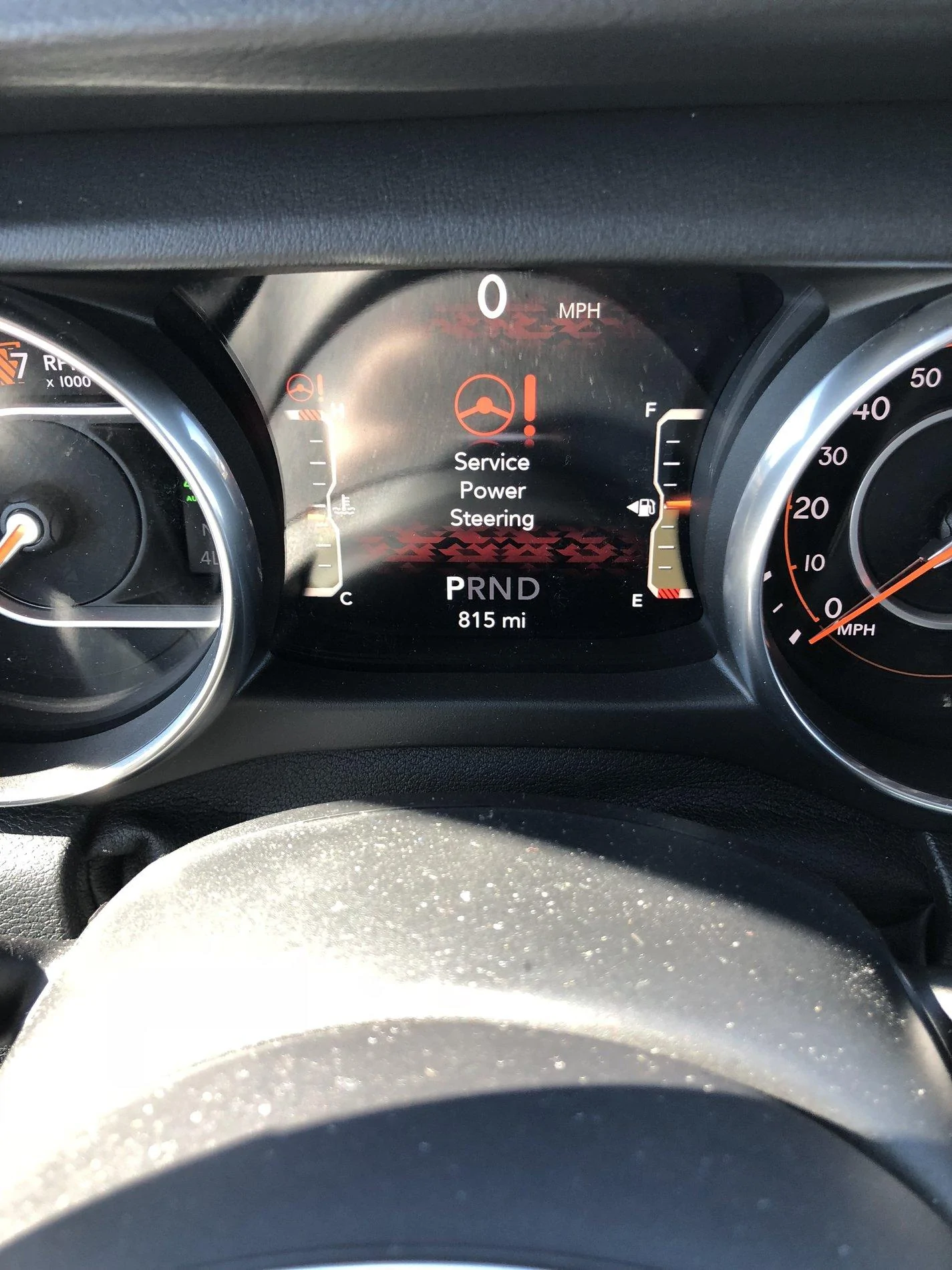

I was at a stop light and my Jeep turned off (auto stop function) and didn’t start back up. I received an error on the screen that said “service power steering”. A tow truck had to come pick it up. We also had to manually engage neutral since the shifter would not move to get it loaded on the flatbed. Hopefully this isn’t a huge deal. What a nightmare

Wait what the shifter locked up also? How does a mechanical shifter get locked up from a power steering error?

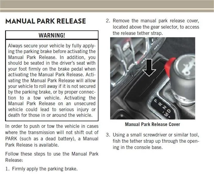

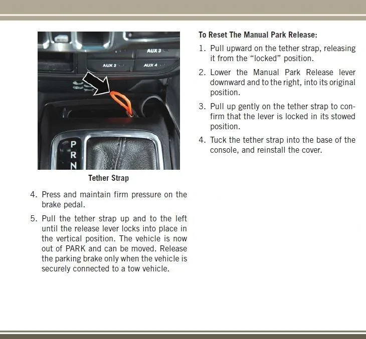

Sounds like it may have been a battery/power related issue. IF battery goes dead, a bad ground, etc. and then you cannot get out of park and you need to use the tether release as shown in pics below to release/move shift lever out of P.
I hope the issue is minor. Who knows. The dealer just called me and the Jeep won’t even boot up, the dealer said their reader can’t even read the Wranger.
You’re right on the teather, someone needs to stay in the vehicle to keep it pulled up though
