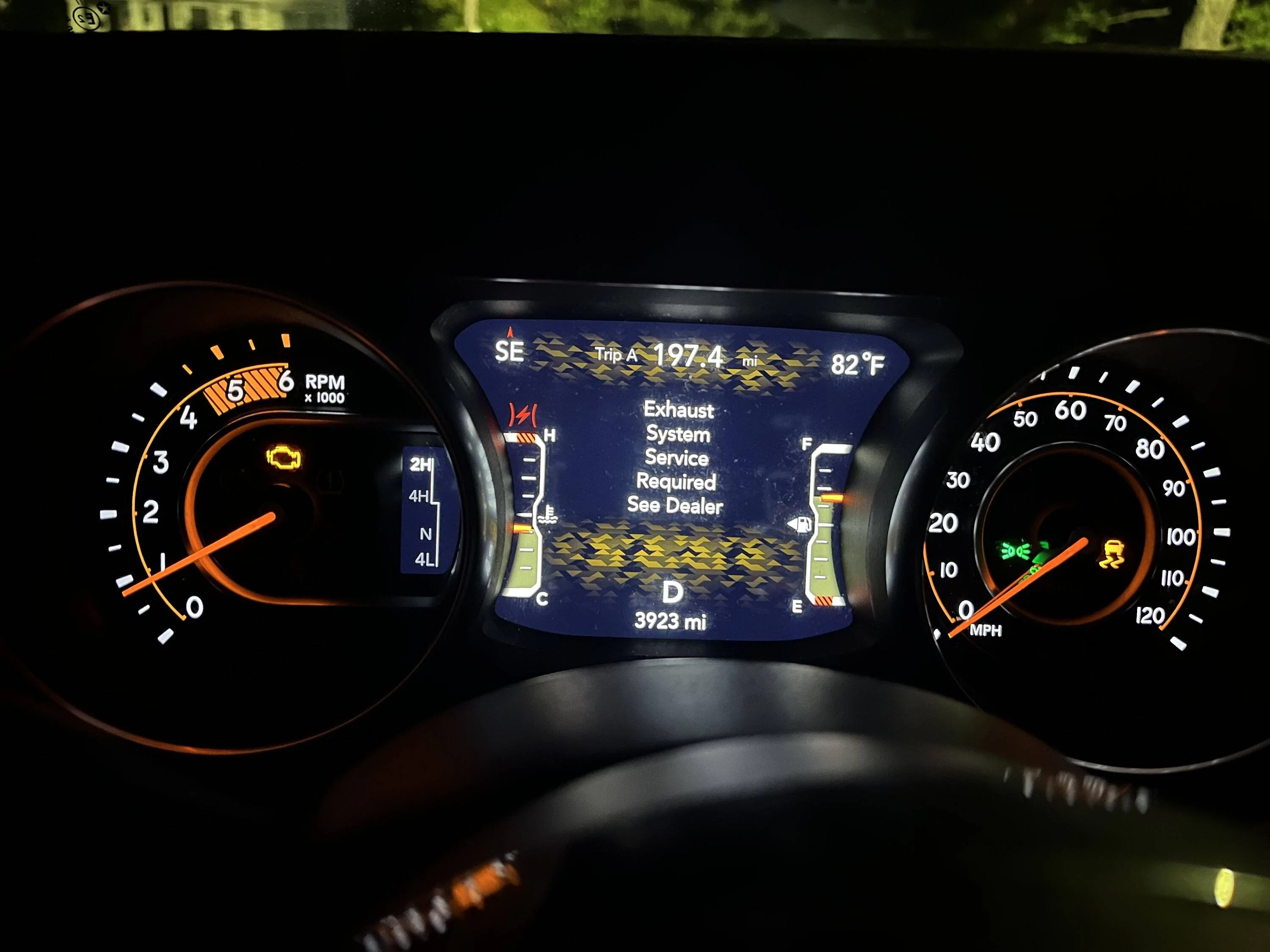

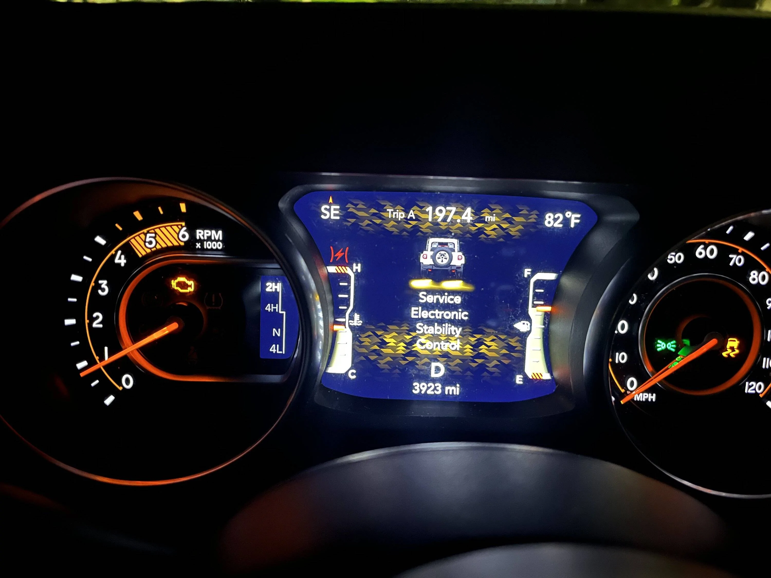

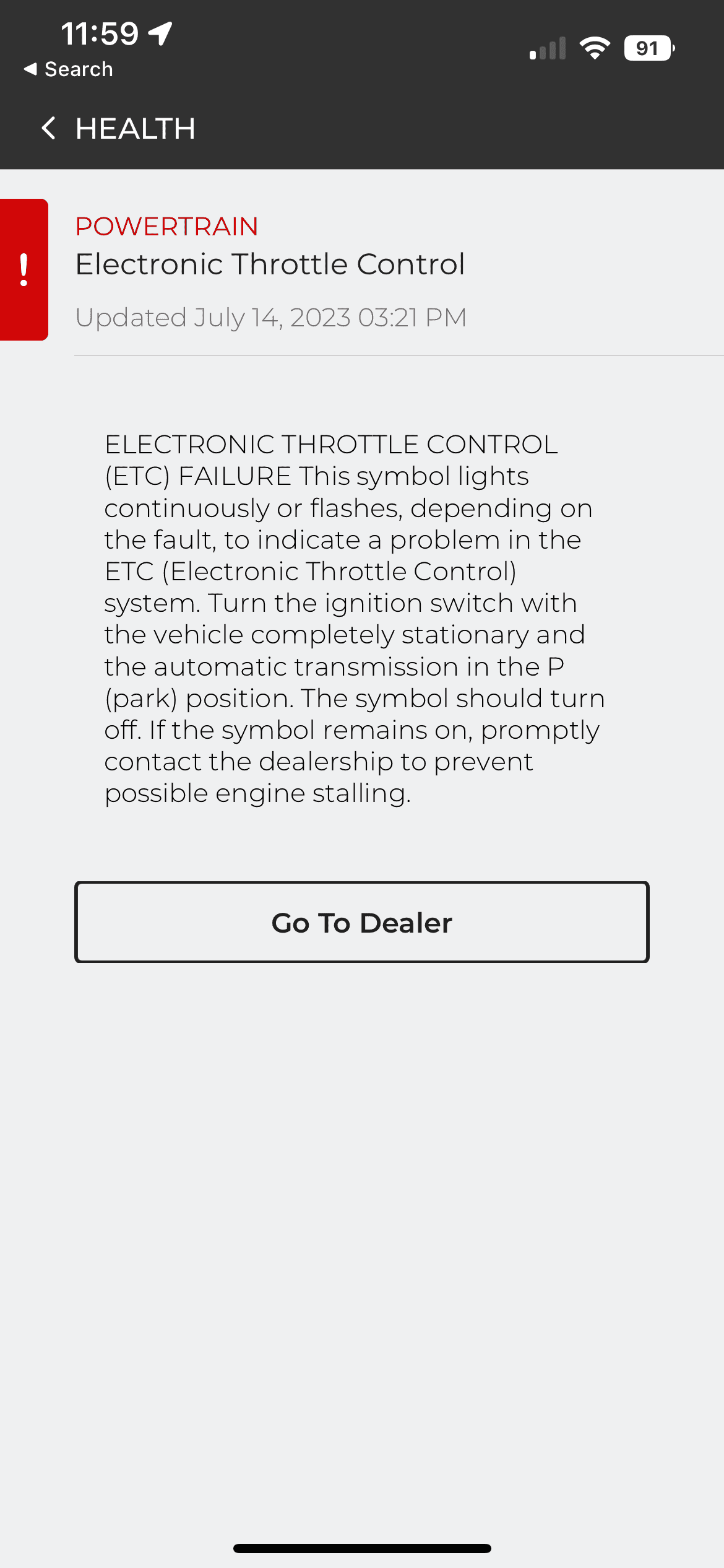

Coming home from the beach today (literally 5 minutes from pulling out of driveway) with 202 miles left to go to get home my 2023 diesel’s dash lit up like a Christmas tree. (See pics). It showed the two things wrong in the message center that you see. I had over 1/4 of def fluid left in the reservoir/tank but decided to pull in to the store and put some in it. Called the dealer to see what was up and didn’t get anywhere really except you should be able to make it home with no issue. I did make it home but with decreased engine power. Get up and go got up and went pretty much. I went to my Jeep app and in my health report it’s not even mentioning what I’m seeing on my dash. It’s showing two other issues. (See other pics). Anyone have any idea what’s going on?

Holy cripes! What a gut punch to you from your new vehicle. Fingers crossed for ya, maybe an easy fix to a frivolous issue.
rickinAZ
Rick
Jan 2, 2020
304
4,116
6,083
Phoenix
2026 MOAB 392
I'd try disconnecting both batteries, letting the system power down, and then reattach the batteries. That has worked for me in the past to clear a lightshow on my dash.
