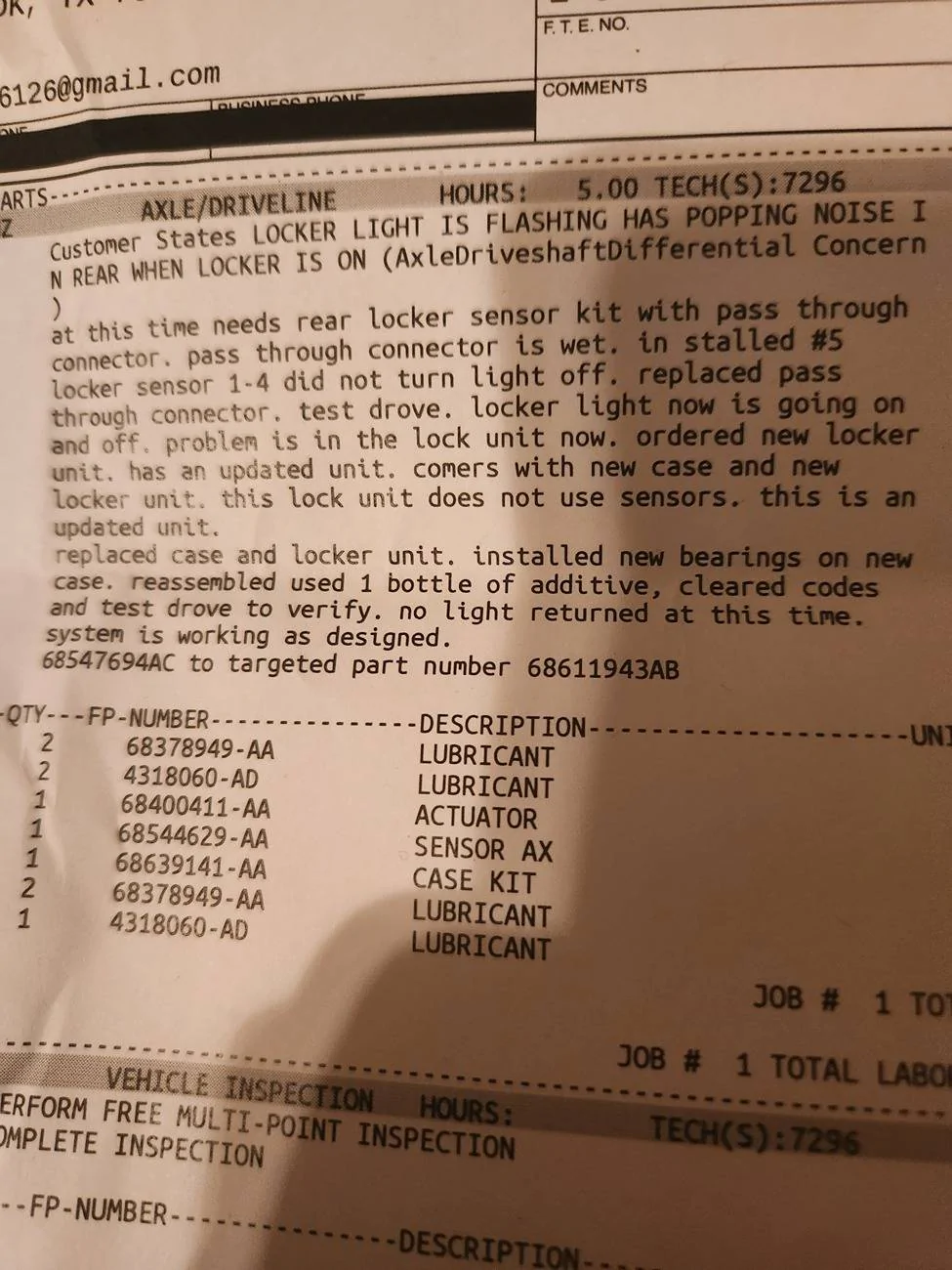

I blew out my rear locker on my 392 with a 3.5" lift and 37s and the dealership replaced the whole thing under warranty without questions. When I asked them at what point they would've denied the warranty, I was told that no dealership can deny warranty, only FCA.
I told them to go ahead and get a transfer case on order because it's going next.

I kind of thought that was the case, and this was a subjective call by the service manager. This dealer has always been mod friendly, and was bought out by a very large national dealer a year ago, and have been pricks ever since.
Go somewhere else. They wouldn't have changed the carrier to a non-sensor version on the 392s if there wasn't an issue.
Jeep Wrangler JL D44 locker sensor issue... 20240805_202757
When was that change made?
Problem with going to another dealer, the only other one within an hour drive is worse than the one I took it to.
It's my understanding that the updated carrier that they use when they replace it doesn't use the sensor. My actual mechanic did say my Jeep doesn't require the sensors once when I asked him if I should carry a Z but since I didn't have an issue at the time, I wasn't paying attention to details.
