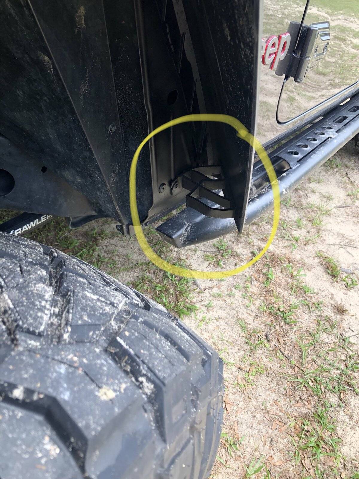

Does anyone know if there is a bracket for the lower portion of the chopped front fender?
there is not, if it’s feeling wobbly, then the AAL hardware kit (nutserts to replace the white clips) is what you’d want. Cheers

Does anyone know if there is a bracket for the lower portion of the chopped front fender? To give it more stability to fender itself!
This is from a previous post.
@Roky utilized lower bracket from removed inner.
Roky - When I did the AALlight kit and fender chop I didn’t like the way the bottom of fender was flopping in the wind going 60-70 down the highway so I modified the honeycomb brace that’s in oem inner fender and reused it. AAL doesn’t address this, and most guys don’t care that it’s so flimsy, but my ocd wasn’t gonna let it slide. I have two little button head bolts showing on my fender but it looks ok to me, there’s one that comes on the light brace anyway. You do t have to do this, but wanted to put it out there, so you don’t throw out that brace in case you decide to do it at some point......... here’s pic of brace and the two bolts.....
Thank you brother, I will be getting those as well. I haven't done the fender chop yet, but I will have to since I messed up my fenders on the trail. ??? Cheers.
Thank you brother, this is exactly what I was looking for. I will contact Roky to get more info on it. My OCD is pretty bad as well. :muscle: :muscle: :muscle: Cheers.
