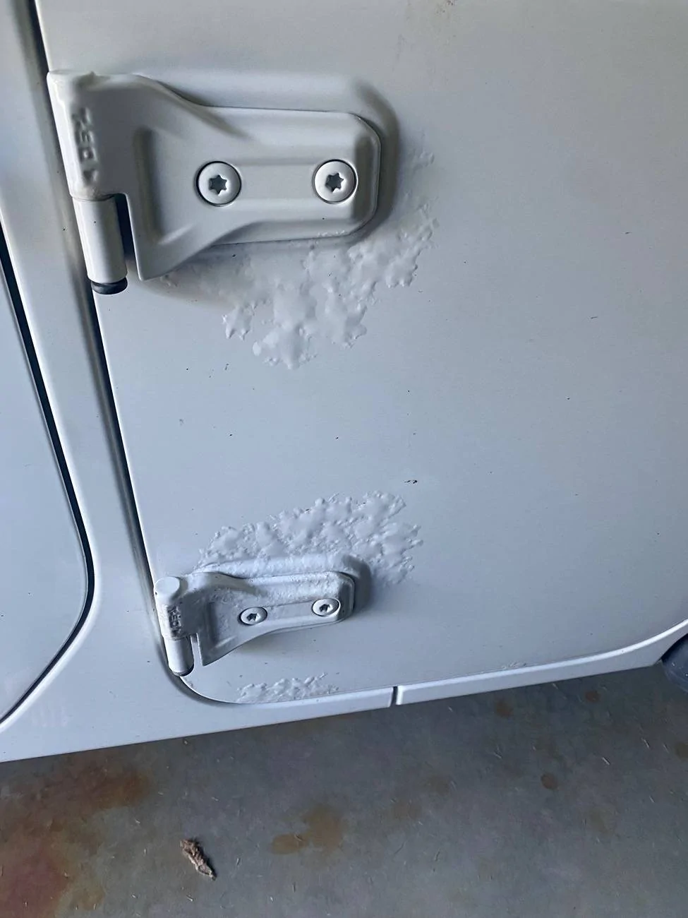

bought my 2020 Wrangler in September of 2019 from a dealership outside of Michigan. I started noticing the corrosion problem in late 2021 or early 2022 I don’t remember. I took it to every dealership within 50 miles of me and contacted others by phone. I got the same answer from all of them including the dealership I bought from” we are back logged 1-2 years on warranty paint work and only excepting vehicles purchased at our dealership”. I called Jeep Cares in July of 2022 and my Jeep still isn’t fixed. My warranty expires on the 24th. I contacted Jeep cares and dealerships since July of 2022 and still get the same response. My 1st Jeep and definitely the last. Jeep Cares is a joke. The phone number they give you is for a call center outside the United States, at least that’s how it seems to be for me. This is what all my doors look like and the hood. Afraid to wash it. From what I’ve read about the issues, it’s not a hinge or bolt problem. Ppl said their jeeps were repainted but the corrosion came back. Others said they replaced the doors completely. Who knows what’s right or wrong.

That is not a repairable door< it will need replaced
