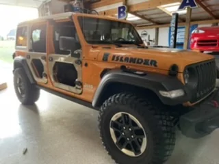

I kept my core doors off of my JKU and before selling them thought I would try them on my JLU. I was really shocked they fit so close . I wouldn’t run out and buy a new set to mod for a JL but I think I can mod and use on my JL. Vs taking a beating on selling used. Front doors latch fine, need to mod so they close with the rubber seal. For looks fill the gaps on the corners . Rear doors will need the latch moved up to close. Body lines and gaps are a better match than the front.

If you have the doors and not the JKU there is no reason to not try. Bestop has no plans right now to make them for the JLU. Have fun working on them and post some more pics along the way

@Bestop you need to look at this, the Core Doors, at least the front at already so close to fitting. Now get off your ass and get some core doors for the JL/JLU/JTs out there! It has been over two years since you asked the question “Do you want Core doors?” I think by now it has been answered, surely retooling for JK/JKU to JL/JLU can’t be that difficult, and you are giving money away not having these doors available on the market! Make it happen already, then shut up and take my money! Your fabric doors are junk, but for $2000 I rock the shit out of them, but I’d gladly pay $3000 to have doors that actually seal out the elements during bad weather, and give me the ability to quickly open my Jeep up when the sun re-appears. Let’s do this already!
Curious what you ended up doing with your core doors.
Sold my jku and bought a jlu but still have the core doors.
Were you able to find a solution for the rear doors?
