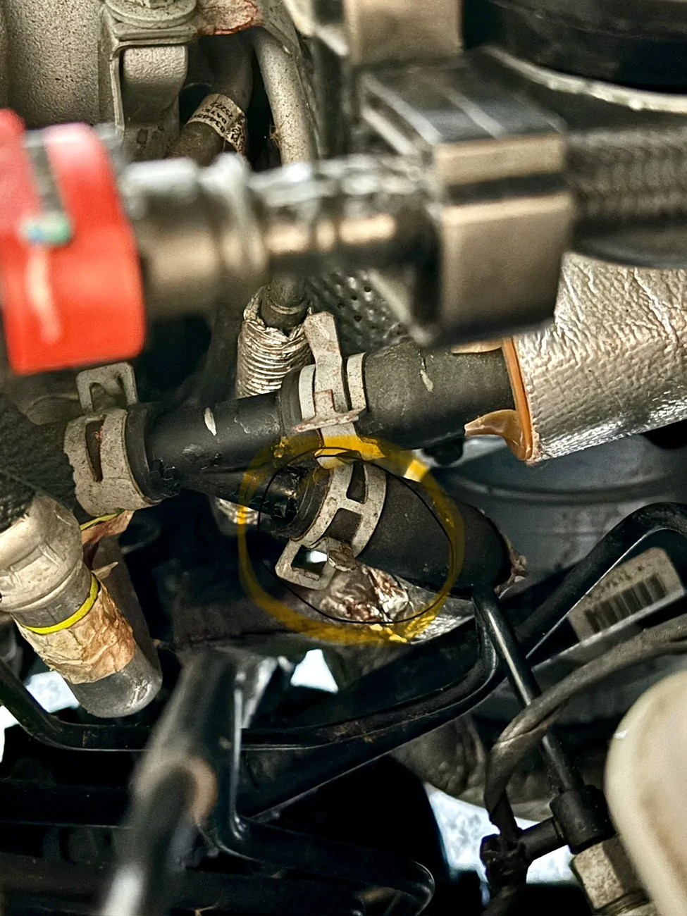

My wife's Jeep has a small coolant leak and not sure how to fix this, would I need a new Y fitting and clamps.

Also take that Y out, clean it, and inspect it for cracks.
Might be the clamp, might be a crack in the Y.

I filled the reservoir with coolant again and the leak is coming from the seam; I will replace that and see. Thanks for the replies.
