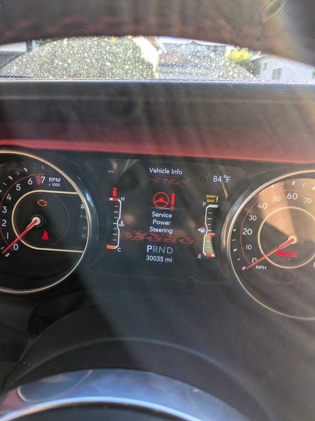

My 2018 JLUR has been completely falling apart lately. At first it had a couple of weak starts and then no start- I replaced both the main batter and the aux battery 1 week ago.
Today I started the car and then engine didn't start, got stuck in RUN and went haywire.
The only way I could turn it off was to disconnect the battery. When I reconnect it, it does this same thing. This is insane!
Does anyone have some ideas just so I can get it to the dealership?
It feels like the the car is completely busted.
Here's a link to a video. Please help.
Jeep Wrangler JL Complete electrical failure - stuck in "run" PXL_20210525_011636735

Have you metered the batteries separately to check voltages, I know you said you put new batteries in but start by checking the battery voltages

Thanks wrangler man. I just checked and the voltage was very very low 6 Volts. Got a friend to jump me and I'm up and running again.
I guess the low voltage explains the craziness. Now I have to find out why the battery died in the first place... ?

I just wanted to provide an update with my situation. Everything seemed to be running fine since the jump and trickle charge. However, the service ESS light would not turn off. I gave up and took it to the dealership. They said I was getting a lot of low voltage warnings and most likely one of the batteries was bad. They did a load test and found out the AUX battery I got from Autozone was bad. They replaced it despite being 5 days out of my warranty (hey cool).
So turns out I replaced my dead battery with a bad battery... I guess that happens - but shitty luck. Everything has been great since - no errors, no issues. Thanks for the help guys
