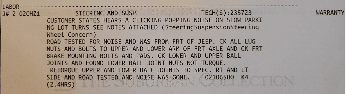

I’ve been wondering what the noise was. Took it in Monday to the dealer and told them what I read here. They checked and they were loose. Noise is gone now.

had the turning at slow speed clicking noise on my 21 Rubicon with 1200 mi on it. the shop wanted to replace the front axle, I told them about the ball joint nuts being loose. they found the lower left one slightly under torques, tightened it and the clicking seems to be gone.
thanks this forum saved me a bunch of money
