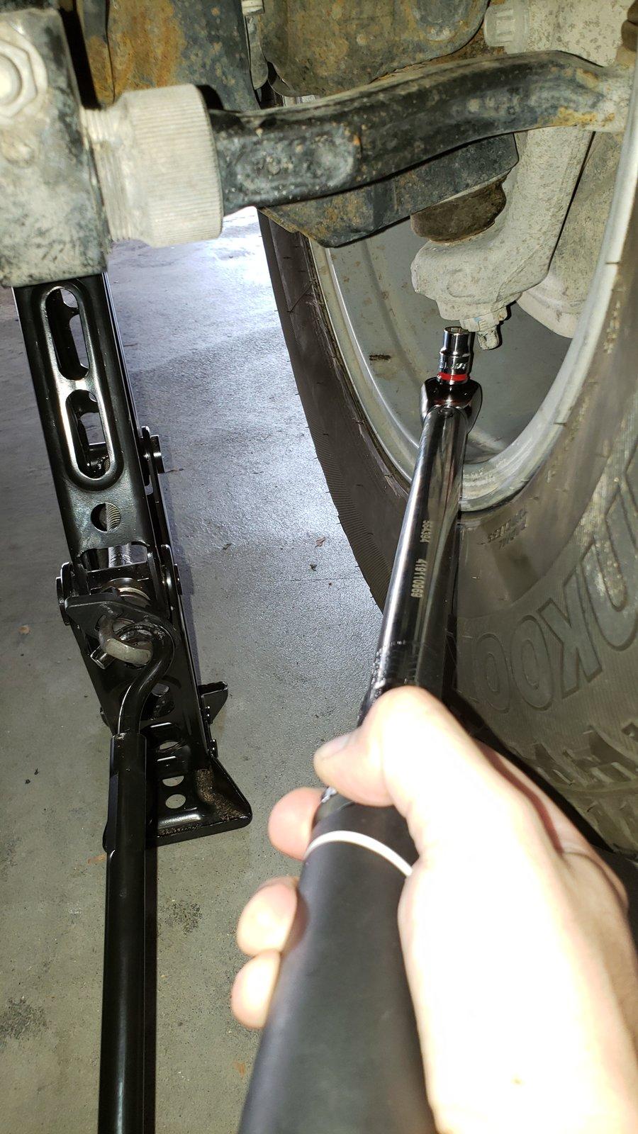

I am sure I am doing something wrong, but it doesn't look like a torque wrench would fit between the joint and the wheel. Should the wheel be removed?
my 1/2" torque wouldn't fit. so I went out and bought a 3/8 and a shallower socket. I measured them in store to make sure it would fit. Others may have better advice, but I needed the leverage and it worked. I wouldn't sweat using a torque, but find a ratchet that extends (Harbor Freight has some) or a breaker bar. Taking the wheels off seemed like too much effort for me after breaking those cotter pins out, but would work too.
It's OK to remove the tire if the wrench won't fit. I didnt' even use a torque wrench, I forget what I used (open ended wrench, socket, adjustable wrench??) and tightened until the thing stopped clicking. Why is your socket so small? It almost looks like you are trying to fit it on the bolt and not the castle nut.
You know why it almost looks like I was trying to fit it on the bolt and not the castle nut? Because that's exactly what I was trying to do :CWL:
A combination of low visibility and inexperience led to this error.
I grabbed a regular 22 wrench and tried again: the upper nut didn't move at all, while the bottom one made a clunk. The clicking seems to have gone away. I love this forum, thanks!

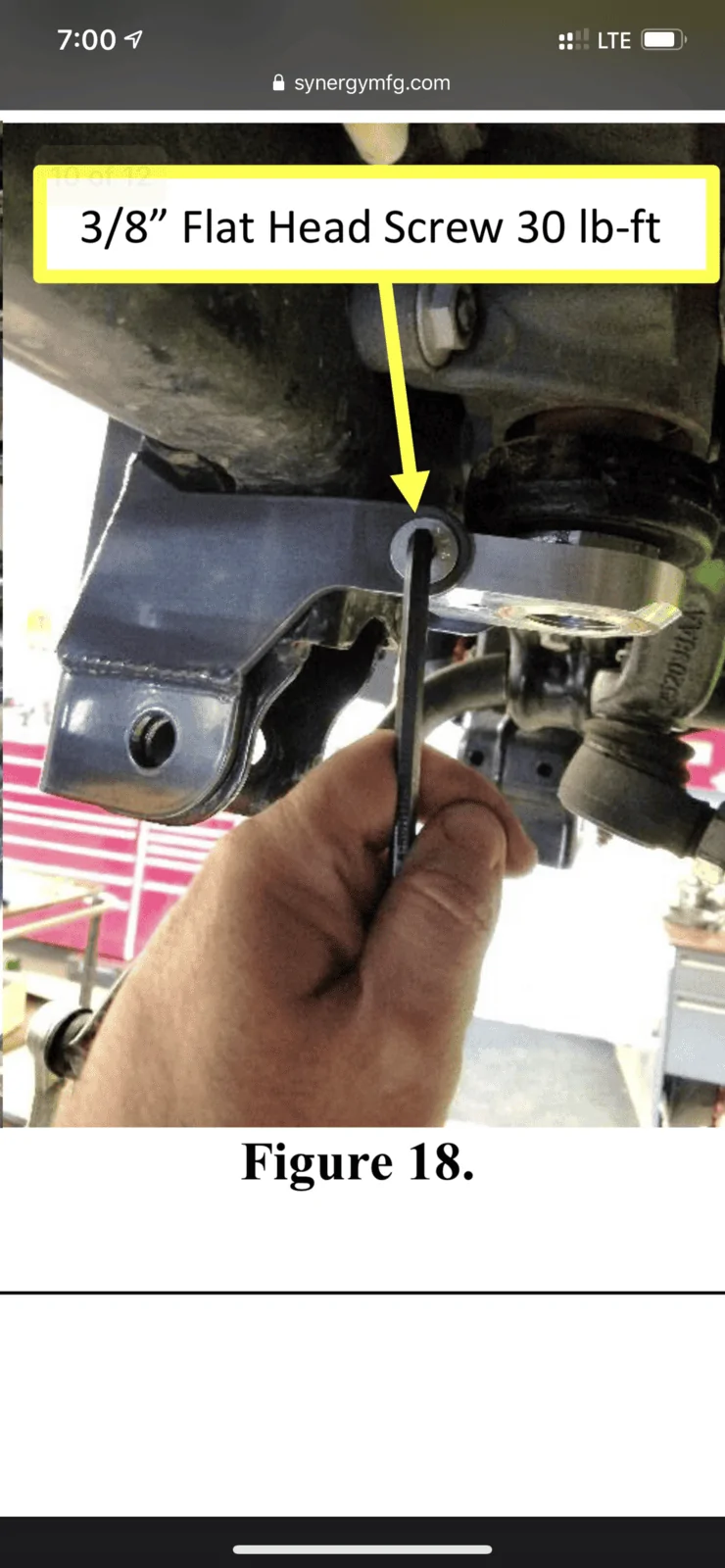

Wanted to provide an update and possible solution for those who have this clicking/ticking noise and also have a synergy track bar and a sector shaft brace.
I was having all the same issues and checked the torque on drag link, track bar, tie rod, shocks, control arms, ball joints, etc. However, I was still getting the noise. I had my GF turn the wheel as I searched for the noise and isolated it to the 3/8” flat head screw on the back side of the brace (picture attached). This is the flat head screw facing the rear of the Jeep. Despite having put blue loctite on this screw when installing, it worked itself loose and was causing my clicking/ticking noise. Dab of blue loctite, 30ft/lbs and noise is completely gone.
Happy wrenching!
