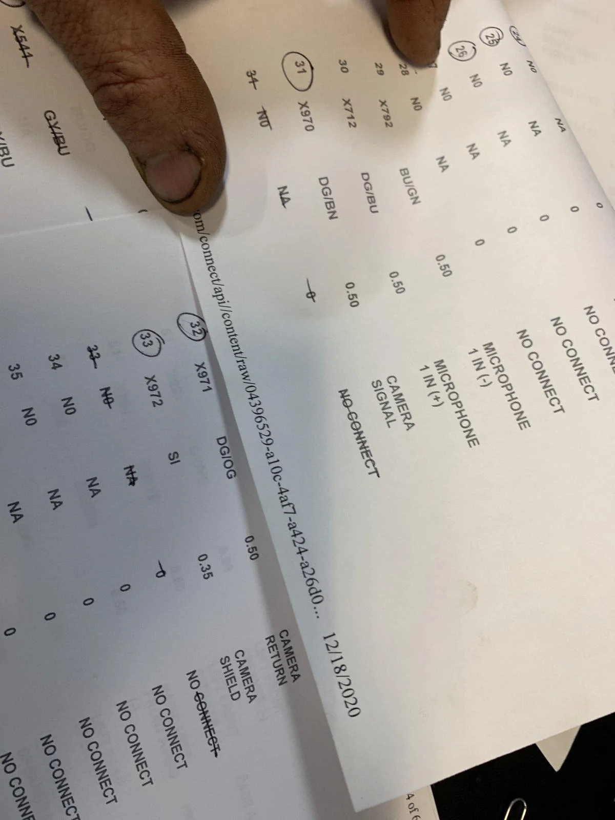

The issue that I’m having is my backup camera

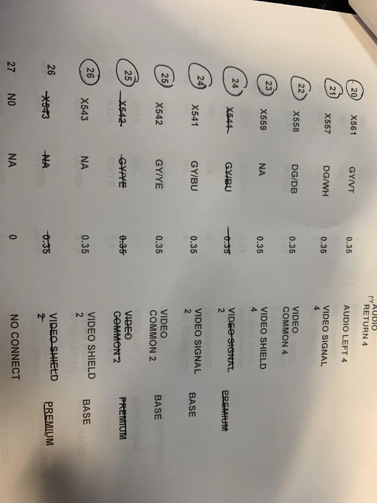

it works but it has a greenish almost night vision looking tint to it I pulled away schematics from Chrysler for the 2018 ram and then2020 jl. There’s definitely a difference in video inputs with the jail wrangler using pins 21 through 26 in the ram truck using pens 31 through 33 I have all the wiring if anyone needs help PM me but I’m still trying to figure this out myself however having access to Chrysler wine really helps

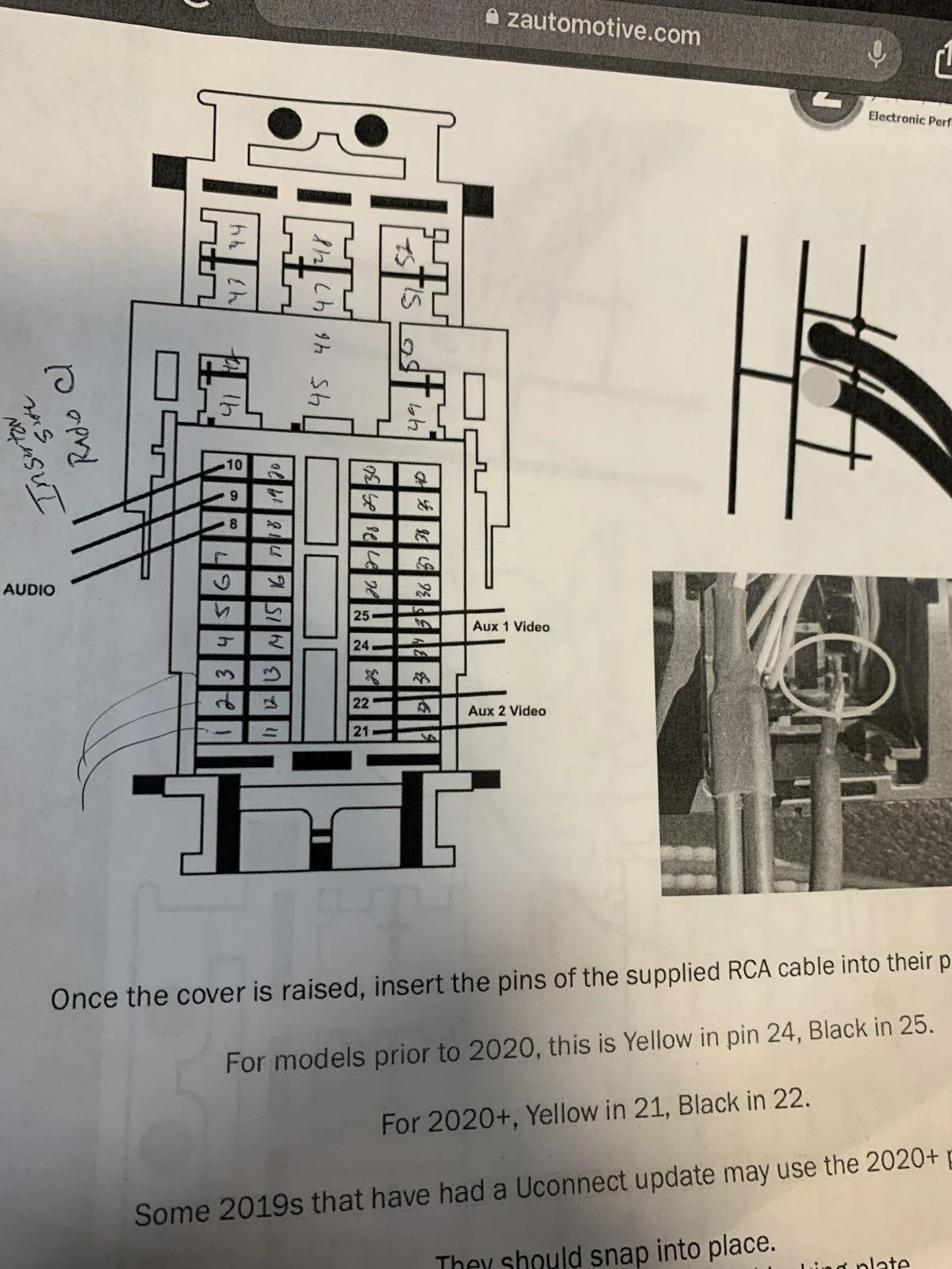

now granted these are what is referred to as auxiliary video one and exemplary video to I came across these when I was on the automotive website looking at the jail front camera and clicked on the instructions it showed to tap in to 21 and 22 or 24 and 25 depending on your model here which I will show in the next attachment so I decided to pull the wiring information from dealer connect for the ram and the jeep and noticed that these exhilarate video inputs are exactly one set of pins over on the ram

Like I stated my back up camera works but it has a greenish tint to it like you’re using a pair of night vision binoculars I know the camera connects through the red factory coacts connector but I’m curious to see what pins are in my wrangler on 21 22 24 and 25. If nothing else once I get a taser it gives me the option to add exactly video on these two ports and have two different inputs perhaps I can figure out a way to wire them to the camera
