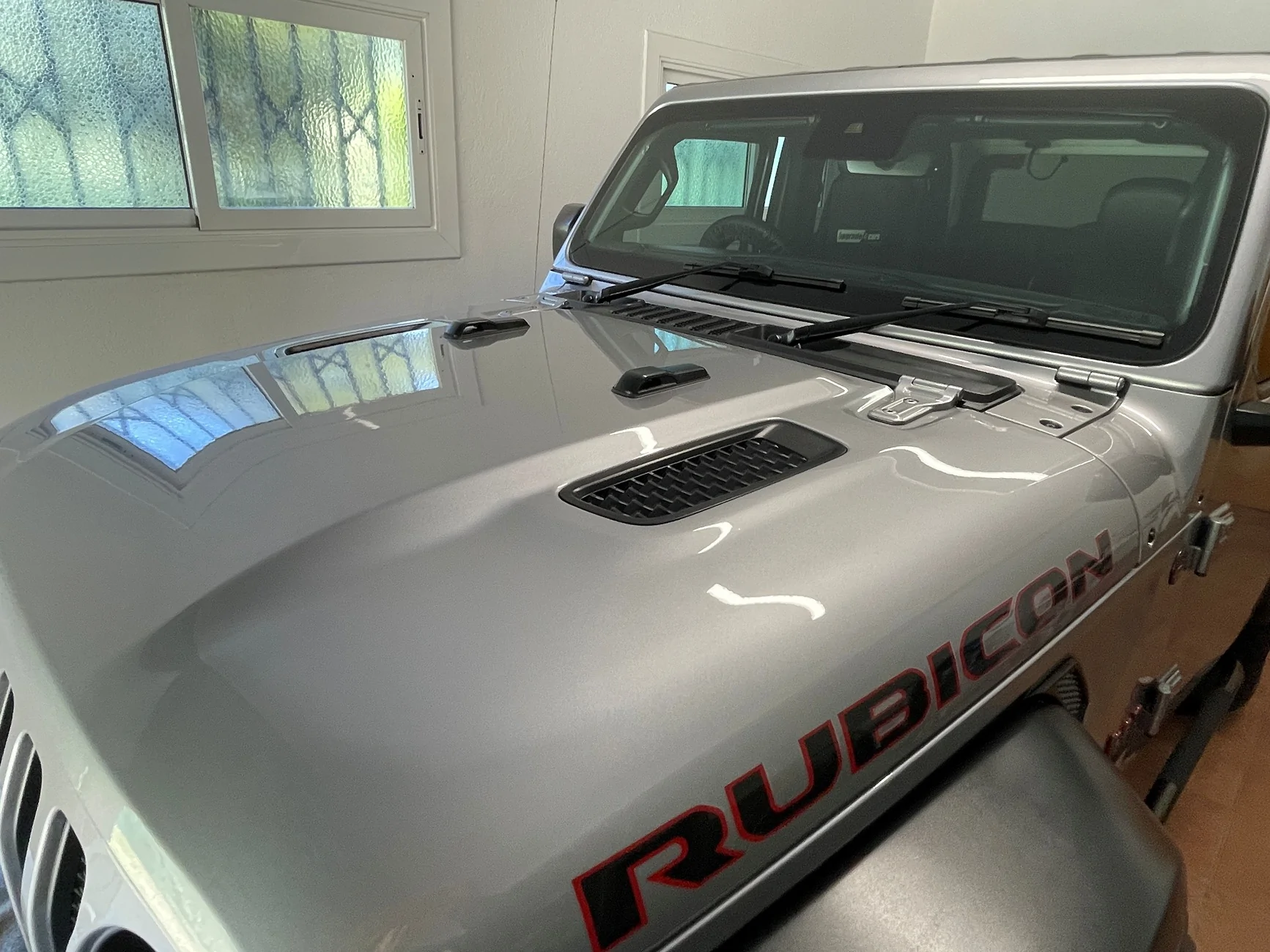

You should be fine around the decals, they seem to be pretty resilient.
I did a complete wash, decon (tar/tree sap, Iron remover, then clay towel) and 2 stage machine polish prior to having a full PPF install and ceramic coating on my 2 Door
I used Autosmart Tardis for the tar and tree sap removal, CarPro IronX for the iron remover and I then used a CarPro medium synthetic clay towel for the claying process. I use Absolute Rinseless with the towel as a clay lube in 64:1 dilution in a spray bottle and then rinse the towel in a bucket with Absolute diluted at 256:1 The 64:1 is a little overkill but I have found that I get little to no marring on the paint with this method.
When working with the chemicals around the decal, I was careful not to get too much chemical directly on them. I used the tar remover on a microfiber cloth so I could put it on the paint around the decal and avoid spraying the decal directly.
With the iron remover I did half the hood at a time, I used a grouting sponge to carefully apply Iron X to the paint around the decal. Some chemical will inevitably get on the decal, but I tried to minimise it and also avoid letting it dry.
Machine polishing around the decal should not be a problem, if you have access to a small machine polisher then you can use that to minimise the contact you make on the decal, but I wouldn’t expect normal machine polishing to lift a decal like that, but it’s always better to be safe than sorry!
Let me know if you have any questions, I hope this helps!
