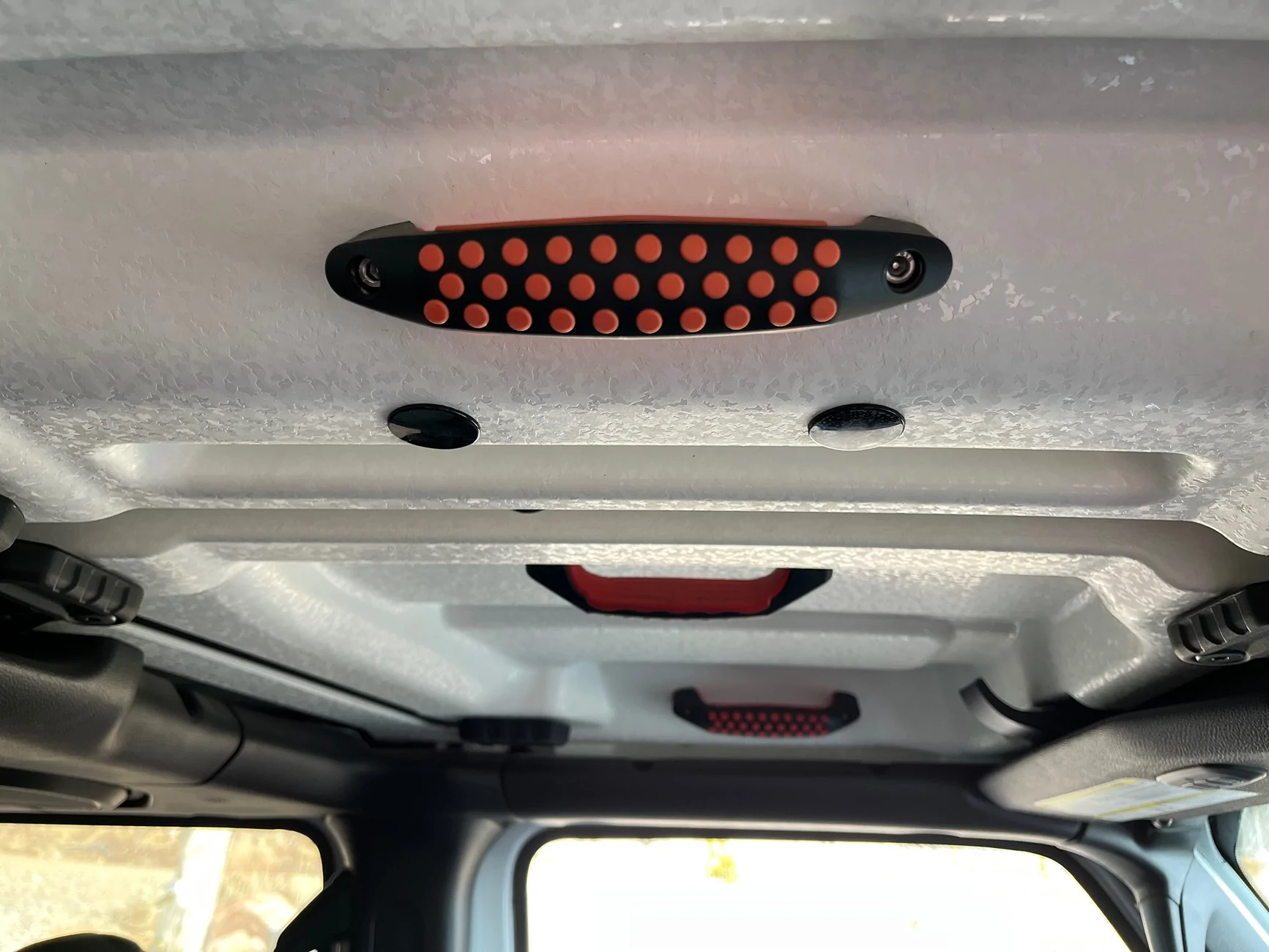

Do they make a grab handle that mounts (screws) to the removable front top?
See photo. All thru-bolted. Access holes drilled, two shown with black cover plugs in place.
