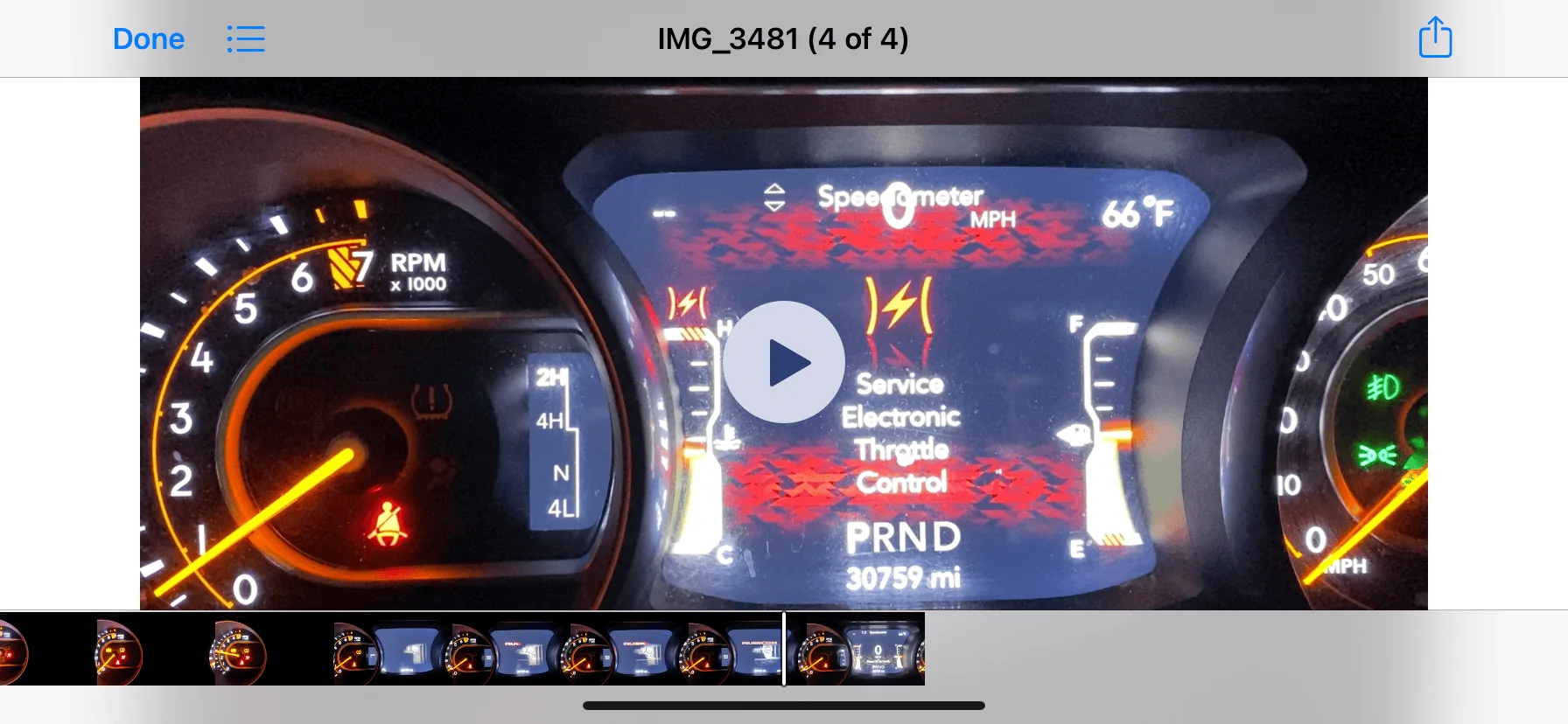

So after installing the Tazer mini, after putting on 37’s, & doing the Rubi high line fender add on and putting the Quake LED slim chop kit…this is now occurring…but ONLY upon just starting the Jeep…
I’m getting a “Service ETC” briefly, and I mean BRIEFLY.
basically after I start the Jeep, and the Rubicon Splash goes through it cycle (I have a Sport)
for like .5 seconds - 1 second, the alarm comes up, then goes away.
Note - my idling seems a bit sporadic, though it is not showing so on my RPM’s.. just feels like it is almost “skipping / misfiring slightly” and I mean slightly but enough that it feels strange idling..
Has anyone had this issue after marrying the Tazer, and adding / removing or tweaking some things??
Reason for concern, obv I hope it’s not legit…but I never had that issue prior to installing Tazer.
2nd I’m still under 6 month , 6k mile warranty bumper to bumper, (which ends VERY soon) and if it is an issue I want to get it fixed so it’s $0 out of my pocket.
Is there a way to diagnose if it’s false or not? There is nothing in the Tazer instructions for diagnostics that mention this whatsoever.
I have rebooted, and went through probably 10 or so sleep cycles.
I’m posting this under General Questions, rather than Tech because I feel it is a general question rather than a direct tech question regarding the integrity of the OEM system since it now technically isn’t.
I messaged Joe at Tazer but no avail. So I’m hoping you guys can help, or atleast calm my nerves …. Video is too long to attach so it won’t let me, but I took a screen shot of exactly what pops up for literally like I said, .5-1 seconds then disappears.

I had this issue but I was also getting an issue with starting the engine e.g. my engine would refuse to start every so often after not using the JL for a week or so. Very difficult to troubleshoot as it was sporadically happening without any lead to link to. It happened to be an issue with faulty auxiliary battery. After it got replaced both the ETC alarm (showing exactly like yours) and the engine failing to start at times disappeared as issues. Hope this helps.
So you think it could be unrelated to my Tazer? Or do you think I should maybe unmarry it, go back to OE specs then see if it’s doing it? My cause / thought is I still have a bit left on my 6k mile bumper to bumper warranty
I am just saying that even without a Tazer I had part of your issue e.g. the ETC alarm and it's appearance. I didn't notice any misfiring whatsoever as you did. Issue resolved after AUX battery was swapped with a new one.
I never used Tazer so it's difficult to comment on your particular setup, but from what I read and researched online I wouldn't attribute this particular issue to the Tazer. It might be just a coincidence. To be on the safe side, probably a way to troubleshoot and rule it out is to unmarry (especially if you don't need any of the live features), re-plug the SGW and monitor if the issues would persist and then if they still do probably go to Jeep service to have it looked at.
That’s along the lines of what I was thinking. Thanks dude I’ll try that route ??

The rough idle seems pretty normal for the 3.6, though you have not even mentioned which engine you have. I do not think it has anything to do with the Tazer. I would be replacing the aux battery and accepting the missing at idle as normal, my brand new '21 does that with less than 2500 miles on it, done it since new and there are lots of reports here of the same behavior. There are also lots of reports of the aux battery causing all kinds of different electronic problems and they do not seem to last very long (the battery). I do not recall any threads where the Tazer mini has caused people problems and I do not think the missing at idle and the ETC warning are at all related.

Do you see any CELs in the tazer error code list? If yes, clear them and then reboot/sleep cycle. Gremlins are never fun

I'm not sure why you reached out to ZAutomotive... doing that was kinda like putting the cart in front of the horse..
Troubleshoot, first ..... research...... and then reach out to vendors, once you have a clue. You can't expect a vendor to troubleshoot something like this...
With that said unmarry and remove the Tazer JL Mini. Be sure to reconnect the 2 cables at the security gateway.
Now troubleshoot. and.... do run without the Tazer JL Mini for a few days.. until your issue is resolved.
Undoubtedly, your issue(s) have absolutely nothing to do with the Tazer JL Mini.

So if I don’t have any CELs on, there could still CEL’s on the Tazer code list? No I didn’t realize that nor check. I’m not sure I am getting dressed to run some errands today, but I’m gonna get dressed and got out and check that now @hoag4147 and I’ll let you know. Thanks again for all your help

Sorry man. Wrong term used. I meant DTCs

I have had the same issue. Not sure if its the Tazer or other gremlins. So far living with it and a couple of other messages that come and go. Hard to tell it all the extra electronics vs. the simpler Jeeps of past.
I have had way too many vehicles and the Jeep(s) have always given me the most problems.
As an aside, my Tazer just died and I think I may run without it for a bit. Their customer service leaves a lot to be desired, not withstanding a few very hardcore supporters of it.
