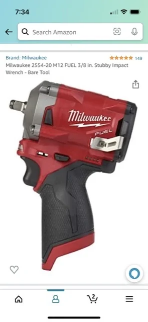

Ha thanks everyone. Good to know t55 is the right one. I did order impact driver and heat gun. So between those and a hammer surely I can get them out.

Just to close this out - ended up tapping t55 torx into bolt with a hammer as some of you suggested and used a breaker bar - worked like a charm. I had used the impact driver but it didn’t work.

This is what I bought that didn’t help.
