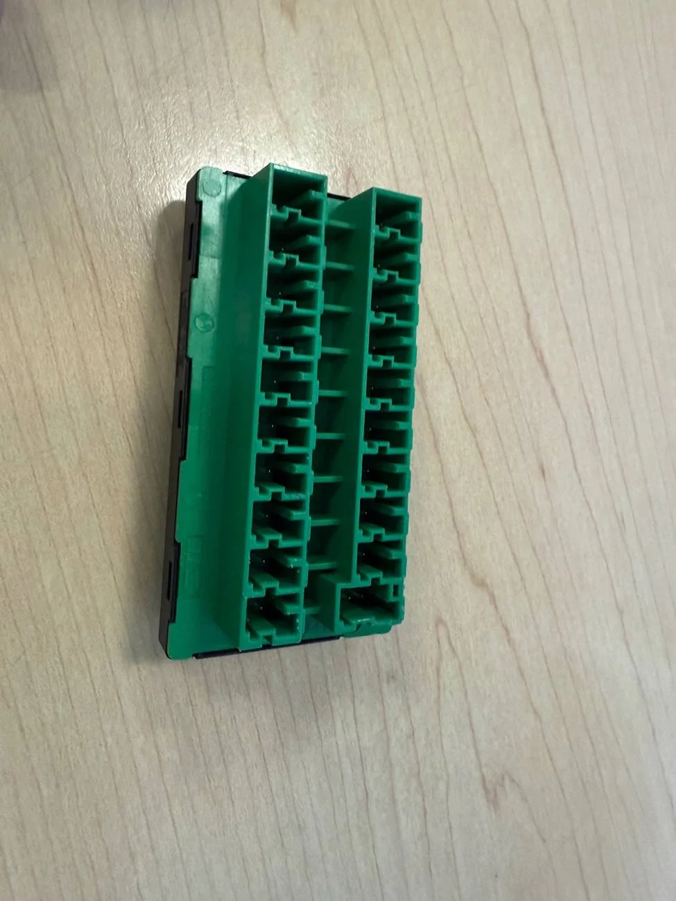

Just went through this couple weeks ago all the lights in the dash , steering was out , just about everything that could fail showing in the cluster was out and illuminated. Mine is a stick but I hear the automatics won’t shift out of part. I got mine from a Jeep dealer
My main battery has been replaced my aux battery is original I have a 2019 but never use the auto start stop at all
I replaced the cam bus connector behind the I’ve box and has been fine for 3 weeks now

I really think the can bus I got sent was counterfeit, it made the system worse. So its my Daughters Jeep, I think Im gonna go all out, Ill replace the can bus and the main battery and go from there.. the one we ordered off Amazon turned it into a rubicon, who knew you could get a rubicon with a 68 dollar amazon order..L

Update, Our local dealer actually had one in Stock, which amazed me. Figured id be on a 10 day waiting period. (also had an ECH in stock for our 4XE as well which REALLLLY amazed me!)
At Any rate, I installed the new Bus last night, it started with no issues, still has a check engine light But i know its having wheel speed sensor errors as well. it drove, shifted and start / stopped correctly. everything works. Still gonna swap in a new battery as well for her.
