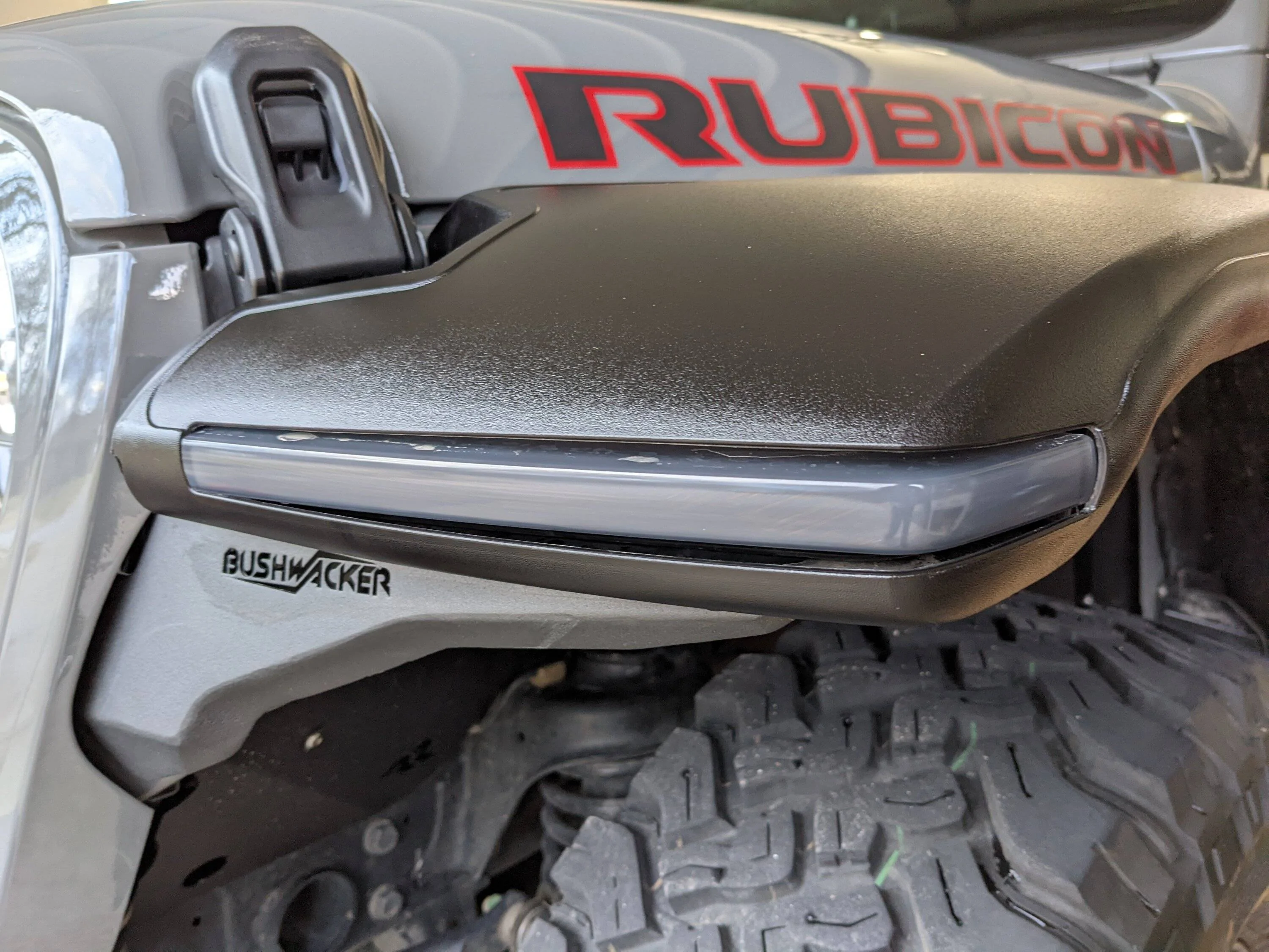

I upgraded to the Bushwacker Hyperform fender flares w/ LED DRLs back in March. Ran with them just fine for a few months, then started getting drivers side turn signal out warning, it came and went, then a few months the passenger side out warning started happening. And now the warning is on at all time, yet the lights still work. I had the factory LED lighting option, and I understood these to be direct plug-and-play with no issues, but aware this is an issue with replacing non-LED bulbs with LED lighting on many vehicles.
Any body else experienced that with these (or another manufacturers LEDs) and have a good solution?
Any info will be appreciated!

I put a set of the AAL versions on my wife's JLUR. The first versions had lots of bulb out issues, the newest versions (made by Diode Dynamics) have been flawless. I don't know if you can purchase the harness with the resistor bank separately, but it's worth a look.

No worries!! I found my issue. My inner fenders were “pinching” on the wire. Once i redid them and there is no pressure on the wire, it has been working

Yeah I have completely disconnected mine and checked the wiring a couple times to make sure I didn't have a similar issue. Even cleaning up the connectors, and wrapping in tape, and running the wires in a loom, making every effort to protect them. Like I said I kinda just gave up! lol
