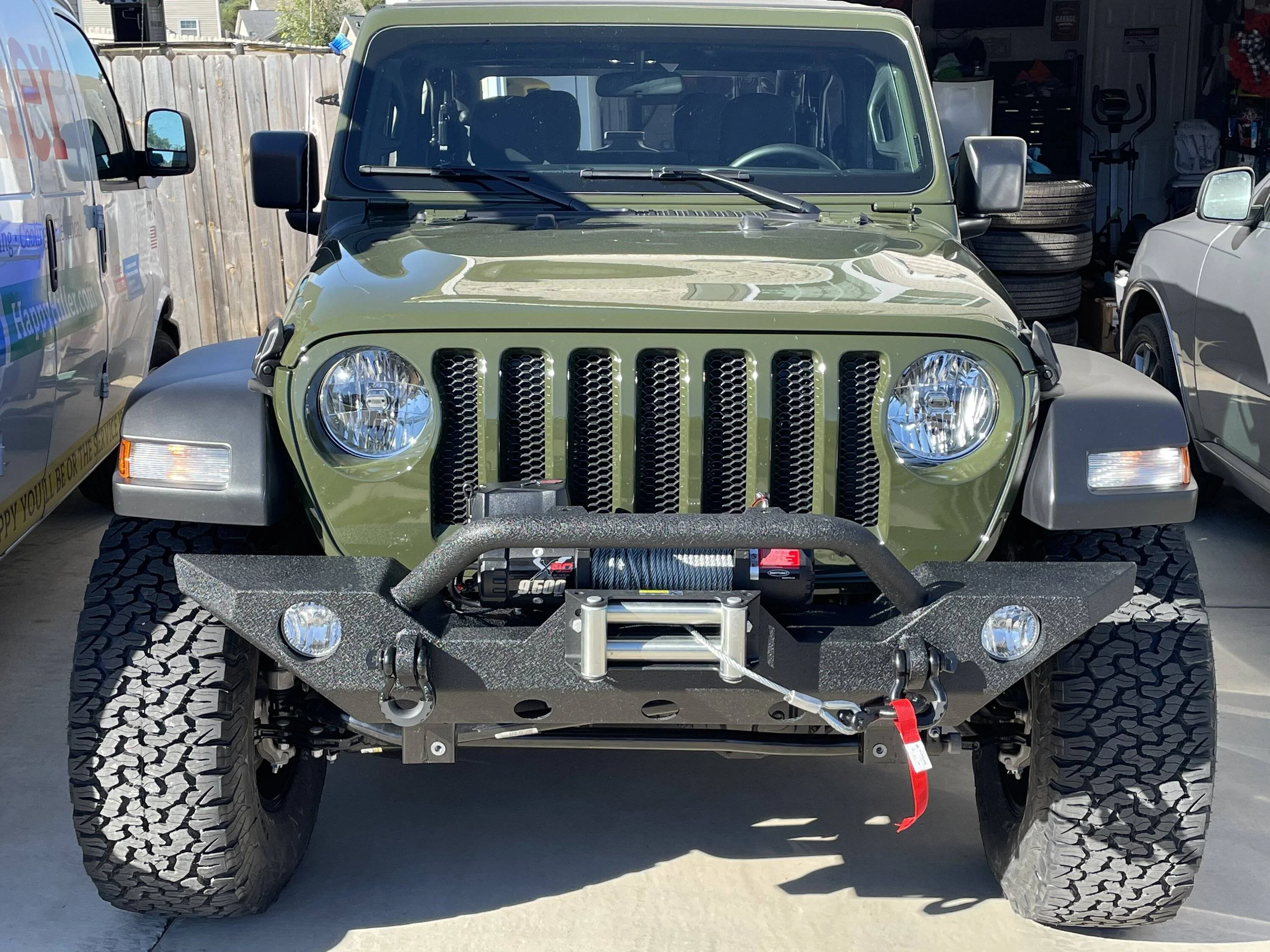

Rommel1940
any recommendations?

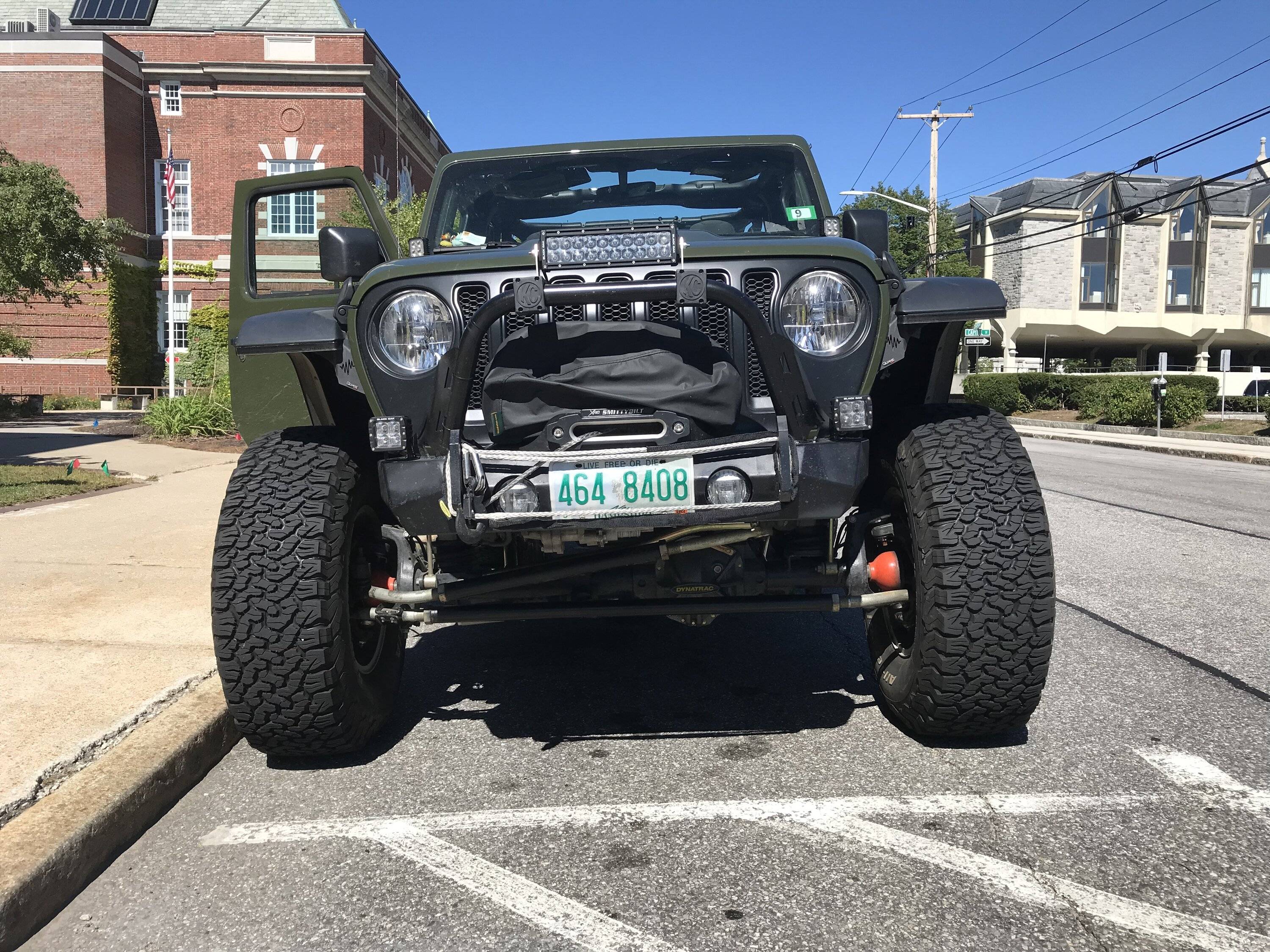

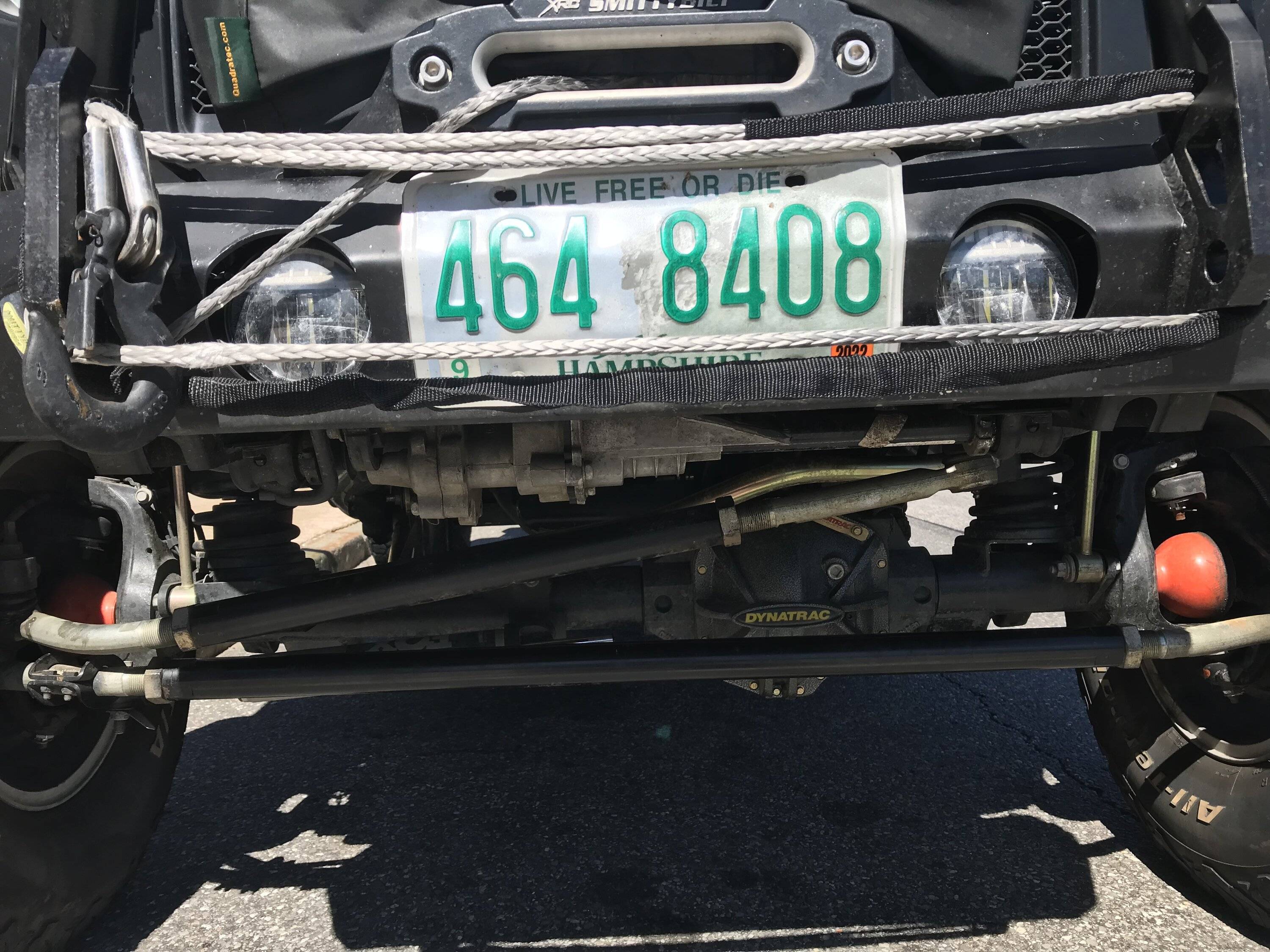

Just gotta work up the courage to chop off the frame horns.Skip the skid plate and if its a Rubi, flip the swaybar motor up. You will gain way more clearance and there isnt a lot to hit there besides the tie rod and drag link, both of which are pretty solid and not really covered by most skids anyways.
Worth the clearance. I was catching them when rock crawling. I have a boulder near my house I flex on and the Jeep would go up it fine, but when coming down on one of the front wheels a horn would catch.Just gotta work up the courage to chop off the frame horns.
