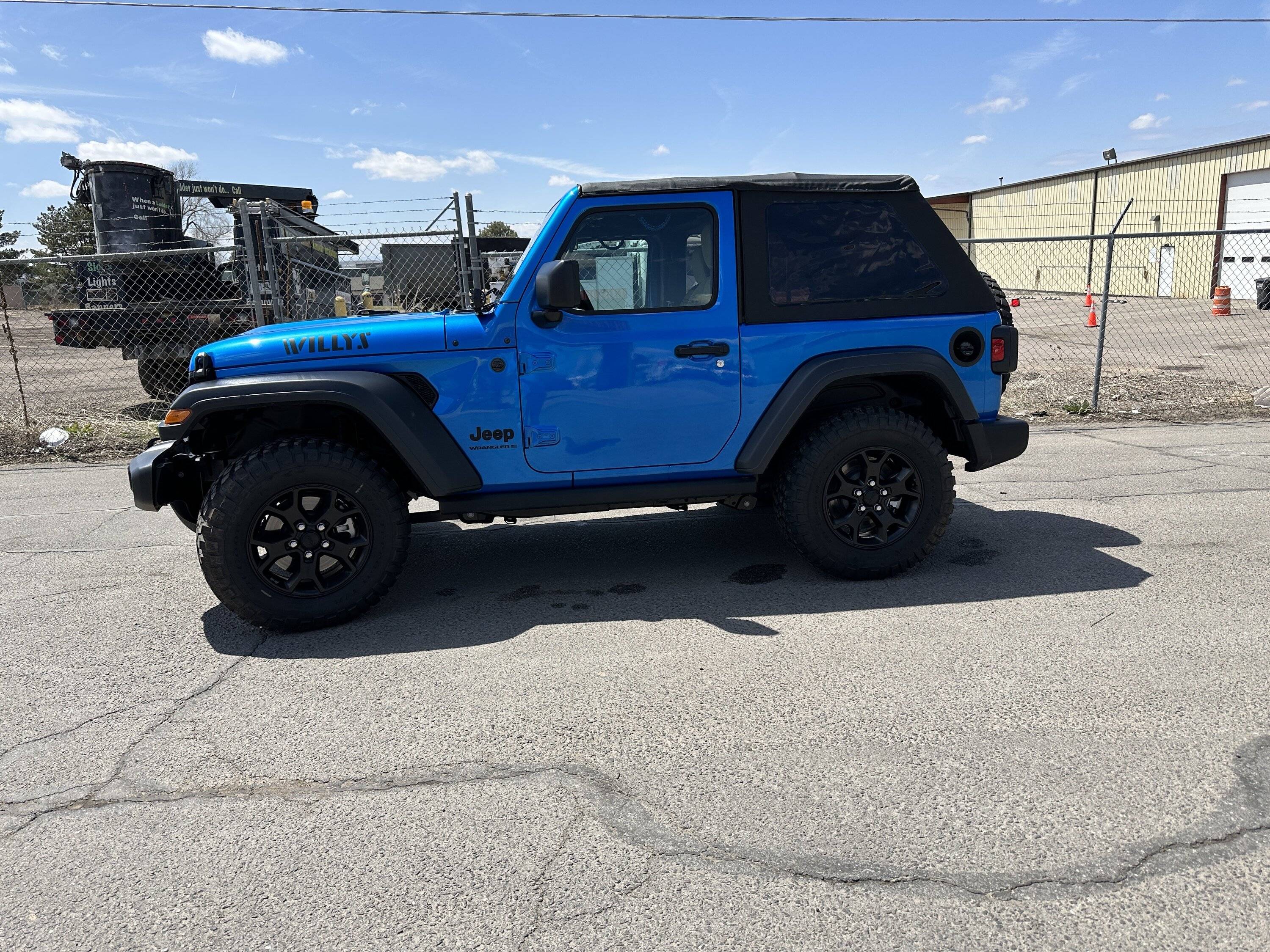

Something is up with the rear quarter window supports, where the J-Hook doesn't want to sit properly on the rear bar.
It's all installed right now, he helped me with the install and everything is on there and fits. But we couldn't get the J-hook on either the driver or passenger side to sit quite right. Also, every time I open or close the sunrider it sounds like I'm breaking things. It's SO loud. Might just be it being new and we installed it at like 40 degrees F.
I searched @Bestop FAQ and I did a bit of searching through the forum, just curious if anyone could edumacate me on what I might be doing wrong?

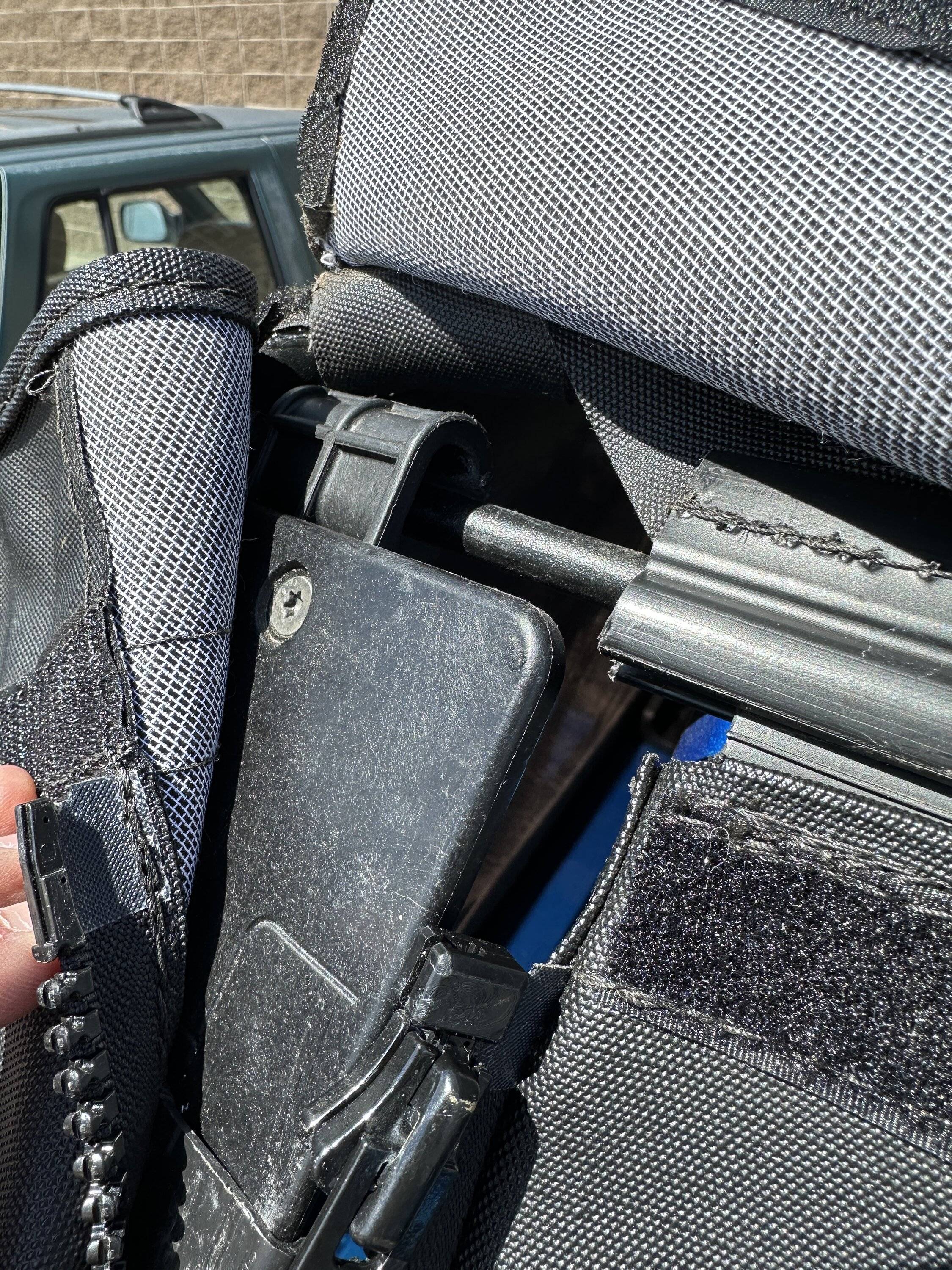

Unzip your rear window, hold it up out of the way, and take a pic of the joint you're referring to. (I know exactly which one you mean; I just want to see if you have them seated flush on the bar.) Those clips are the worst part of this whole kit. They're a pain to get situated.

And that is indeed the part that I’m having trouble with. I can’t seem to get it to sit on the bar quite right. It sits nice and flush on the passenger side

Oh yea, those are up too far - that J-shaped piece needs to snap down onto the bar. Be careful with it though, they break easy!
Lol yes, that is the problem.
I can wrap the J-hook around the bar, but then when I go to snap the support bar in place at the tub, the J-hook just pops back up and out.
very confused at how to go about it. I’m guessing it’s an alignment issue, I just don’t know where to try and adjust it

Just installed again without issues, so you may just have an alignment issue. Pull the windows out and check all of the top especially that back brace to make sure it's all the way back and mounted correct. Keeping the bolts loose until you get everything tight. The top should pull tight enough that you can't velcro strap the top to the bars unless the front is folded back.

Read your post at work so once I got home I got to work on it.
Pulled all the windows, propped up the sunrider, popped all the snaps and I flipped it forward to get to all the bolts.
I loosened them all and was able to shift the driver side back like a 1/16-1/8" and THEN noticed that the #3 bow velcro was completely undone. So I velcroed all of that, got all the bolts properly tightened down
AND GUESS how easy it was to button it all back up and proper. The windows fit better, the J-hooks fit properly.
Everything is GREAT. Thanks for the advice!!
