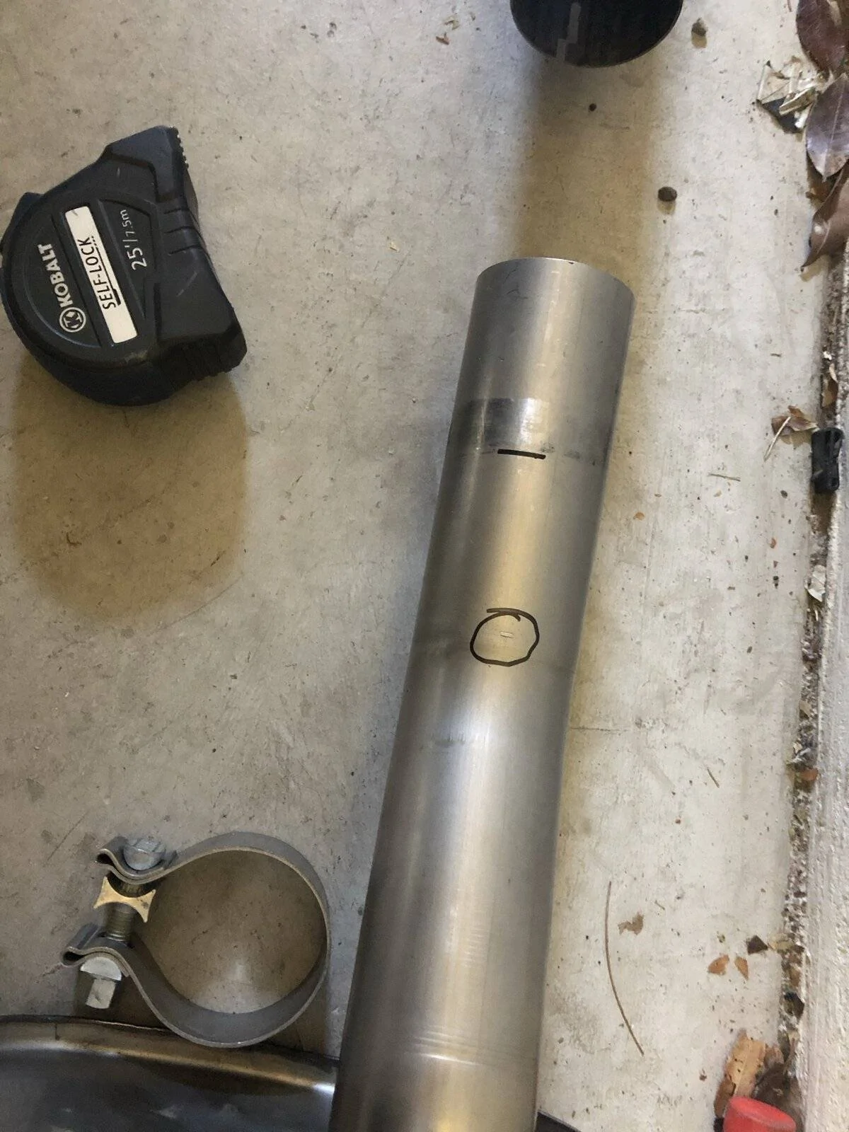

Purchased a Borla climber touring (140828) and started install, but the exhaust is about 2" too long. Both hangers on the rear section end up behind the rubber isolators when the system is assembled (when the rear section is disconnected from the muffler, they fit fine) Anyone else seen this?

I had to trim about 3" off the muffler assembly pipe that goes into tailpipe assembly to get everything lined up. If you aren't up for that, I'd call Borla support.

Thanks, good to know I was not alone in this, just for anyone else who encounters... my muffler assembly was about 39" long
