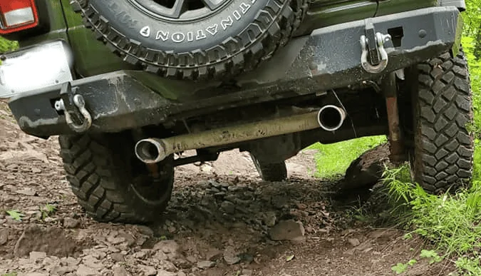

The S-type and ATAK are pretty much the same as far as how they hang, and how the pipes run. I don't have any clearance issues going around anything on the body. It does hang a little lower than I wish it did in terms of off-roading, but meh, this rig is intended more for dirt roads than rock crawling anyway.

I have the Borla Climber Touring. If you do any offroading I would highly recommend the Climber over their regular catback so that your exhaust tips do not hang down below the bumper.

Thanks, I am looking something for off road so the climber would be better and I like the quieter touring model.
