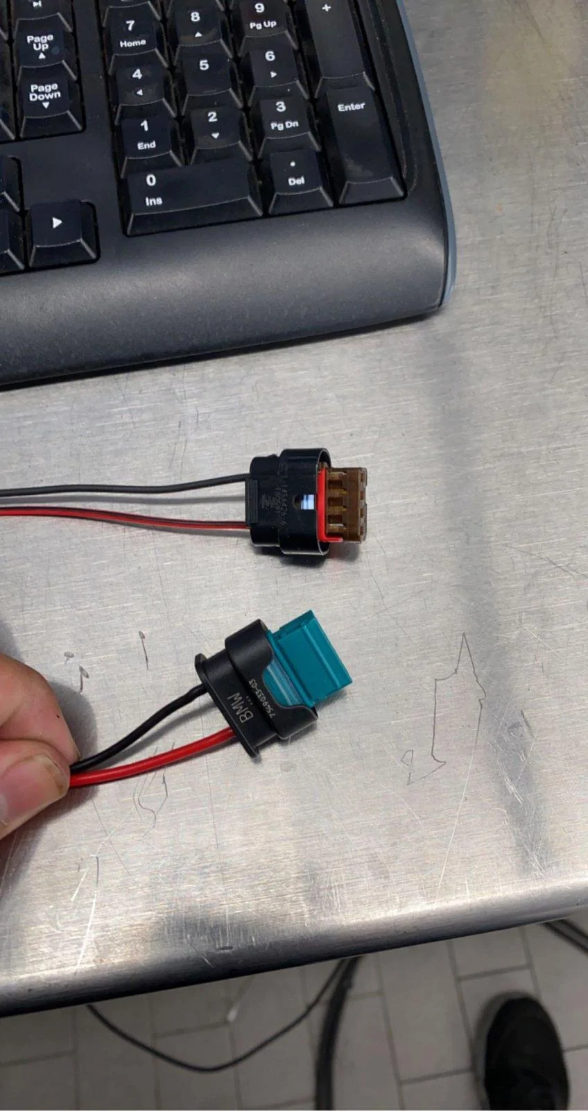

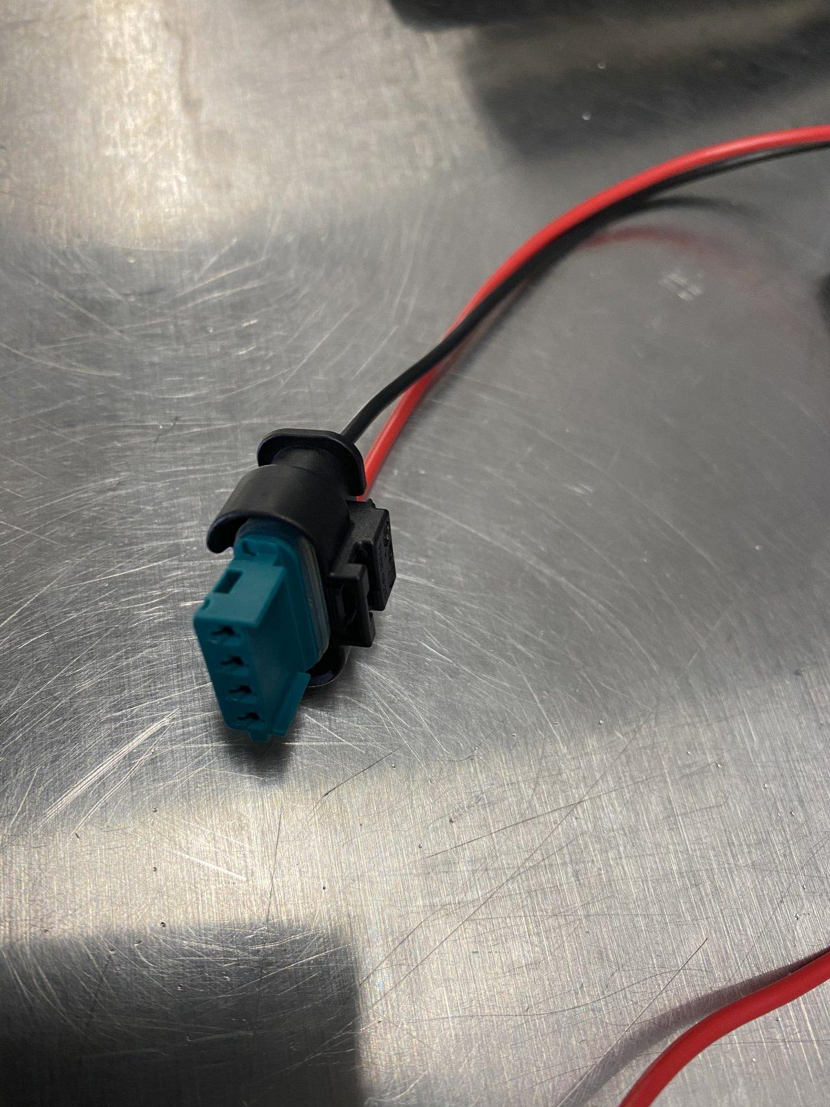

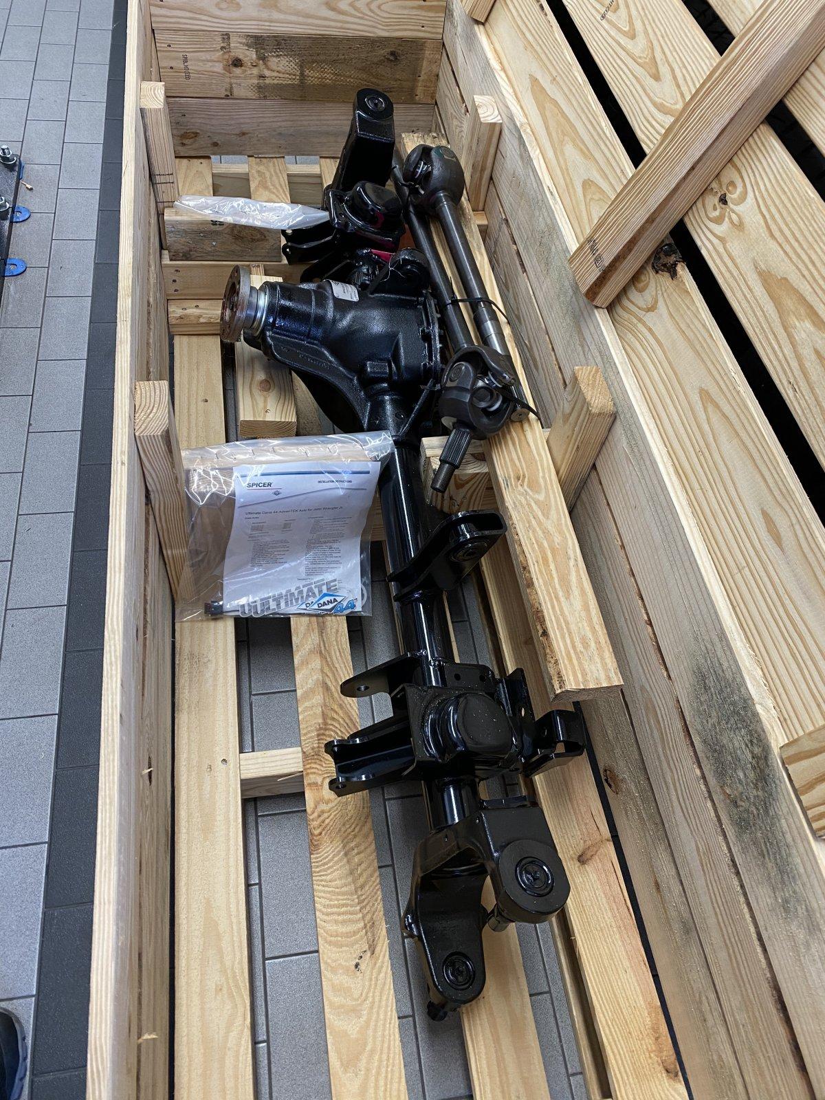

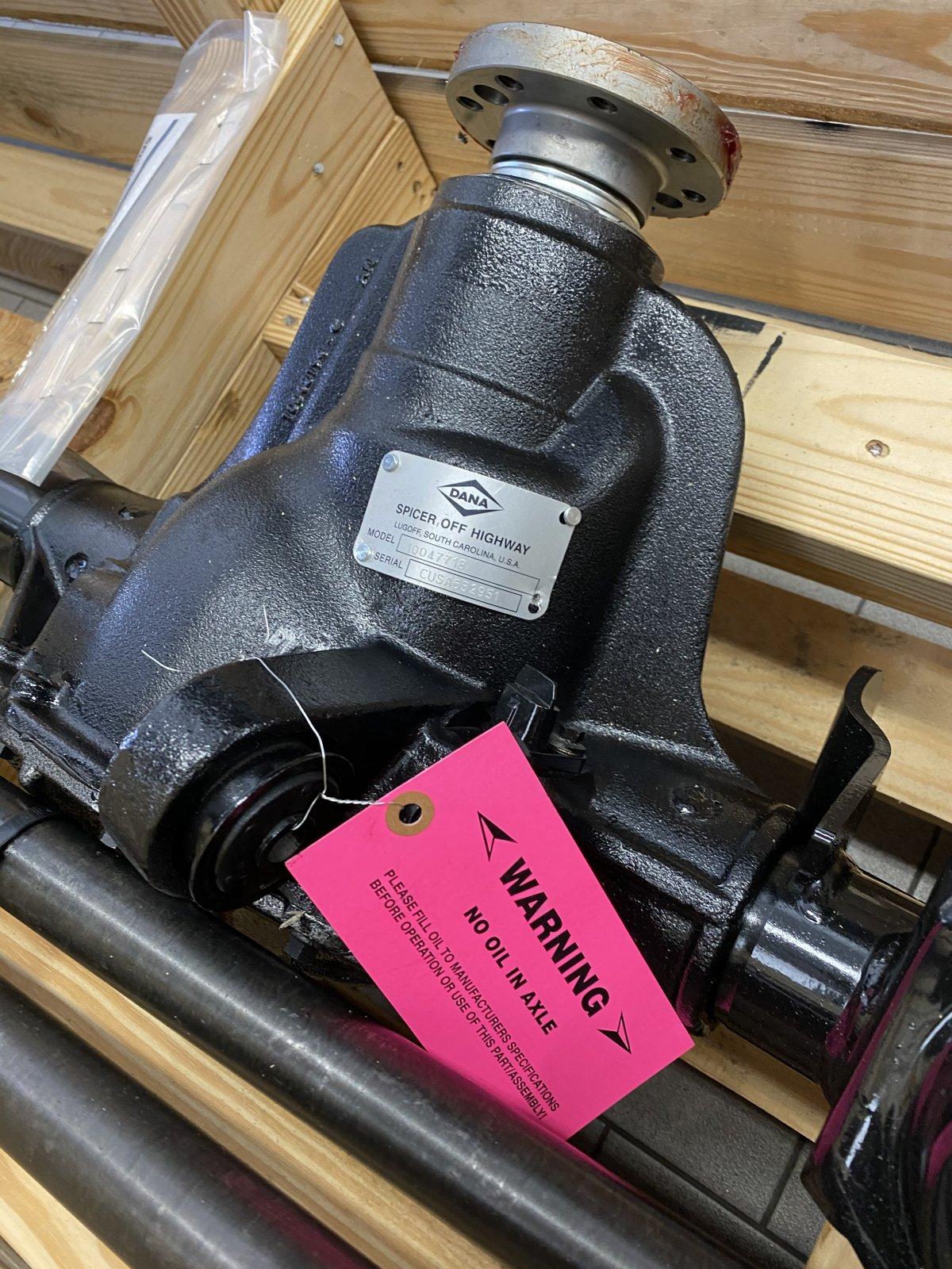

Well my front axle showed up! I got it last week and forgot to post it lol the rear axle is being regeared at After Hours Motorsports in Denton TX! I also wasn’t too happy about paying $60+ on the elocker harness so I just made my own! Works perfectly and only cost me $5!

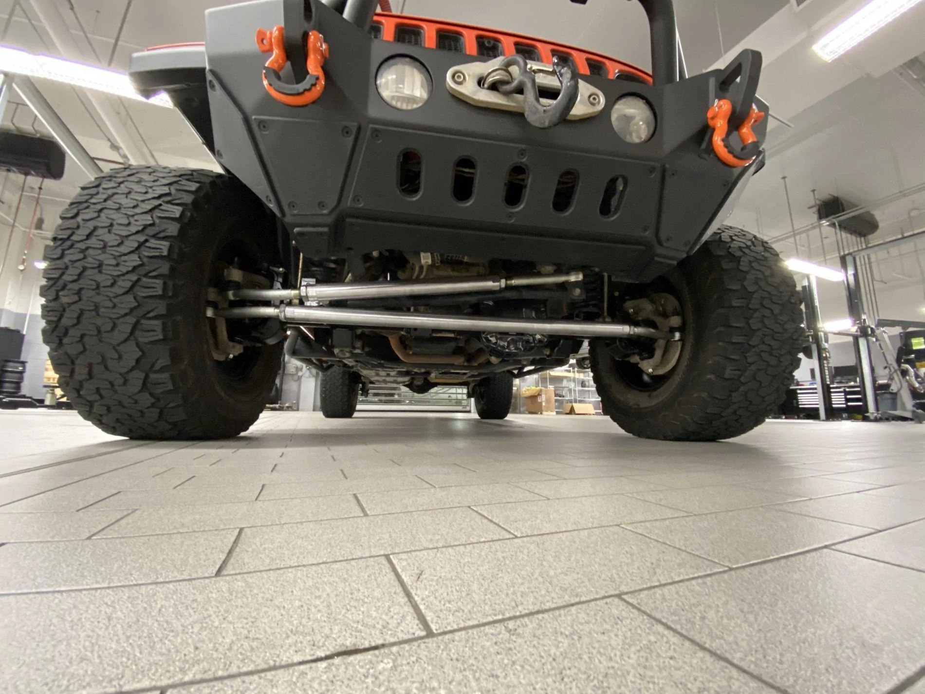

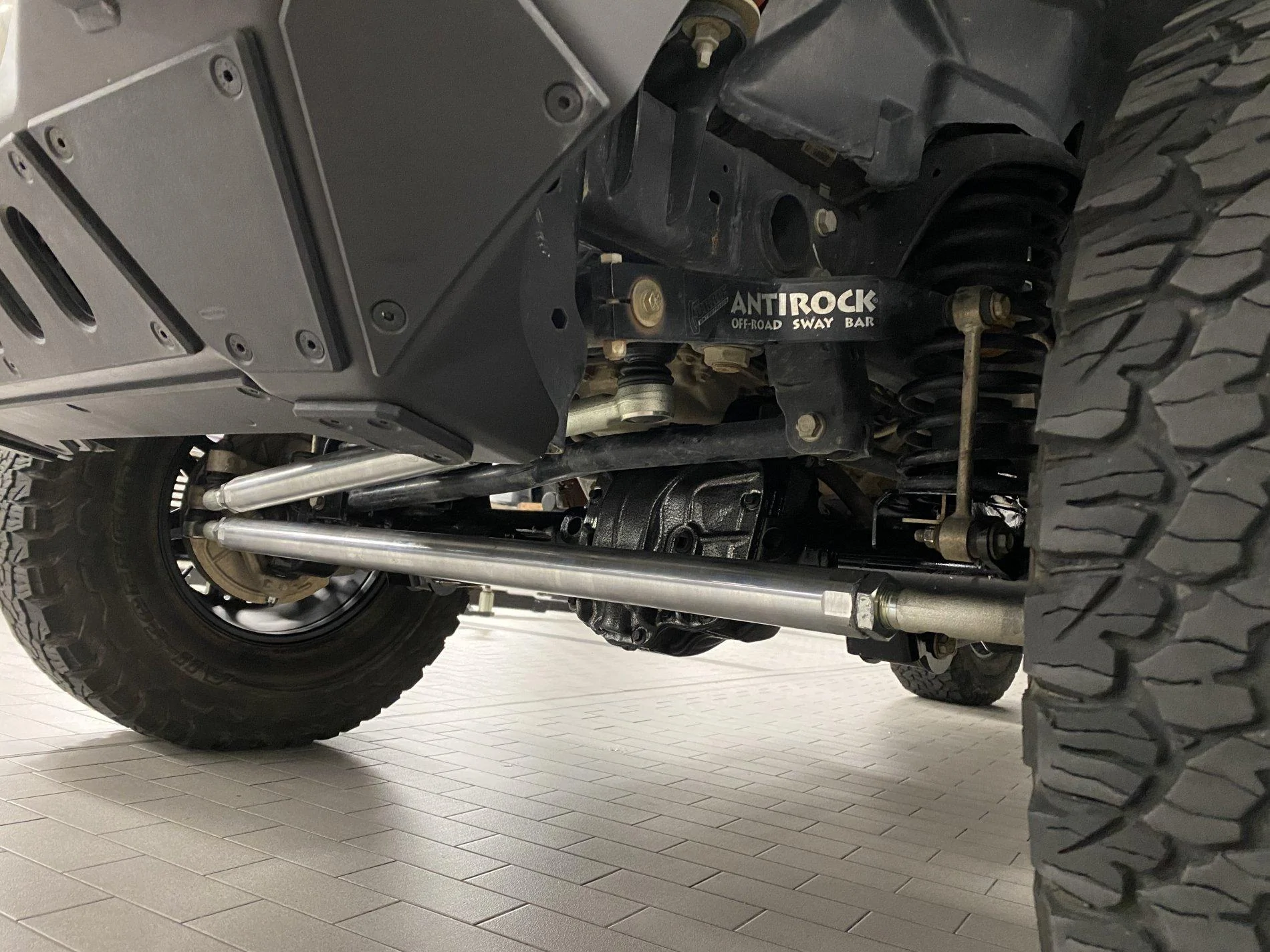

Well I spent all day getting the front axle in and I’m running into some issues with the Ultimate 44. I found that some of the brackets on the axle are a little tighter then the OEM and couldn’t get my passenger side sway bar end link in. I had to grind it down a few millimeters. It fits now! But my biggest issue is that my Fox steering stabilizer won’t fit in the bracket! I hope someone can give me some tips on how to get it to fit.
Looks great!
Interesting about the passenger side sway bar. I helped a friend of mine put this axle on his Sahara and we ran into the same issue. The problem was the outer bracket wasn't welded straight. Even the stock link wouldn't fit. It didn't really matter in the end since we were using JKS quick disconnects; that part of the axle gets cut off to make those work.

interesting. Well I’m glad I’m not the only one with that issue then. Hey was there some nylon washers that came with your kit? I’m trying to figure out where those go
Spank
Mar 29, 2017
2,698
4,590
I think they're shaft guides, but we didn't use them either. Did you have any issues with the zerk fittings? Ours were painted over and came installed incorrectly. The flush ones were on the top and the standards on the bottom. The u-joints of the shafts wouldn't clear the bottom ones, so we switched them.

oh gotcha so it doesn’t look like I really needed them. Mine were painted too but I was able to install it without any issues
Spank
Mar 29, 2017
2,698
4,590
It's a fantastic product, but we were really surprised at how many little things we ran into that hung us up, like the zerk fittings and the sway bar bracket. The axle shafts weren't properly secured in the crate, either, so they bounced around during shipping and scratched the shit out of the axle. All of these things were easy to address and take care of, but these shouldn't be things any customer should deal with considering the price. Nonetheless, we're looking forward to giving this thing a proper beating.

yeah for sure. I would expect the quality control to be extremely good with the price you pay. I’m still happy with the over all quality of the axle
