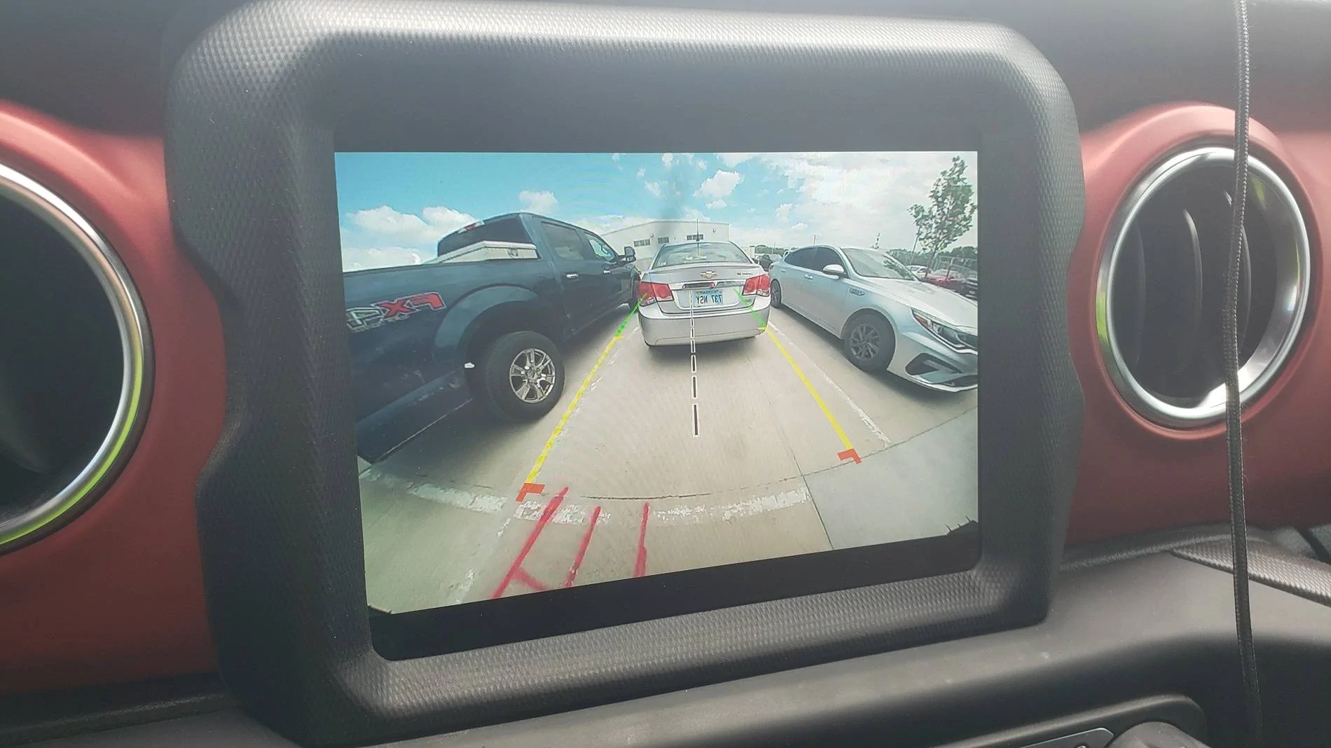

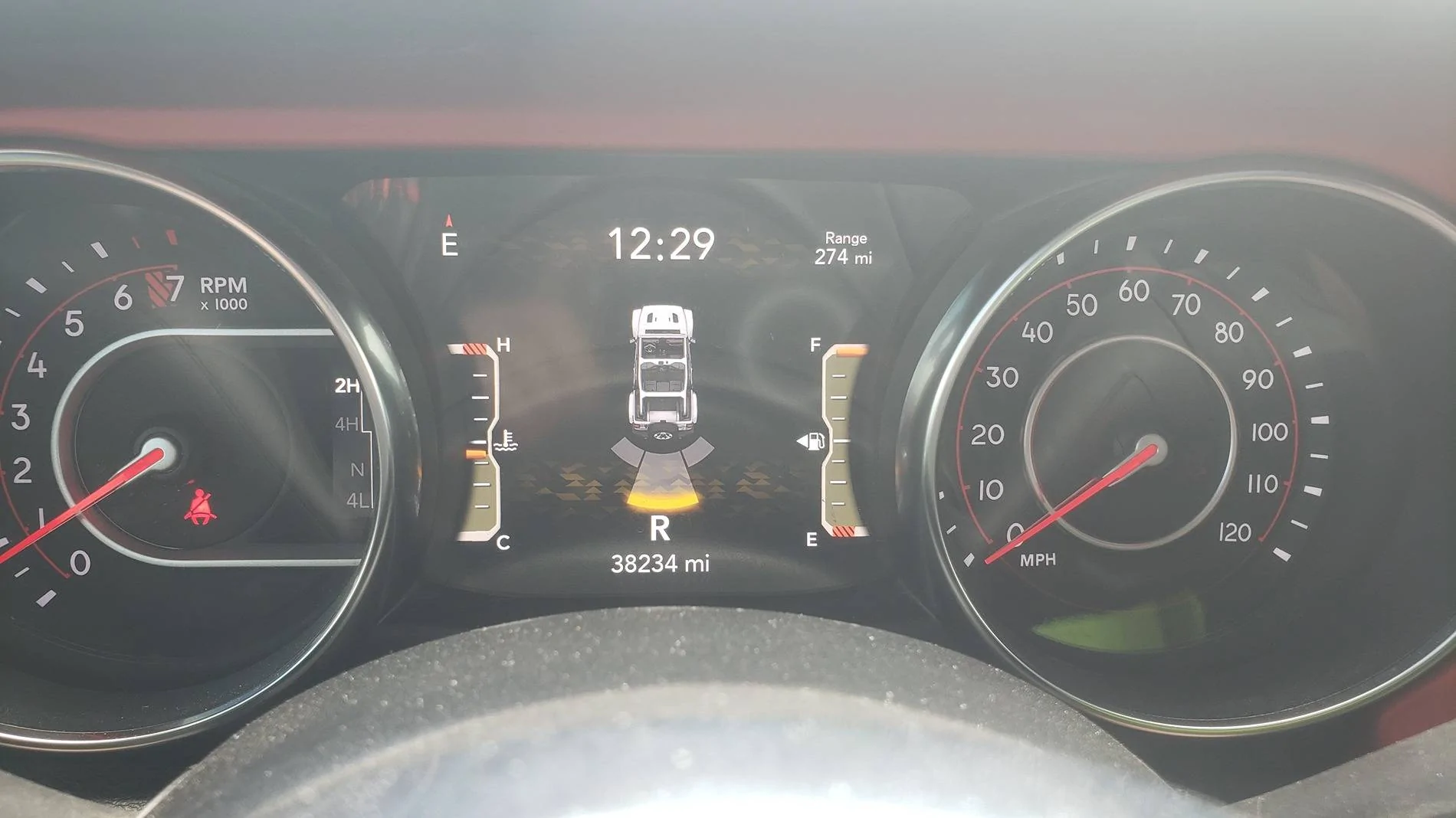

FYI, Just in case nobody has addressed this. here's what it looks like when you have the Blind Spot detection disabled, but the Park Sense enabled. The sensors in the bumper detect & alert us by beeping + display as shown in the pic below (bumper lights up).
Jeep Wrangler JL Blind Spot Unavailable 20250626_122909
Jeep Wrangler JL Blind Spot Unavailable 20250626_122912
