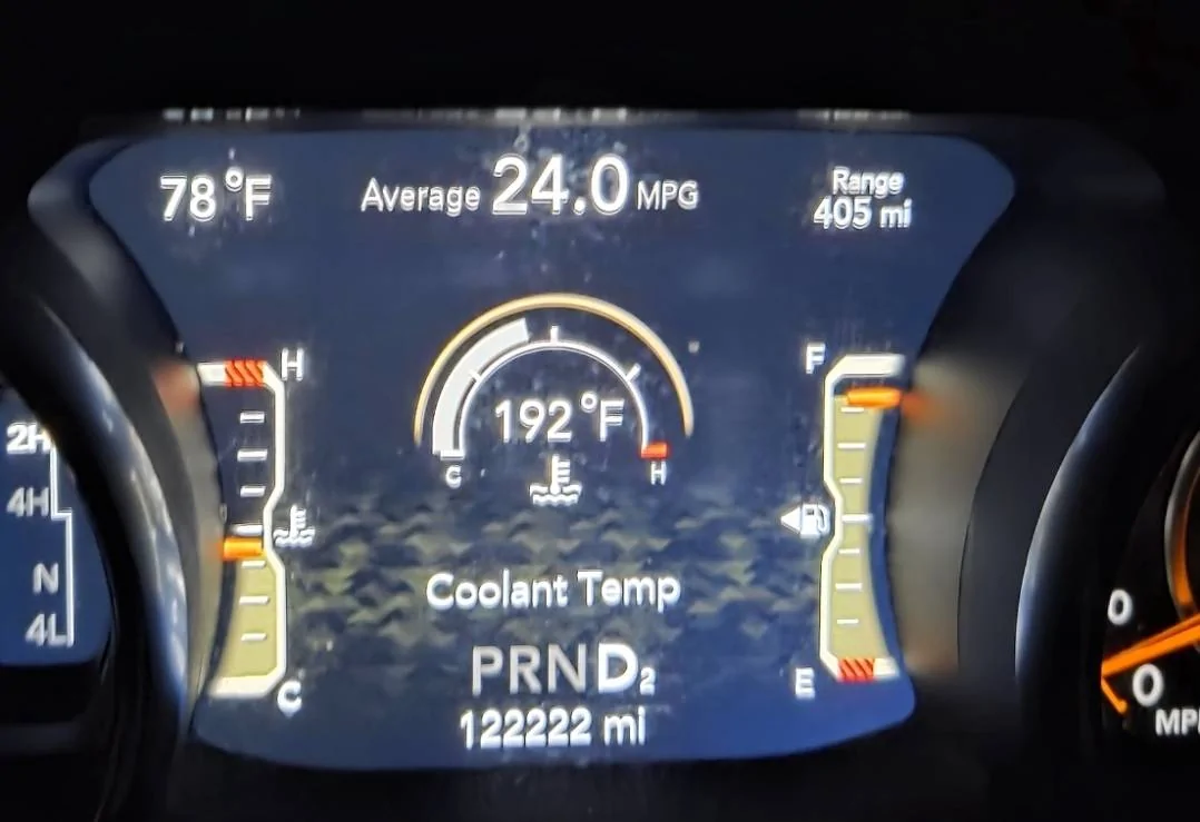

122k miles on a 2021 JLU 3.6L eTorque and never had any problems. I changed oil and filter every 5k miles and I've only replaced the battery, windshield, and tires.
Now this:
Jeep Wrangler JL Bittersweet mileage accomplishment 4360
Started getting random cylinder 6 misfire, so I changed all plugs and coils.
Then starts a mystery coolant leak.
You guessed it - i think it's the head gasket.
Such a shame.
