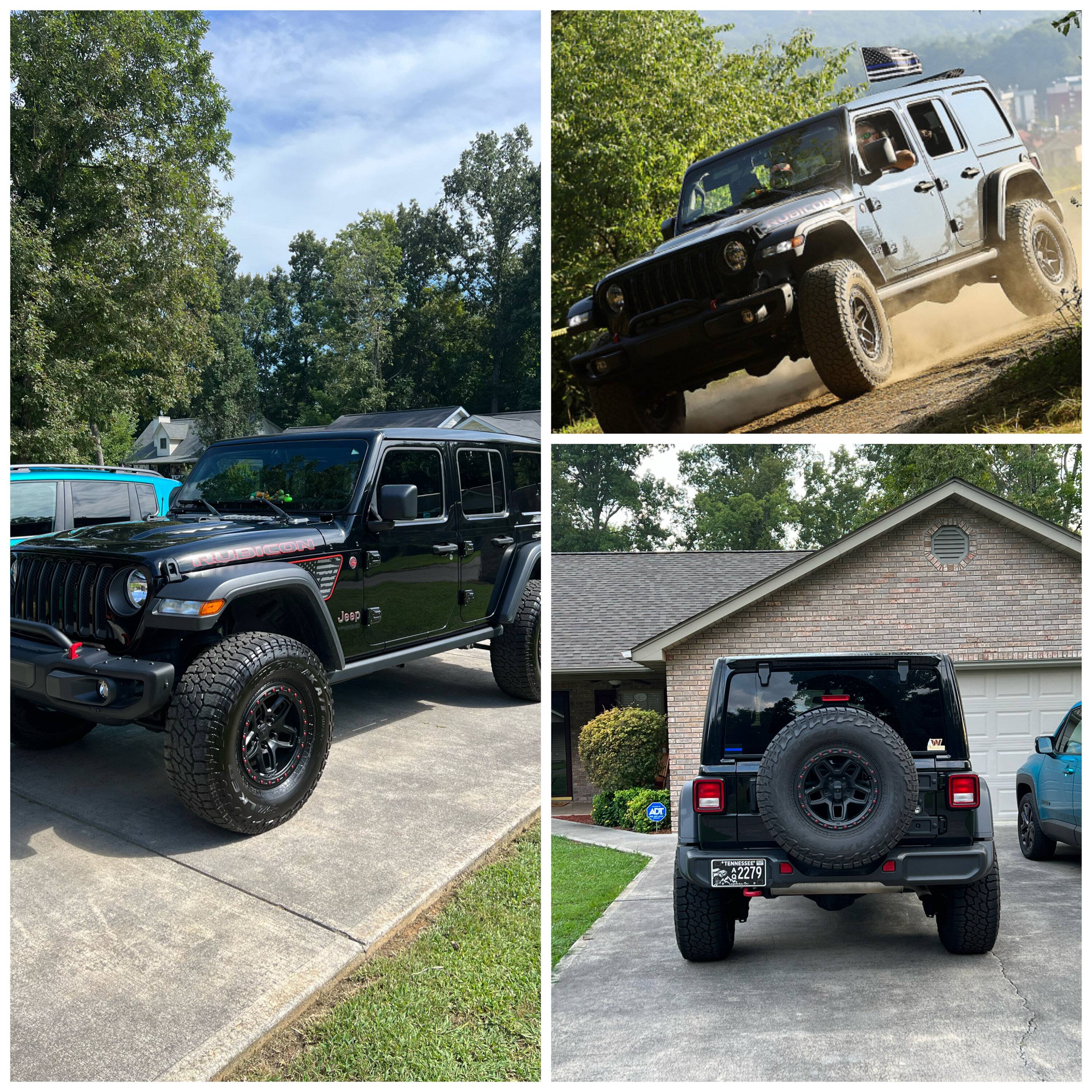

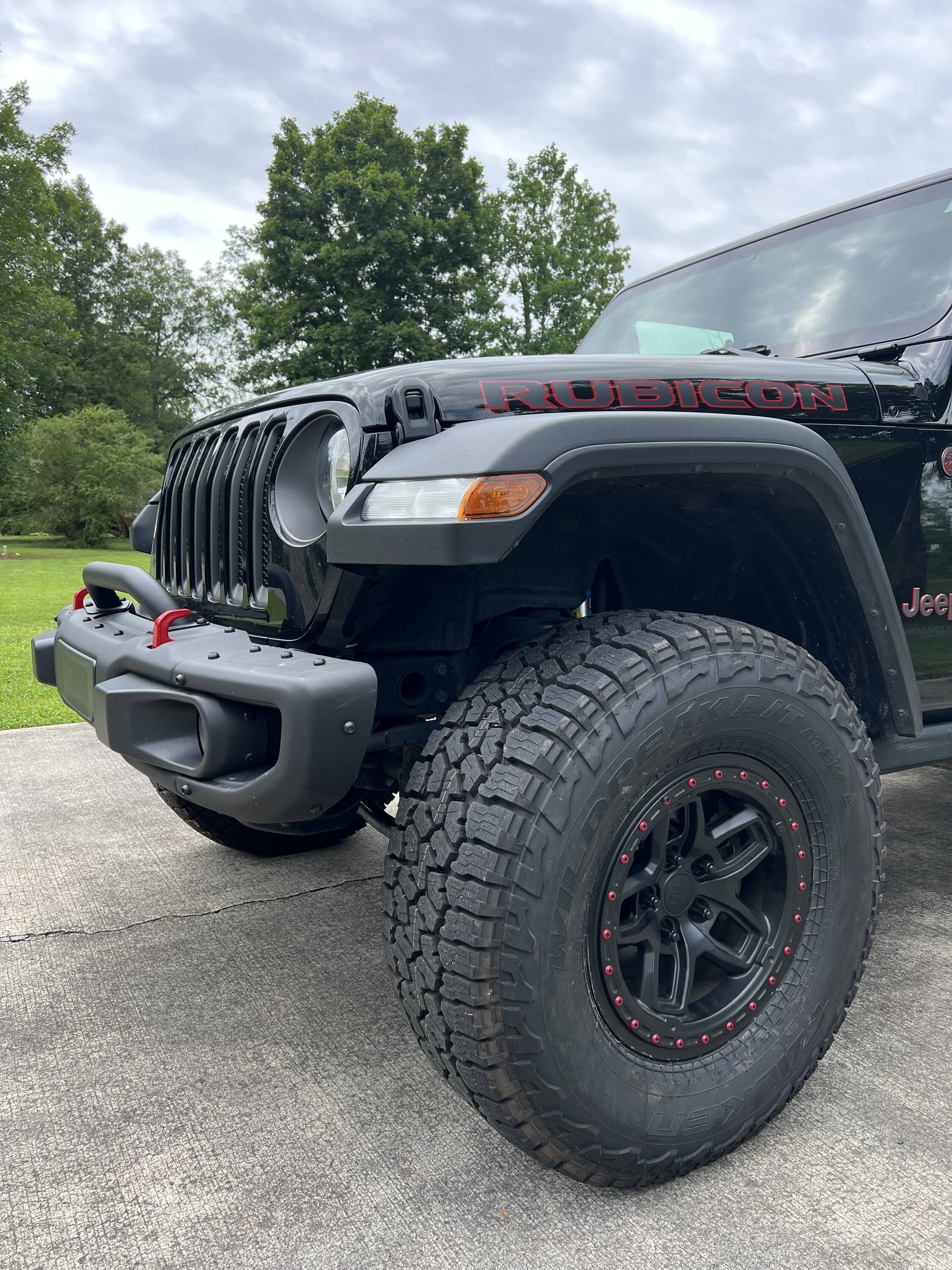

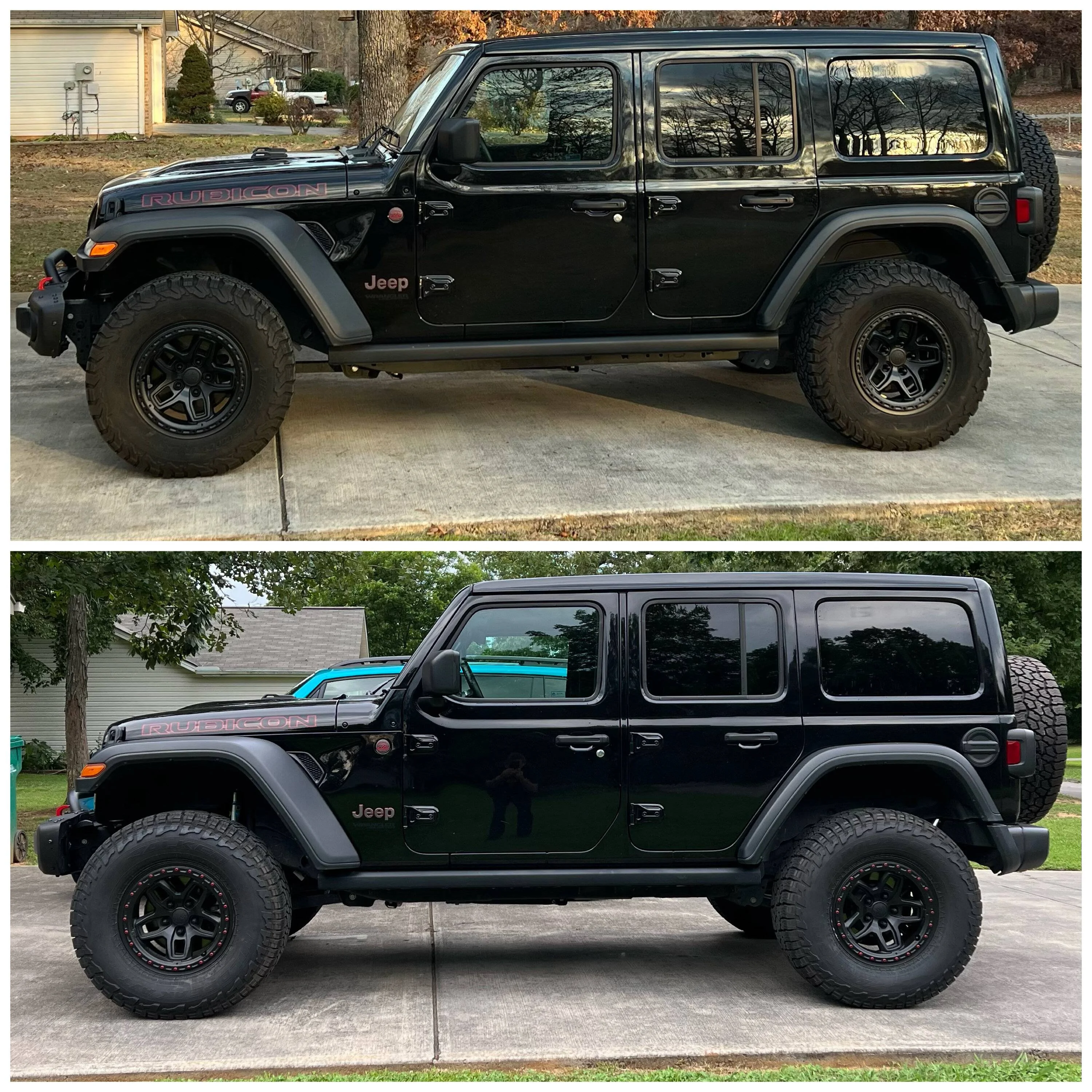

@CopperMtnGuy I installed this kit in July 2023. I must say, after roughly 3K it is amazing so far both on and off road. 2021 Rubicon 2.0 turbo. Running 315/70R17 Falken Wildpeaks on AEV Borah wheels. Rides better than stock in my opinion.

Looks great! Did you add any other parts, like longer LCAs up front, different track bars?
I may add some other parts down the road. At highway speeds there is slightly more wander. But Jeeps all seem to have that. Not sure what would help with that. Thought about LCA’s, or maybe that synergy sector shaft brace.
