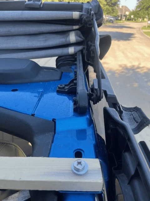

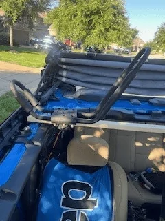

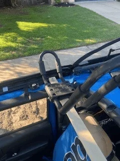

I have a 2 door soft top. I noticed a pair of unused hard top bolt holes in my upper frame rails, so I found the proper threaded bolts at Home Depot, cut a 1x2 to the right length, and now I can use my kayak racks. The racks hold the kayak secure left to right and I tied the front and the back of the kayak to my front and back tow hooks. It was stable at 70mph. The back of the kayak rides on the folded back metal bar from the front of the sunrider.
Obviously this only works with sunrider open, and/or top fully down (at which point it would ride lower, haven't tried it with the windows out and top down).
