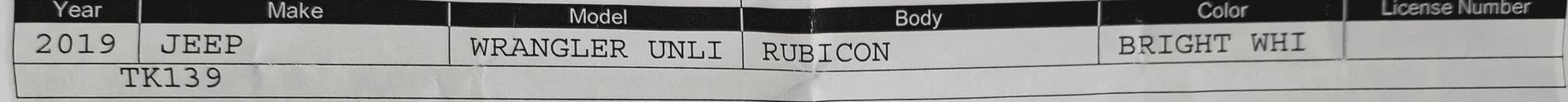

Latest update (6 hours later, only one technician trying to use his ear to locate it): Dealer found the issue of the "Pew Pew Pew" sound...it was a dealer installed (from another dealership) tracking device alarm...problem solved...yeah.

Interesting! Thanks for the report pic. I’m gonna try and find out if I have the tracking device in mine. Haven’t had the sound in a long time though

No problem, by the way, at the top of the report it mentions "TK139", maybe someone here that have access to the dealer system can look it up and tell us what brand this is maybe a "TK Star"
