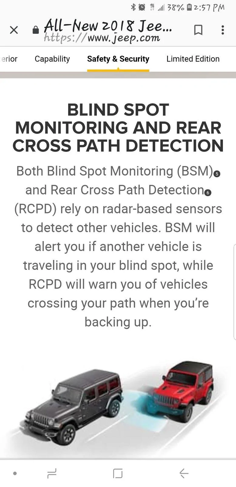

I only have 500 miles on mine and it was 3 definitive beeps like nothing else I've heard in the car. not a seatbelt chime ,not a USB connected, etcetera etcetera however, I did find this and the only reason I'm thinking it was this is because both times I was turning and close to an object and the other time was quite a sharp curve in the road and there was something close to vehicle .so I'm going with the "BSM"
