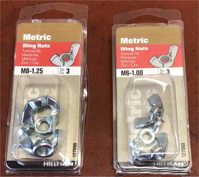

@scuba_steve_21
M6-1.00 Flange Nut. The other you will find on the battery is an M8-1.25
You can use a Wing Nut for quick release.
Thank you so much for confirming this and for the quick release options! Luckily my Jeep is drivable, so I can head into town and grab me this. Really appreciate the reply, you just saved me a headache!

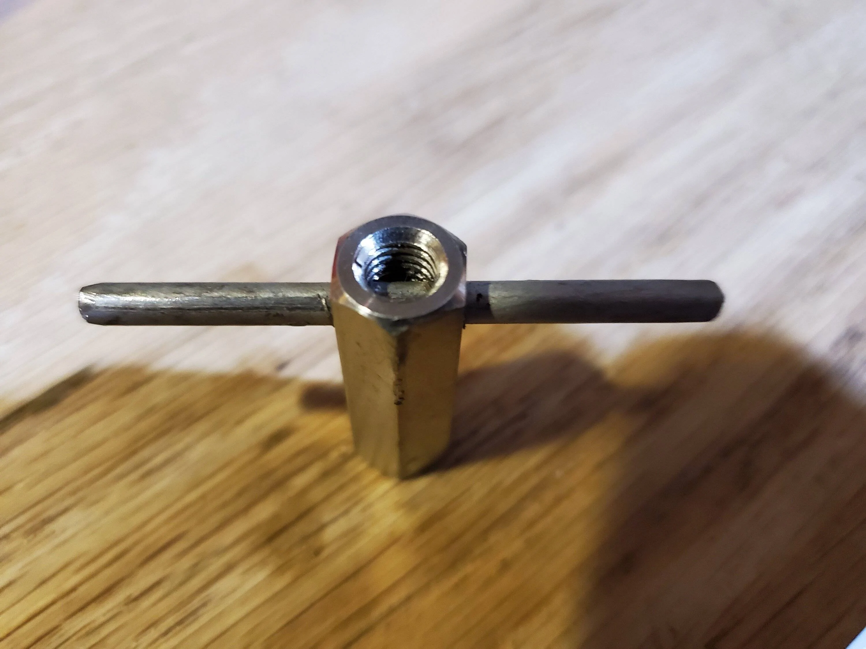

I also make these up for as a quick release option..
That is pretty dope! I am not anywhere skilled to pull that off but that is sweet!
Actually, it not hard to make up. You just drill a hole into a coupler and hammer in an aluminum nail into the hole and then saw the head off of the nail.
