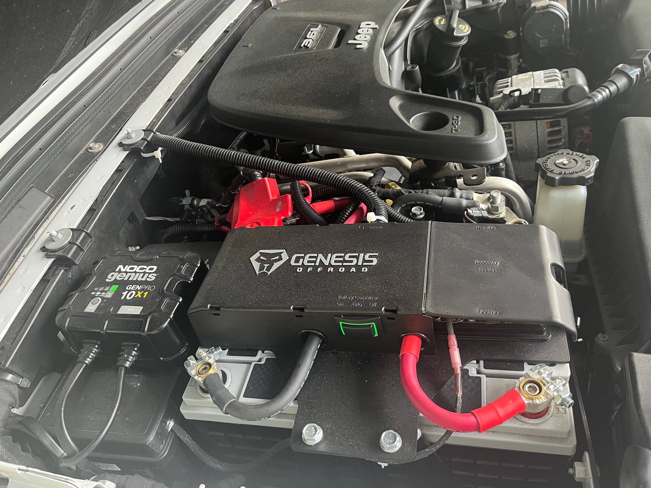

I did the genesis system couple years ago then upgraded with the new system 3 and purchased the full river batteries. Still going strong. Expensive but worth it and everything was ordered through Genesis off road and arrived super fast. I also installed the g-screen and the sensor wire that runs to a tap in the fuse box. Watch the video from Genesis and you can't go wrong. What ever battery you choose, charge them over night to 100 percent prior to install. I also installed a on board noco charger/maintainer. I think you will be happy with the system. If I can do it anyone can.
Jeep Wrangler JL Battery Group 25 Popularity/Choices/Availability? IMG_2029
CarbonSteel
CarbonSteel
Jul 21, 2019
305
5,795
8,214
