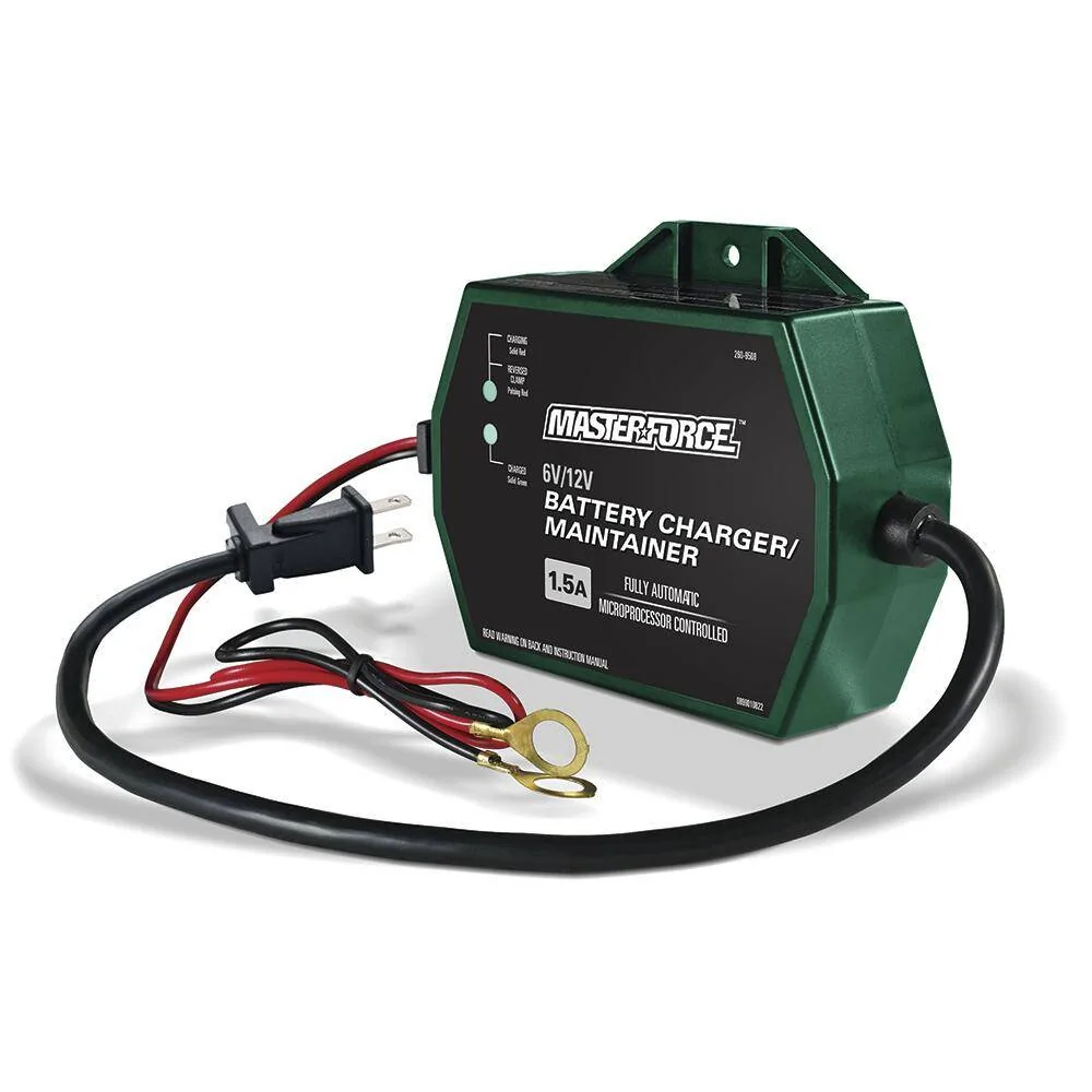

I use a cheap tender from Menards.
Its attached to the wall and stays plugged in.

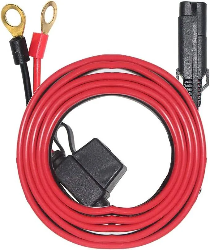

Than I got a long lead off amazon and attached it to the battery.
When I pull in I plug in and forget it.

Problem with a 1.5 amp tender/maintainer is that such a low amp tender/maintainer drops the ball in regard to the Main battery.
Perhaps @OldGuyNewJeep will clue you in on this as a low amp tender maintainer bit him/his JL.
Also... is this tender/maintainer meant to be used on AGM batteries?
Suggest you get a decent battery tender maintainer. Go with a 10 amp one. i.e. Noco 10 battery tender / maintainer or other..

I rigged this set-up because I suspect the secondary is already not holding a charge and is draining the primary.
This is keeping my stock batteries charged. When I pull in the garage the batteries are charged within an hour.
This charger is rated for AMG batteries
I have a similar set-up for my 70 GTX since it only sees the light of day a dozen times a year.
