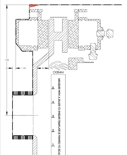

So this Baer kit has been out a while with no info on here that my searches show.
I did the test fit print out and checked my 22-392 XR wheels and it looks like it clears with only the very inner corner of the print out showing a little less clearance than they recommend. The printout has 1/4" clearance around the top of the caliper. I show 3/16" clearance at the caliper top corner closest to the wheel face. I confirmed dimensions on the printout with calipers.
Not a 14" rotor but 13.5" with 6 pistons seems like a great option especially if wanting to keep my older XR wheels.
Anyone with info on this kit?
