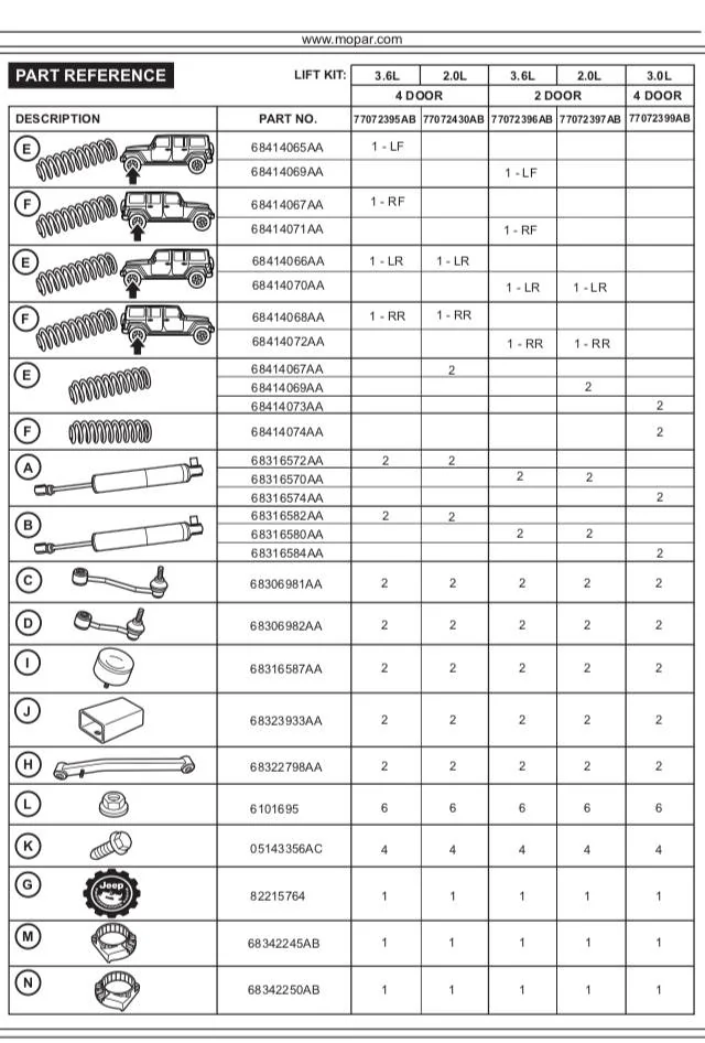

I think with the Mopar JL lift they make the driver and passenger side coil springs different heights to account for the gas tank weight (I could be wrong). If that is the case and if you put the wrong spring on the wrong side, that will make the passenger side droop even more. If that is the case, the shop may not realize that it is the spring and are blaming the sag on the shock. As far as the sway bar links, just check them to make sure that you tightened the bolts on them.

Take a couple quick pics, and post the part numbers on the rear springs.
The springs for the Mopar lift are side-specific. Here's a chart.
Jeep Wrangler JL Bad Mopar Lift? Mopar lift part numbers
