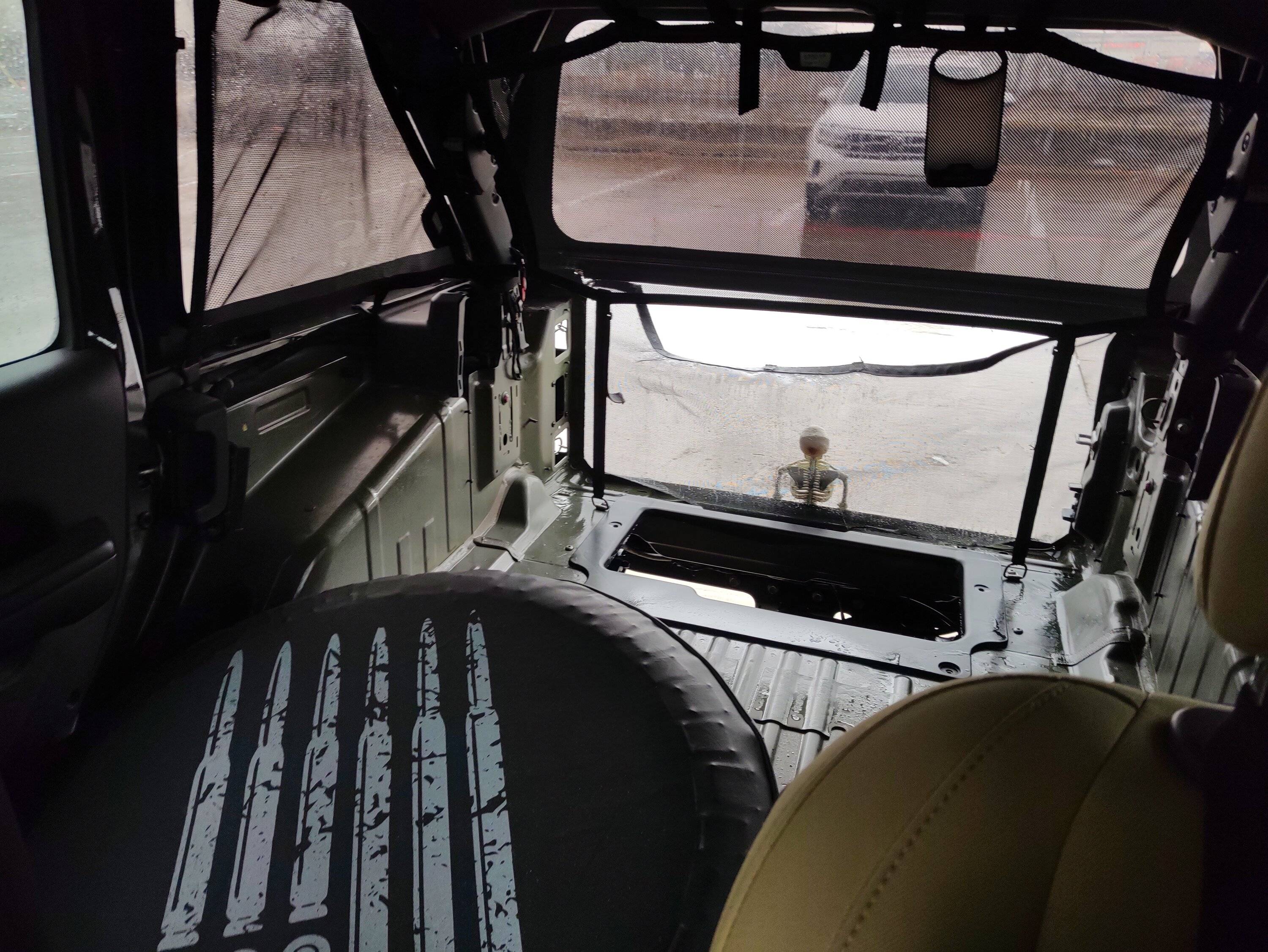

You could always do what I did and remove your rear seat completely. Unless you have kids or regularly ride with family members and friends, they're kind of overrated, back seats are. Open up a lot of free space if you get rid of it.
