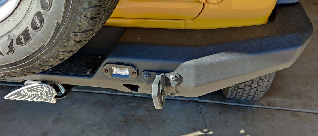

I put LED lights in my Quadratec bumper, perhaps you could put them in your stock bumper if you plan on retaining it.

Thats basically what I did, I also wired them to my aux switch so I can turn them on when hooking a trailer.
