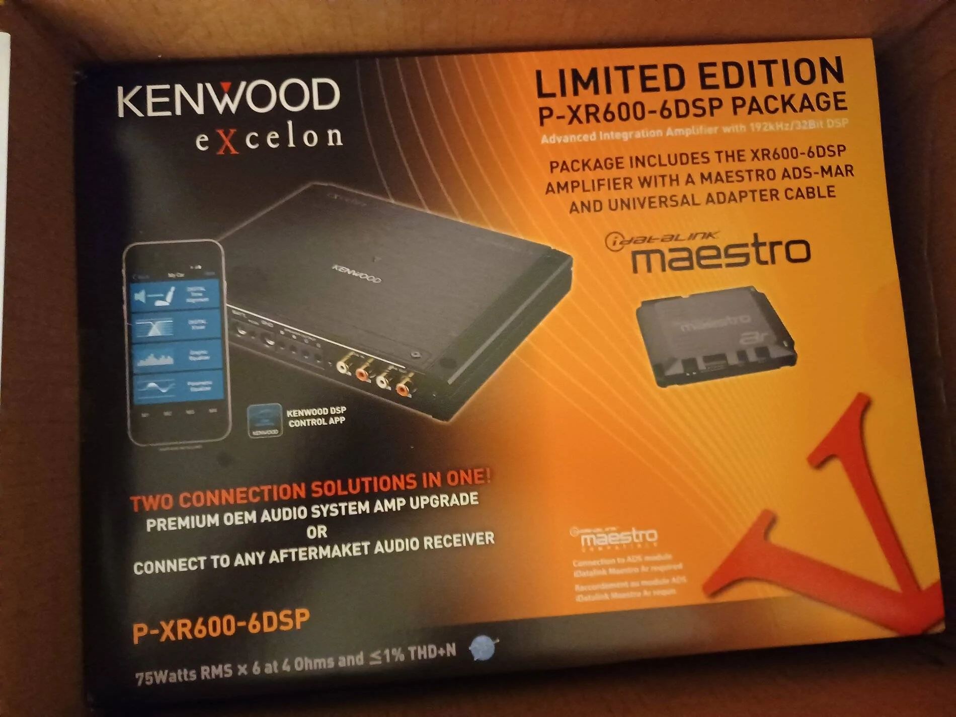

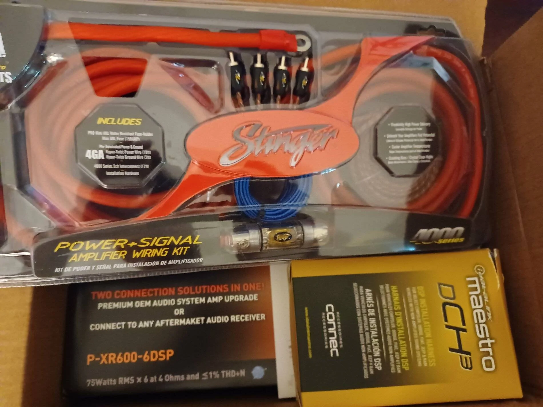

In the past whenever i did an audio upgrade i usually started with the speakers and the added an amp.
However is saw this and it was too good of a deal to pass up. the specs to the AMP are below, and it is being installed next Monday. The shop installing this has done this in several Jeeps.
The one caveat though is when running in 5 channel mode channels 1 - 4 will receive about 75 watts (should be more than enough power in a JLU) channel 5 will receive about 200 watts (should be good enough for my pioneer 12" shallow mount sub, but probably not good enough for a 'bass head" running JL's). The amp has Kenwood's DSP built in (EQ / time delay / X over points / etc). I will be using high Xover points at first in order to save those "quality" Mopar speakers.

| Power Output | 6 channel Rated Power at 14.4V | 75Watts RMS x [ch] (4 Ohms, 20-20kHz, ≤1.00% THD) 100Watts RMS x [ch] (2 Ohms, 1kHz, ≤1.00% THD) 200Watts RMS x [ch/2] (Bridged 4 Ohms, 1kHz, ≤1.00% THD) * Bridged connection available CH1 & CH2, CH3 & CH4, CH5 & CH6 |
