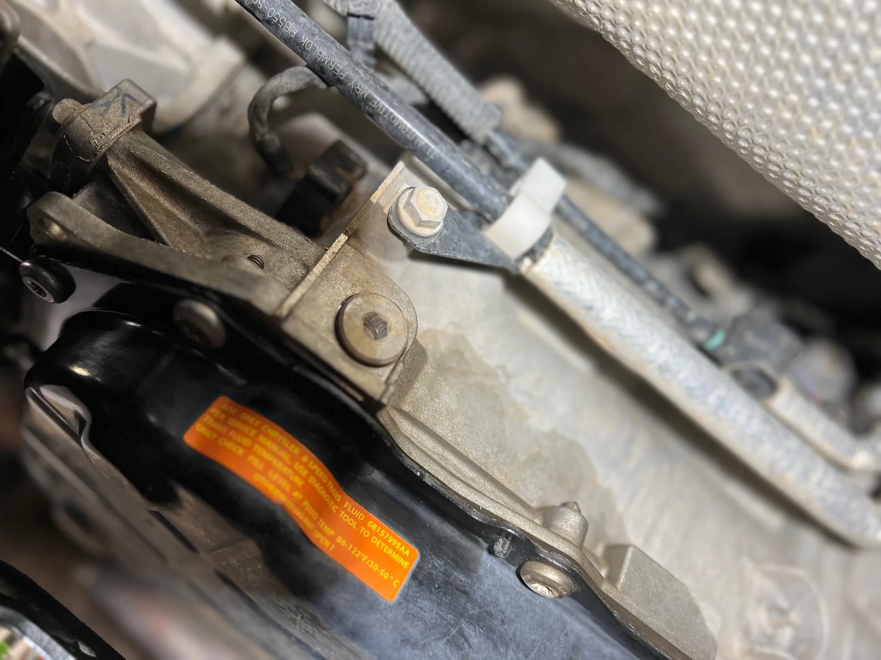

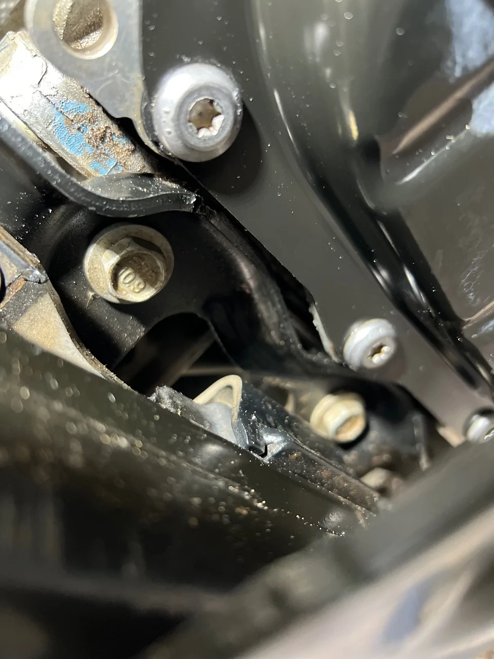

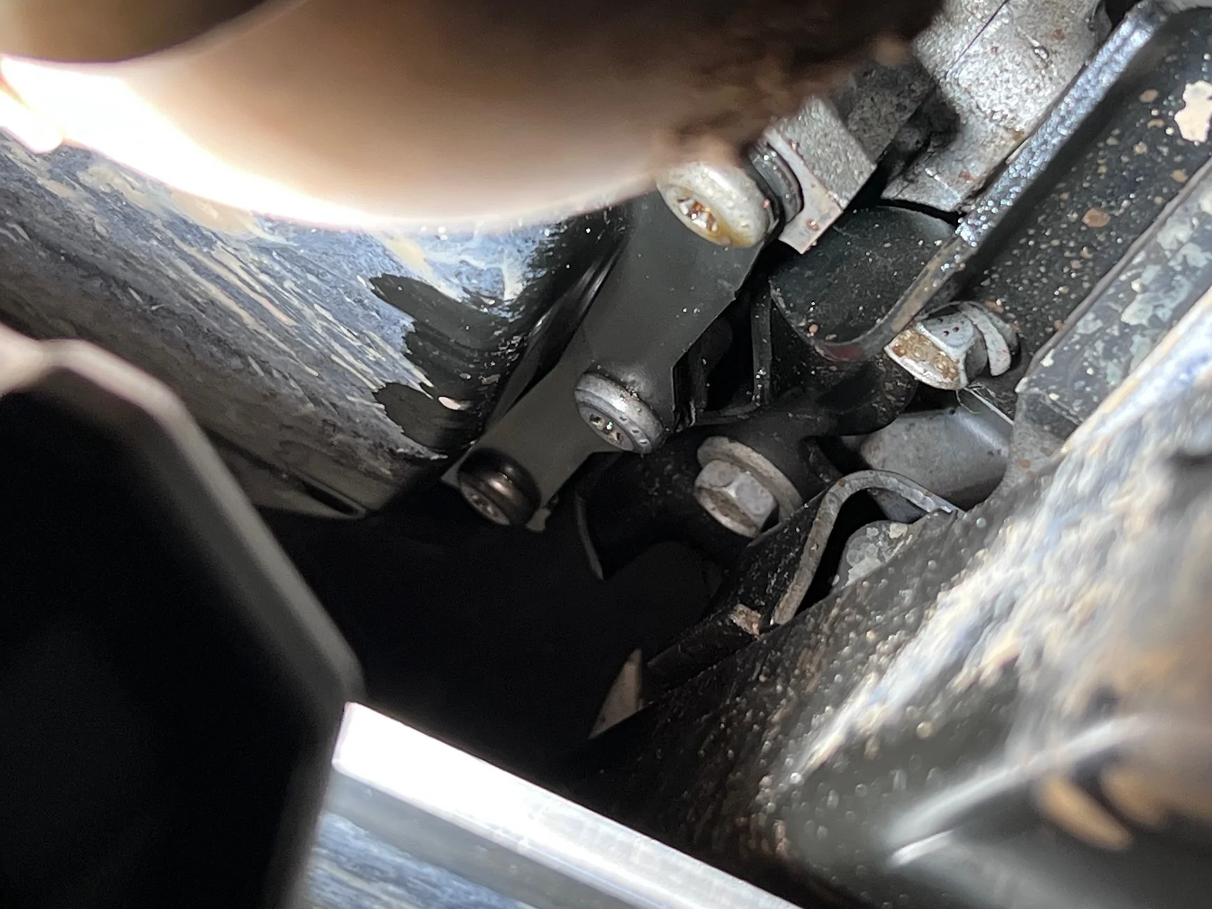

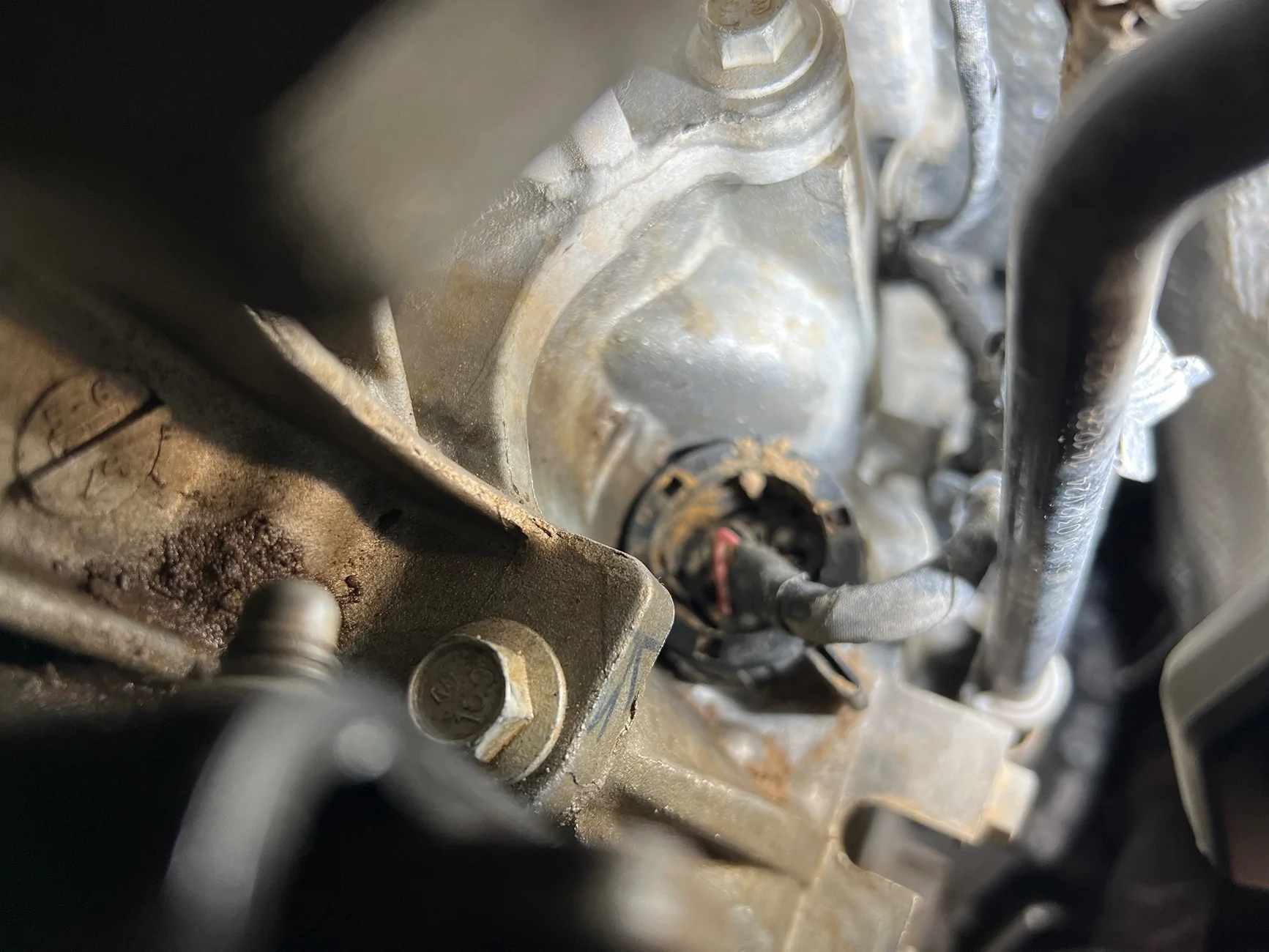

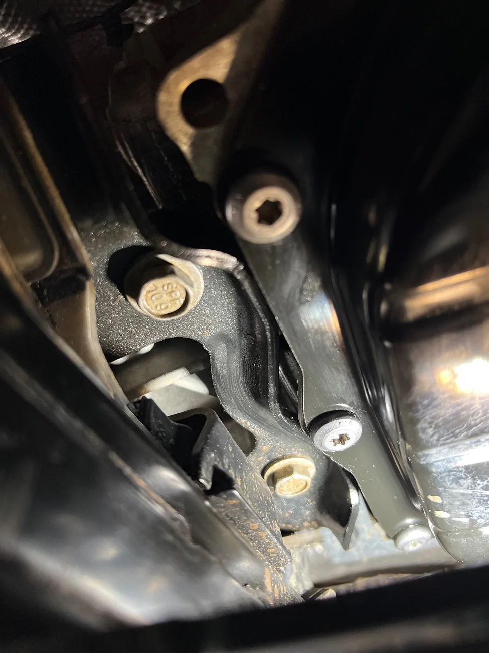

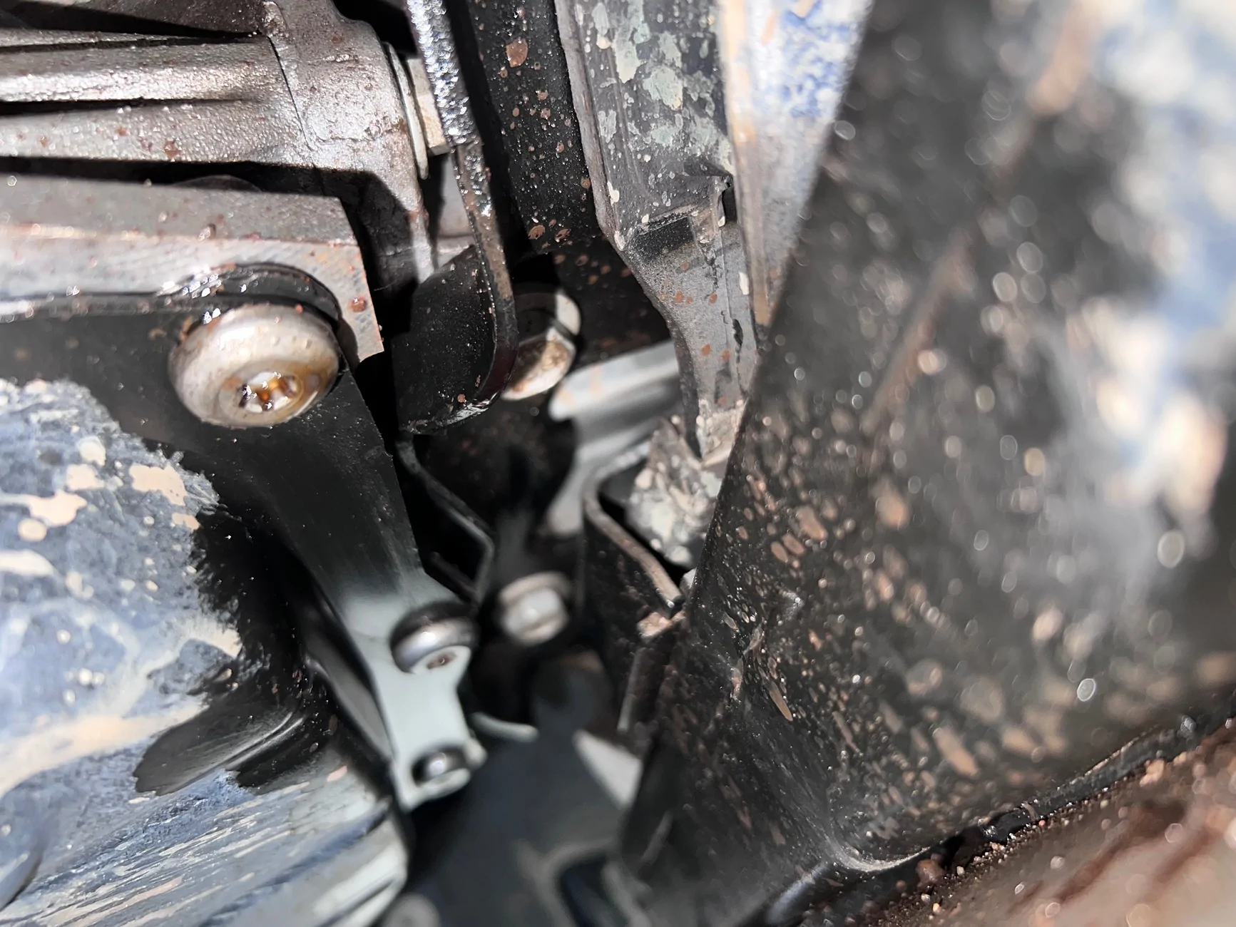

I was doing an oil change at 11K miles after a road trip and noticed some ATF seepage on the pan bolts and housing. I wiped it clean and did the post-oil change test drive and nothing re-appeard. I have no idea where this came from. Anyone have any ideas? it's a 2024 Rubicon 3.6l with 850RE.
Edit to add: the fluid was red. that's what made me think it was ATF, but is the ATF actually red in these?

2025 JLUR, 3.6l/850re, with 5k miles is at dealership now, for the second time, for this issue. First time, a few weeks ago they said they replaced the tranny pan gasket. Seems even worse now. I too noticed it when doing oil change myself. Hoping this time they figure it out more better.

Took them most of the week to get it into a bay...smh. I'm being told it is a bad front seal which is a seal between the tranny and transfer case. Getting told part is not available and could be end of month before they get it. WTF Jeep. Case now opened with Jeep.
