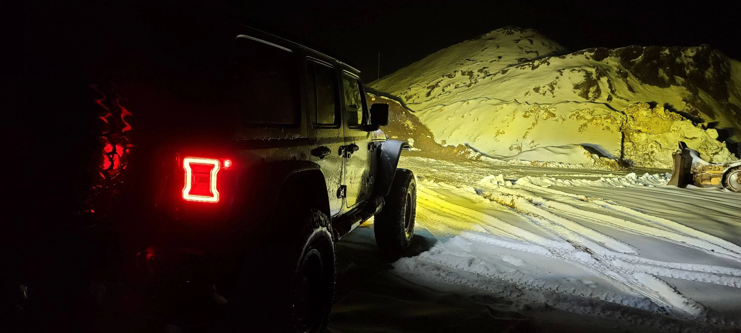

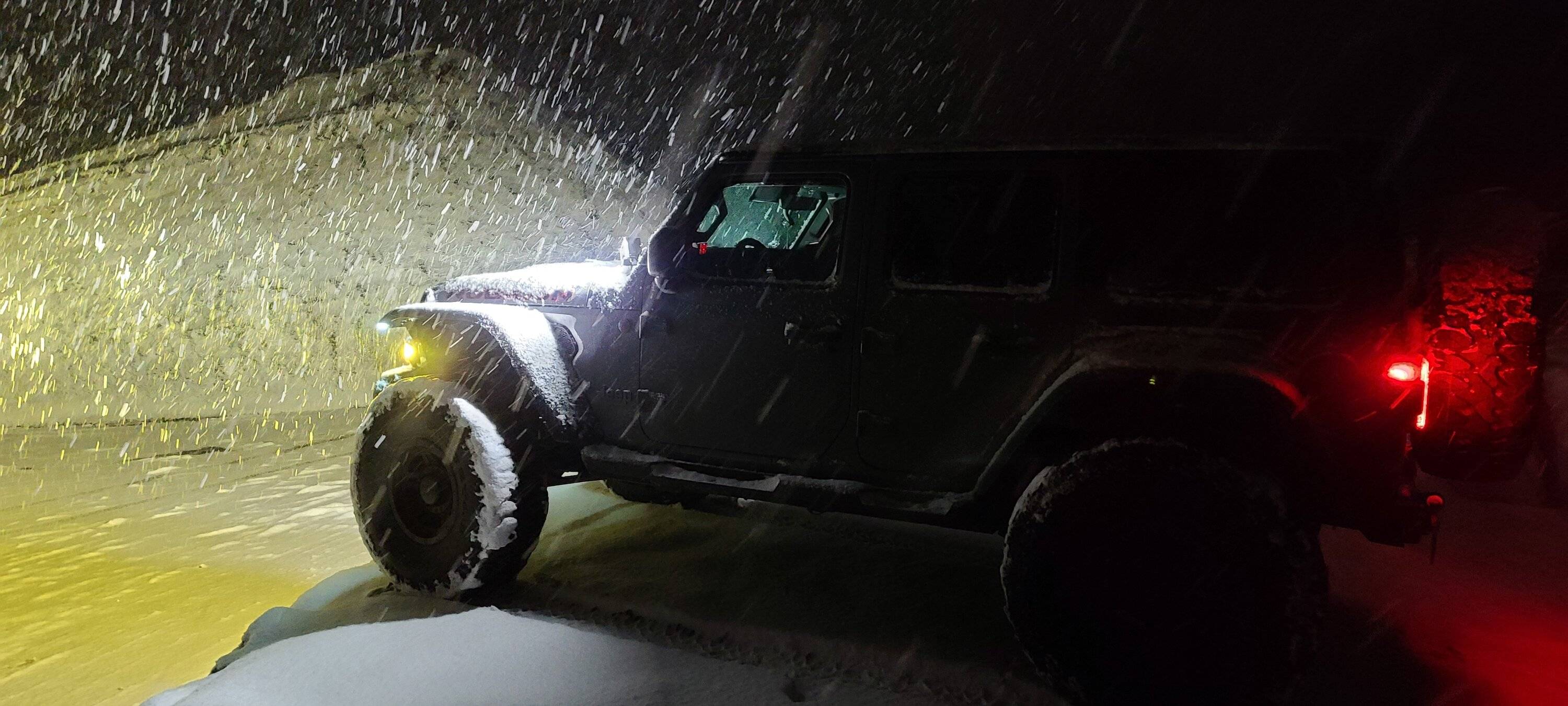

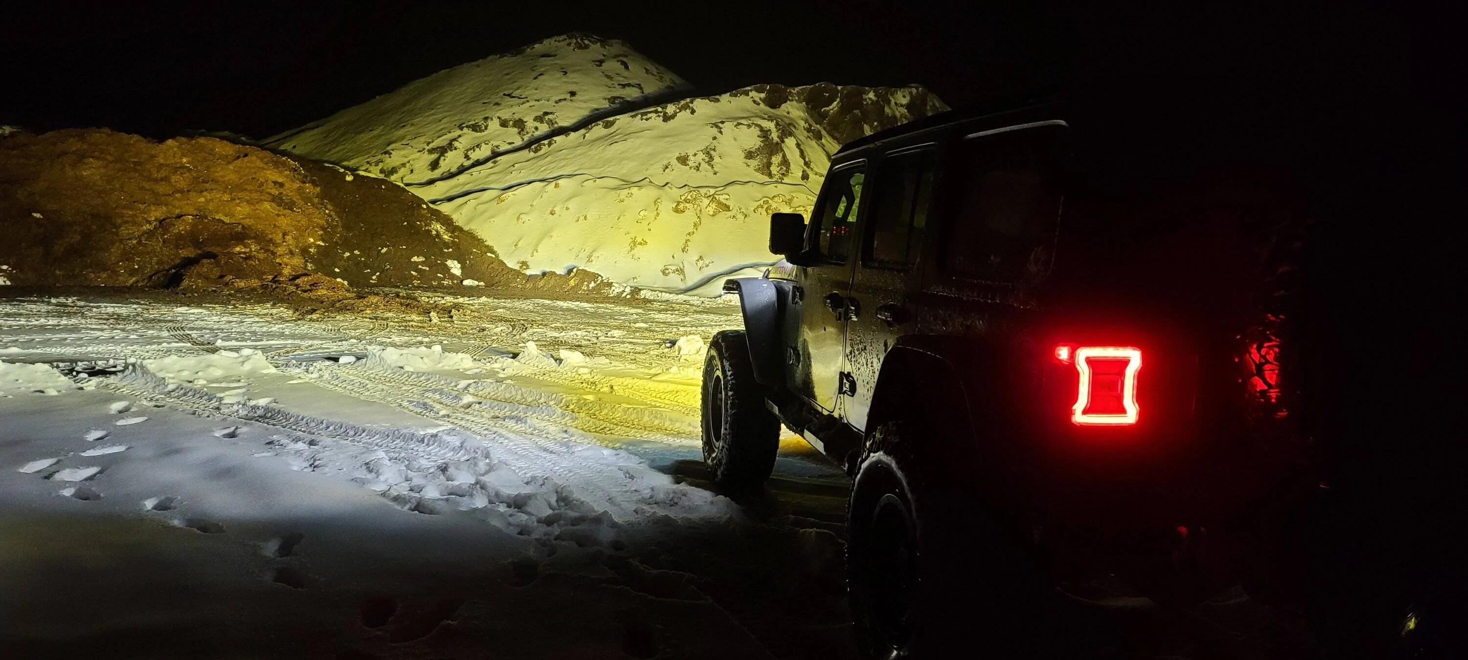

I know you didn't ask me, but I've added multiple BD lights to my Jeep that all cover different purposes. I personally recommend a set of Squadrons with wide cornering lenses mounted in front of the a-pillars. I have mine angled about 45° outward and slightly down to serve as flank/ditch lighting. It also places the light source behind the front end, which helps to see where and what I'm turning into.
Here's some pics that show the coverage off to the sides, including what the tire is aiming at. I wanted the brightest light, so I opted for the Squadron Pros. If not needing maximum lumen output and wanting to spend a bit less, the Squadron Sports also put out a good amount of light.

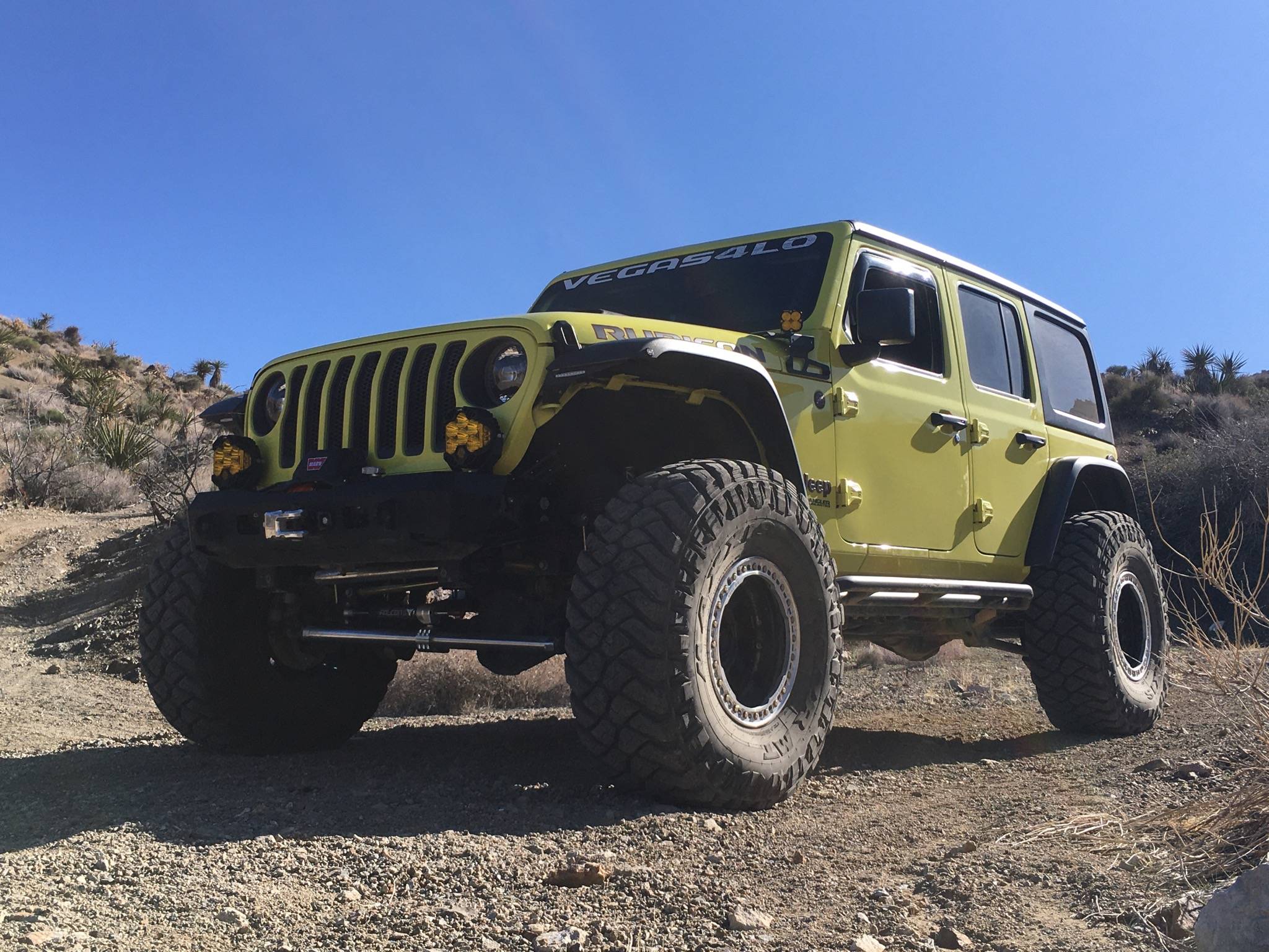

Just a quick shoutout for BD making quality products that work amazingly well. My last JT build had a different big brand set of lights and wasn't happy with them. On the current JLURD build, decided to try out BD, as pictured, 2 LP6's driving combo for the front and a pair of squadron pros for ditch lights.
For myself, didn't want to have to mount 8-10 lights to get what I wanted/needed for frequent night runs I host and BD delivered exactly what I needed. Thanks again..... Should probably get a night pic haha.
