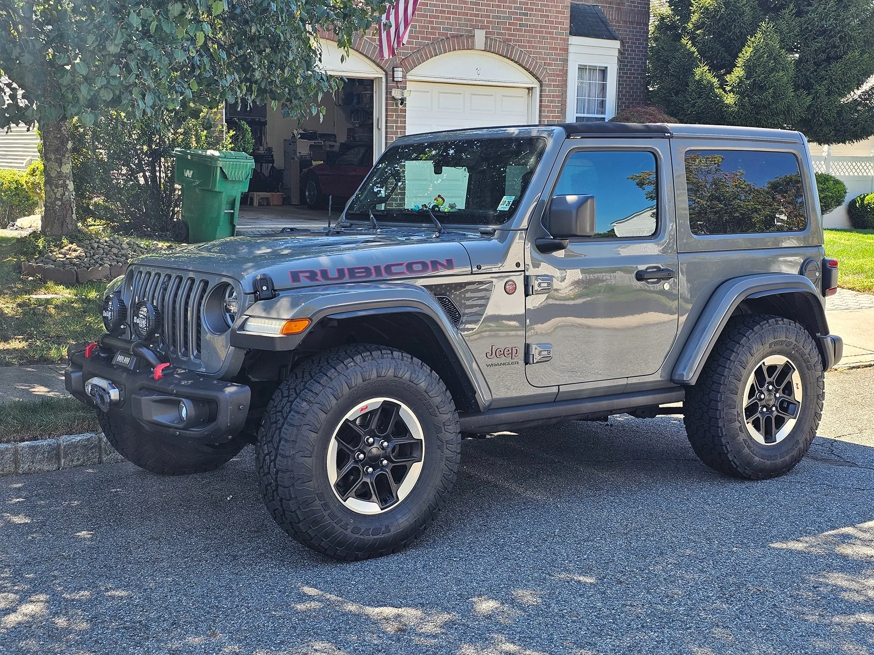

My Rubicon came with what they called "upgraded" wheels. IDK why though, to me its just different color scheme, the specs are the same.
Jeep Wrangler JL Are these Rubicon Wheels? 20250822_140025
AFAIK there are no completely black "Rubicon wheels".
And as it was mentioned before, the marketplace is full of practically new takeoffs that people just drove home from the dealer.
Also, if I were shopping for new wheels at 250/wheel, I wouldn't even think of those stock wrangler wheels. There are plenty of aftermarket options that are better in every aspect.

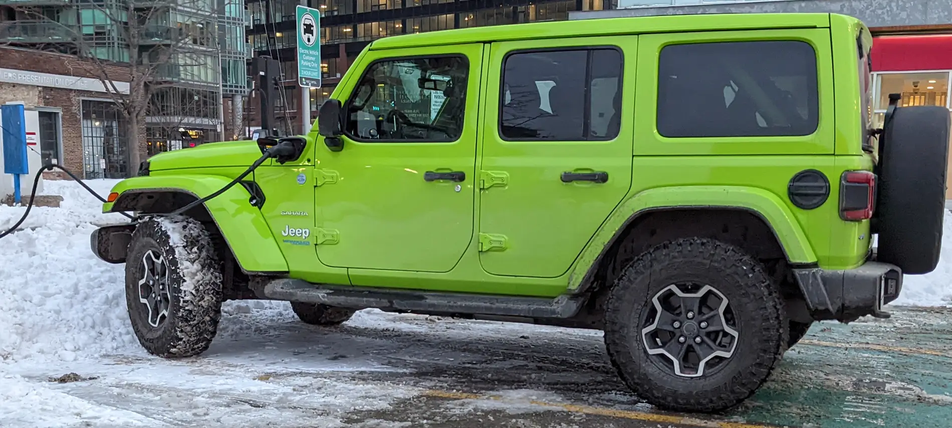

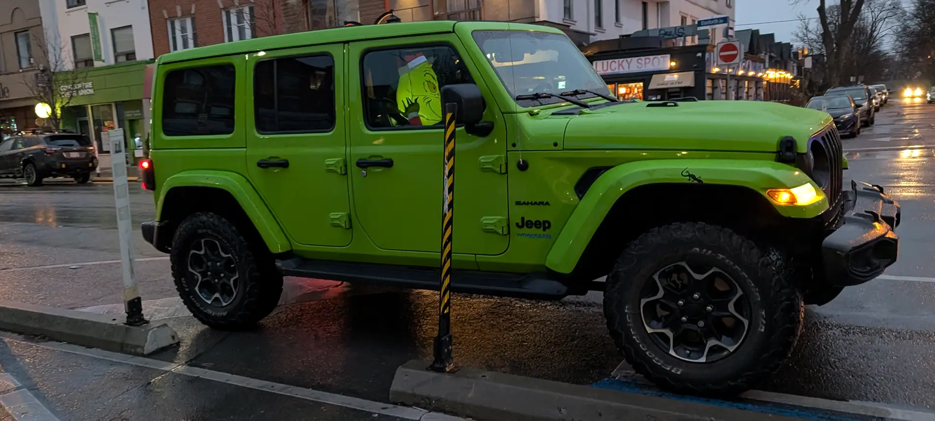

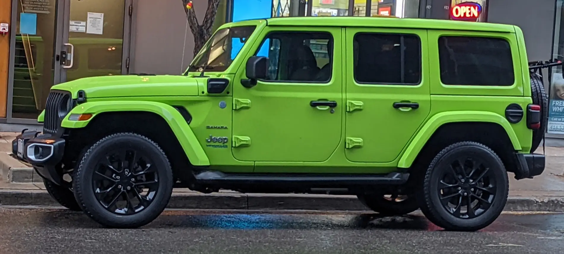

Subtle difference, but my '23 Rubicon wheels look like this:
I had both styles, the top one I got it off a Rubicon Gladiator(2020 I think), it had Falken Wildpeak MT, the bottom one I got it off a 2021 Rubicon 4xe K02.
The last image is the original wheels the 2021 Sahara 4xe was shipped with 20" rims.

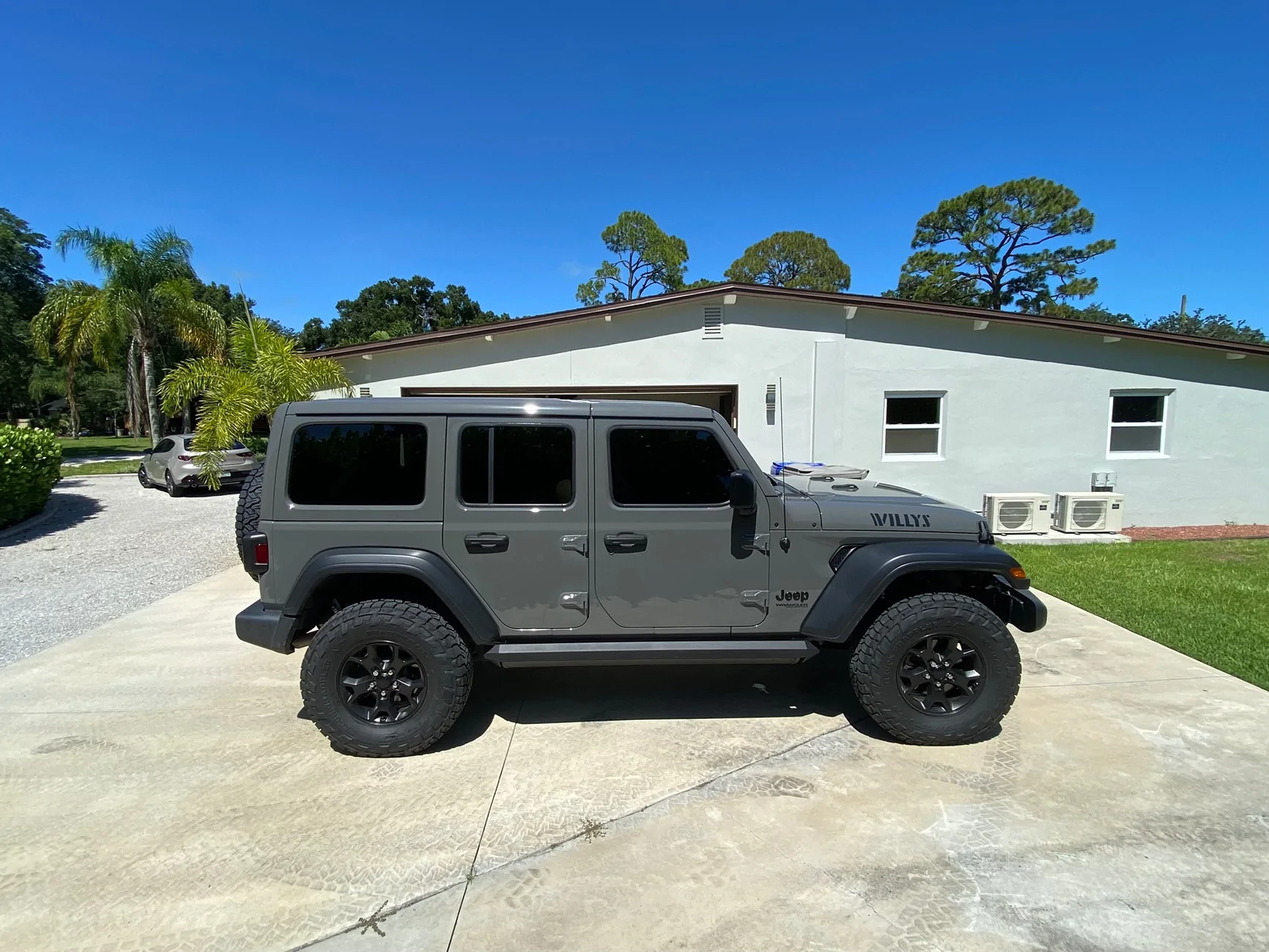

The site you liked has the OEM part number on it as 04755565AA. A quick search says that’s a Gladiator wheel. It will fit on a wrangler.
looks exactly like the Moab wheels on my 21 JLU Willys.
Jeep Wrangler JL Are these Rubicon Wheels? IMG_1739

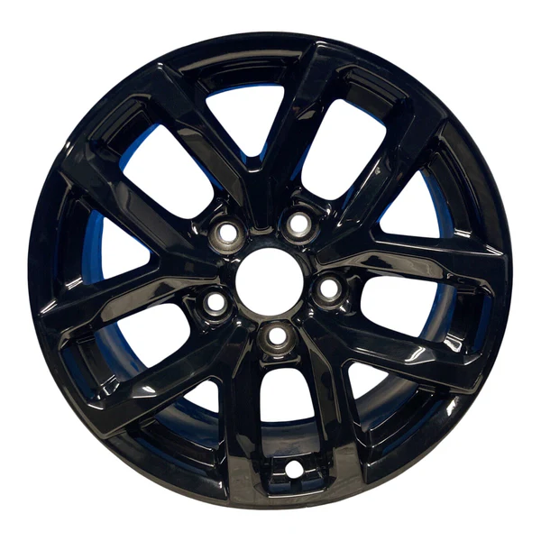

Just to close the loop here. I ended up going with Gladiator wheels. Got five of them for $200 off Facebook marketplace. I couldn't be happier. I'll be getting them powder coated gloss black to put them back to new!
Jeep Wrangler JL Are these Rubicon Wheels? Jeep Wheel
